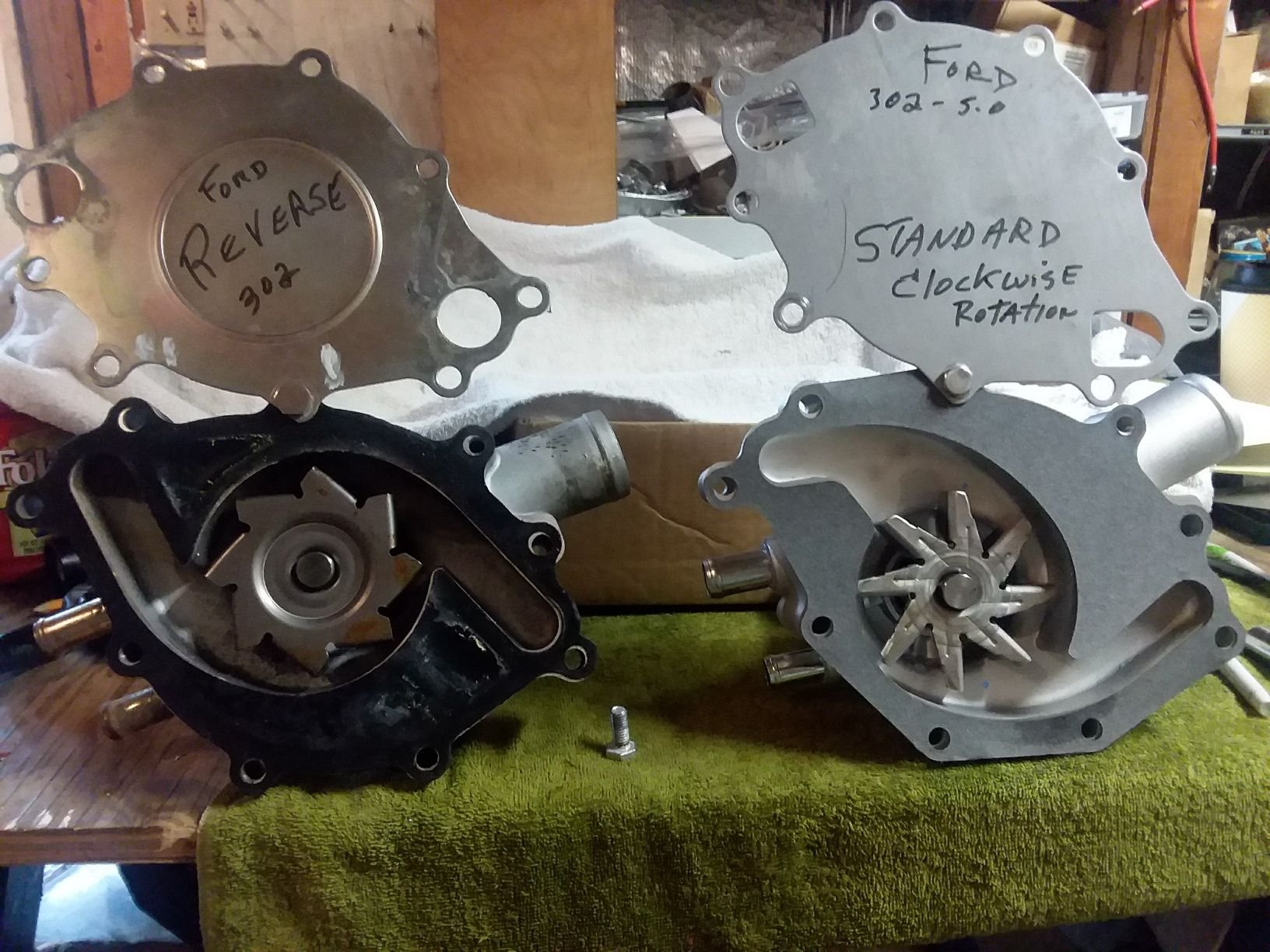

Post pictures of your Fan- shroud set-up-- fan goes on at only 185 should not temp down fast-- type fan ? ? ? ?
Do you have correct ROTATION water pump

I have correct rotation water pump. I switched it to serpentine belt when I installed radiator. But this has been pretty much same issue since truck was built with standard rotation water pump and griffin aluminum radiator with electric fan and shroud. I replaced with cold case because griffin developed a leak. Running down road it is running at 185-190 for most part and will climb some when in a pull.

When it is idling and the fan goes on put a sheet of newspaper in front of grill should want to pull iit thru the grill if is a strong fan-- get your seals top and bottom installed---
I had a problem on one of my builds keep moving with fan temp went down some-- at Idle and stop it went up at a steady pace--- I took water pump off they sent me the WRONG pump had to grt them to send me STANDAR rotation pump and worked great---

Yeah when I switched it from my other belt set up to this serpentine set up I did all my research on which pump to get and all of that. I have checked the pull through the radiator with fan on. It will hold a rag on the radiator. Thanks for the help and info.
