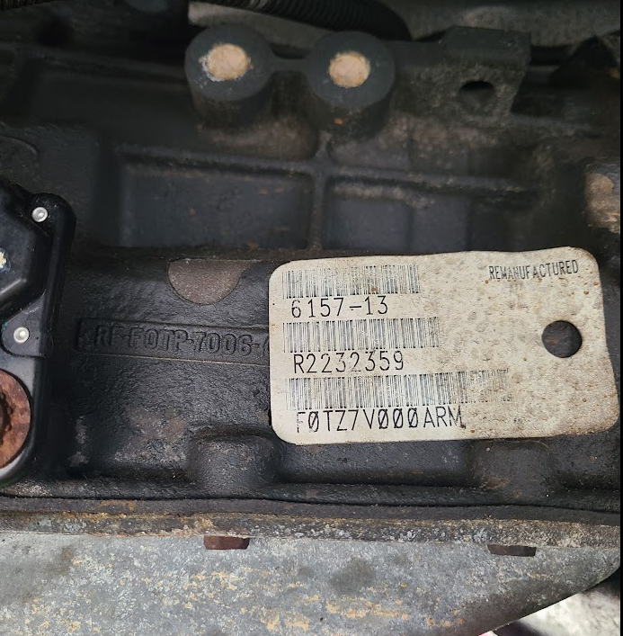

Can someone (Mark?) share some information about this transmission?

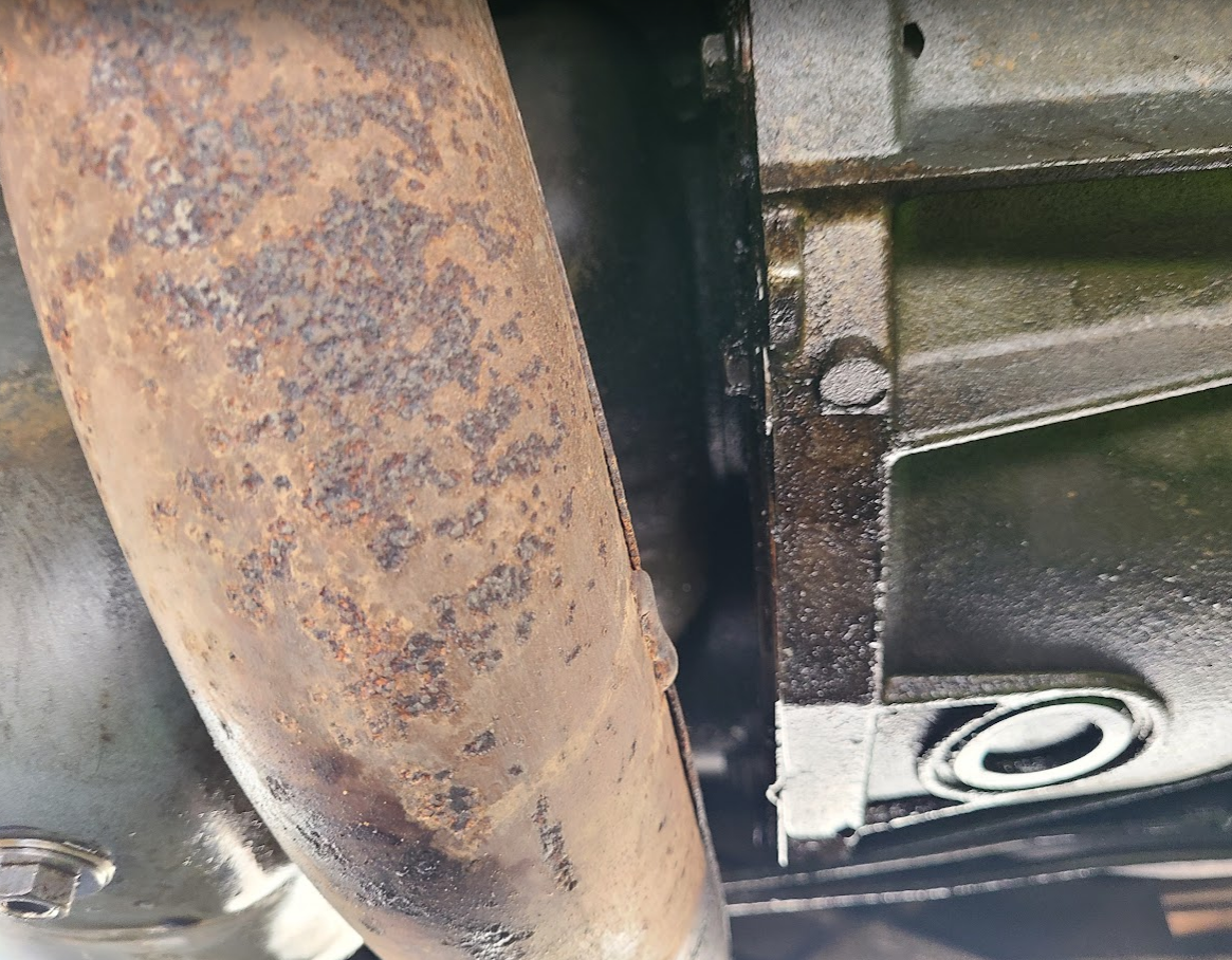

I've got a pretty good leak between motor and trans....
Does ATF feel like oil after its worn a bit?
I'm actually afraid its the rear main seal. I did an oil change yesterday and it feels kinda like fresh oil. I'm seeing a pretty big spot after sitting overnight:

ATF has distinct smell and color. What does your nose say? Let some wick onto white tissue paper. What color is it?

My guess is that it is an automatic. That one has been remanufactured. That's all I can tell from what you've shared.
What does the door tag say? There is a TR on the tag in the driver's door opening. Under the TR is a letter. That letter identifies what transmission is in the truck.
