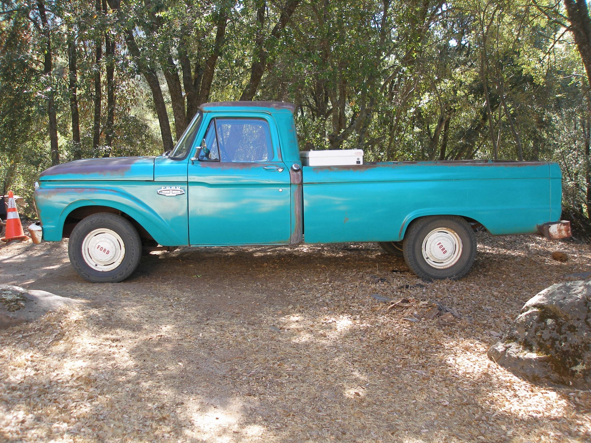

Great looking truck you got there Liddy! I wouldn't change a thing, maybe 245/75's, I went with 265/70/15's on my 66 just because I like a fat tire in the wheel well, glad to hear you're getting 22, I get about 18 running down the hill to Fresburg n back, but it's a little more "hilly" here. For me, swapping from 3.00's to 3.50's in the rear end brought my power and mileage up, so you don't want to get to far out of the rpm range for the 6.
I think these were 235/75
