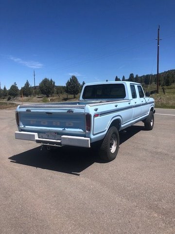

Here is my take:
Value depends. If you guys noticed recently, a '79 F350 Crew cab mounted on a '04 Dodge cummins chassis just sold at the Indy Meccum auction for $220k. The pickup outsold all Camaro's and Vette's by and easy $100k. _ _ _ Go figure.
The value of my '77 Crew just rose significantly.
Now, If I sold it for $60k, what piece of nostalgia could I replace it with for $60k ?
New pickups decked out are priced currently at $65k and UP. _ _ _ my conclusion is simple. _ _ Keep it and Enjoy !
A nice F350 Supercab should have good value, BUTT, a Supercab is a Supercab and doesn't have 4-doors for convenience.
I'm running what is mentioned above: 300 inline mini-cummins-gasser Clifford equipped, w/ universal Holley 650 4-bbl, NP435 4-speed trans with a married NP205 from a '73 F100, a '79 Dana king pin 60 up front and D60 rear both with 4:10 gearing. When I'm towing, I wind the ca-jeebies out of this engine, and it hasn't failed in 20-some years yet.
Here is what the above resides in: a '77 F250 crew cab, and '78 long bed box mounted on a '77 F350 longbed 2wd chassis.
I converted the 2wd chassis to 4x4 using '76 F250 highboy front springs and perches. This build was done 1996-1998, pre-internet.
Note for you guys wanting to convert a 2wd chassis to 4x:
The 2x frames happen to be factory punched to accept the '75 / '76 F250 4x front spring hanger / crossmember !
I have never found this fact noted anywhere, but I discovered it by mistake and LUCK, by doing it. F-ing nice conversion solution.
Note again, the frame channels or rails changed mid-77. So earlier 2wd frames have the factory hole punching.
Check it out sometime, and you will be very Pleasantly Surprised.
Happy Trails.
See below the results of my efforts:
i'm running LT255-75-16 Toyo a/t tires, and not too wide.
Original color blue main color. originally, my pickup had the puke-blue inside the race-trac trim. I hated it.
So, I just repainted the whole pickup the light "baby" blue, which I like big time.
