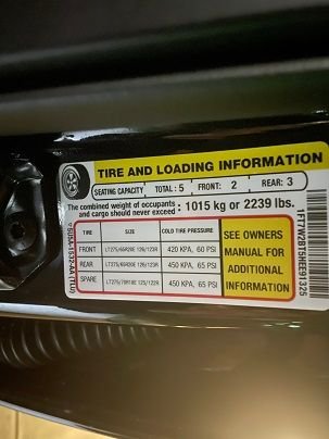

I have a 2017 F250-6.7 L turbo diesel-Crew Cab- short bed.
My question: On the inside of my door there is a yellow & white sticker that says my max Occupants & cargo weight should not exceed 2239 lbs, but underneath that there is a White sticker that says my GVWR is 10,000 lbs
If I calculate the numbers on the white sticker (10,000 GVWR) - (6750 curb weight) my max Occupants & cargo weight should be 3250 lbs
Which is correct ?

Officially your payload is 2239 lbs. This is a registration limitation placed on F250’s. The problem usually comes up with F250 Diesels as the extra 700 lbs really eats into the payload.
What the previous poster was saying is that your FAWR (Front Axle Weight Rating) and RAWR (Rear Axle Weight Rating) far exceed the GVWR (Gross Vehicle Weight Rating).
Manufacturers tell you not to exceed GVWR for safety and insurance reasons. The reasoning by many F250 owners is that the axles, springs, rims, tires, etc. are the same between the F250 and F350. Therefore it is assumed that as long as the FAWR and RAWR is not exceeded then, then they are unofficially under any safety concerns.
There are some differences between the F250 and F350, like an extra leaf spring but these can be optioned the same from the factory with certain packages. Also you can buy an F350 and have it deranged to 10,000 GVWR (F250 levels) for registration and insurance reasons.
I hope this clears up SOME confusion.

The only way to find out what your payload actually is, is to go to the scales and weigh your truck. Make sure to top off your fuel first, and then drive onto the scale. Whatever your total scaled weight is, subtract it from 10,000 lbs and that is you available payload. This is the most simple, by the book, accurate way to do it.
(And in your example above, if your scaled wight is 8000 lbs, then: 10000 - 8000 = 2000 lbs of payload remaining.)
The curb weights listed on the Ford site are the base trim (XL), with no added options. Once you go up a trim, that adds weight. Once you add an option, that adds more weight. There are too many scenarios for Ford to list then all (although, I believe that they could easily provide a calculator that adds everything up as you are adding options...) But, you cannot use the listed curb weight, you must go and weigh your own truck. Supposedly, as the truck is leaving the plant, they run it over scales, grab a weight and then subtract that from the GVWR and then print the remainder on the yellow "payload" sticker, but even if that number is accurate, the moment you start adding anything to the truck (phone chargers, seat covers, tool boxes, tonneau covers, anything...) that immediately starts reducing the available payload that you have remaining. This is why I would suggest loading all your normal stuff in the truck, fill it up, and then weigh it. Be honest... Then subtract that number from 10,000 and you will have your remaining payload.

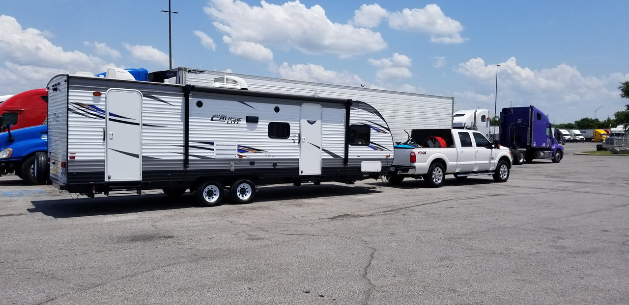

In the image below my F250 Lariat 6.7l is 200lbs over the yellow payload sticker on my door pillar. Does it look unsafe? Not in the least bit, that is a half ton towable trailer, it handled that load just fine and I could drive that rig with 2 fingers at 75mph. My truck is registered at 15k lbs because that's what the uninformed lady's at the tag office thought it should be registered at. I didn't argue because there is very little difference in the cost of registrations in my state.
Like others have said take your truck to the CAT scale with a full tank of fuel and get the actual weight (I expect you will be close to 8200 lbs like my truck is). Then add the pin weight of the trailer you intend to tow and make sure you are under all axle, tire, registered weight and GCWR and you will be just fine from a legal stand point.
