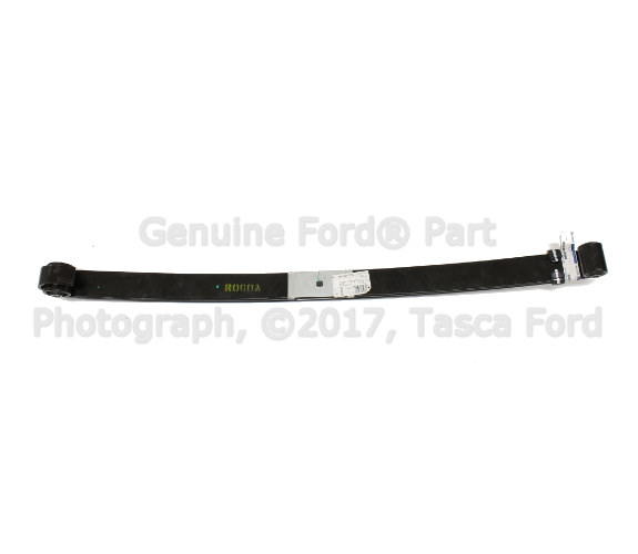

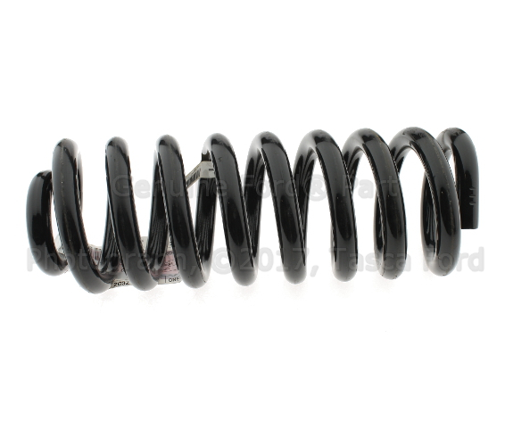

As an example, let's say one was looking for a front spring for a Super Duty. And in this example, let's say we've moved beyond scrutinizing the physical parts for any identification stampings, and are now just accepting on faith whatever our Ford parts counter person says, and without us providing them the VIN, they guess that we need Ford part number 2C3Z-5310-HA to replace our front spring. Note the "5310" in this part number....that's the basic part number. We even saw it on the spring itself.
Sounds good, we say yes, they order the part, and this is what shows up in the FedEx truck:
Sadly, this isn't what we needed at all. Yes, part number stamped or painted on the spring itself matches what we ordered. It is a "5310", and in fact, the prefix matches exactly too. 2C3Z-5310-HA
But we need a front spring that looks like this:
Both have a basic part identifier of "5310". That means front leaf spring. And these are both front leaf springs. Both fit for a Super Duty. Both with a prefix of 2C3Z. But obviously, these are very different springs.
The coil spring part number is 2C3Z-5310-VA. The leaf spring part number is 2C3Z-5310-HA.
