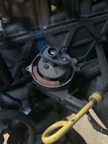

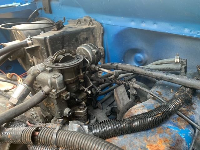

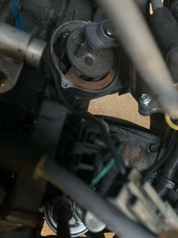

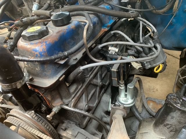

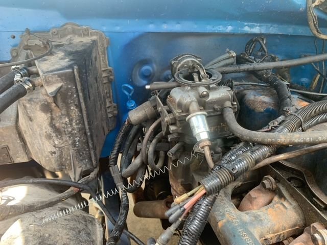

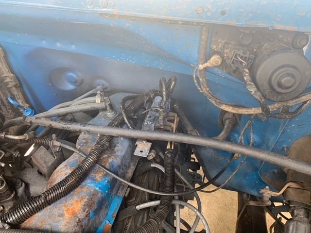

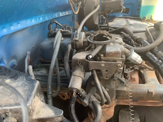

I appreciate the help. Here are some photos of the carb and inside the engine. there seems to be a lot of blocked off vacuum lines. the truck still has what appears to be a map sensor as well. If it has a computer, i have no idea where it is.

Ah, learn something new every day. I thought those were still mechanically controlled timing on the feedback setups.
Yeah, if it's locked at completely base timing, that would definitely hinder performance quite a bit.
pmuller, that's the DuraSpark II ignition module, so he wouldn't have one of those on his '85 as it looks like his feedback system is complete.
The computer is inside the cab, up underneath the dash. It's roughly inline with and up above the gas pedal.
I've never diagnosed and fixed a feedback setup, as I usually pull it all out and convert to a DuraSpark II (or equivalent), so I don't know where to tell you to start.
But it does look like you're missing a vacuum cap on the carburetor (driver's side, first picture). Hard to tell since the picture is kinda small.
Also, your passenger side motor mount is missing the upper bolt. Adding that and tightening it down might help with the engine shudder.

The carb is not a feed back carb as it dose not have wires going to it other than the idle kicker.
Because of that and who knows what else the computer is in limp mode and timing locked.
Let's step back to the ruff running motor have you done a compression test on it yet.
If you have a weak or dead hole it will run ruff.
I would do that before putting any money into the truck.

Overall, what you've got there is what we call a "mess". Not that it isn't solvable. That isn't the *correct* carburetor for 1985, although it might be a perfectly servicable one that just needs to be tuned.
Your larger issue is really going to be addressing whether the ignition is timed and/or advancing correctly. It's completely common to see the "Hybrid" EEC setups, where a prior owner has made a dogs breakfast of them, due to ignorance, laziness, or just not being able to find proper diagnostic procedures (And I'll be honest, while it worked, this wasn't the greatest setup in the history of automobiles, and I'd probably remove it, if I had one).
One of the easiest things to check? Pop the distributor cap off, grab the rotor, and can you move the rotor at all? If you can't move it, that means there's no mechanical advance mechanism in the distributor. If there isn't, *I* would personally recommend switching to the earlier Duraspark II, or even an aftermarket setup, like you can get from DUI.
Basically, your carburetor and other stuff is probably fine, but the ignition setup isn't working, because I'm going to bet good money if the ECM is still there, there's been some hackery done to the wiring harness, in conjunction with removing the original carburetor.
