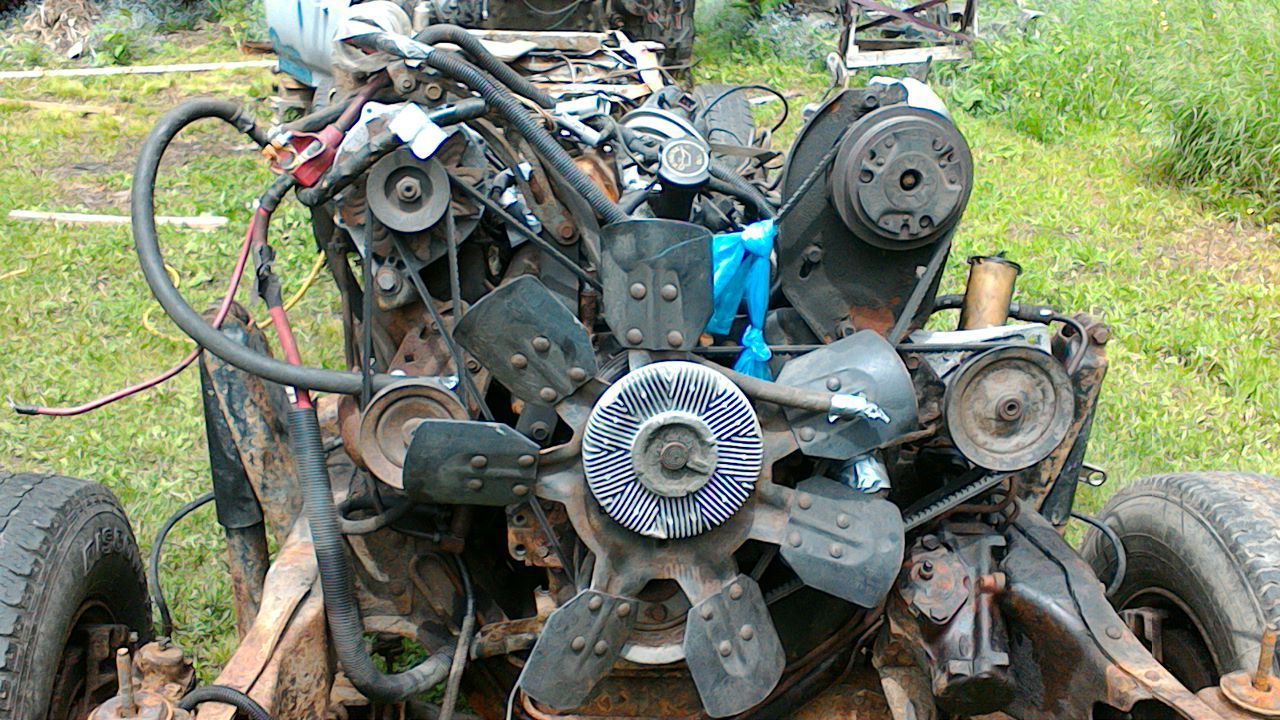

Could anyone send in some photos of there power steering and ac compressor area. I have the shop manual but I'm still confused on how it all goes back together. Any photos would be appreciated.

Mine is gone, but I do have this pic.
