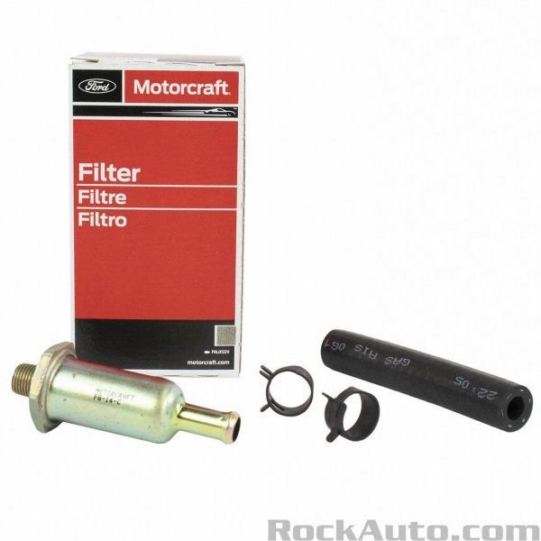

You call it a "screen". Motorcraft has an 8 micron filter (FG14 C) which looks like it "might" be correct for your application.
FG14C
I agree that it would be best to have one just before the carburetor, though many pumps have their own filter.

Thanks gents. I hadn't thought about the fuel pump crapping out and pumping junk into the carb. Great point. I had planned on an inline filter before the pump because I've heard of people damaging their pumps with grit in their fuel (though the screen on the sender should prevent that I'd think).
I'm going to give that last one a shot (thanks for the image). If that doesn't work...I'll put the old one in per your suggestions and add an inline filter before the pump.
