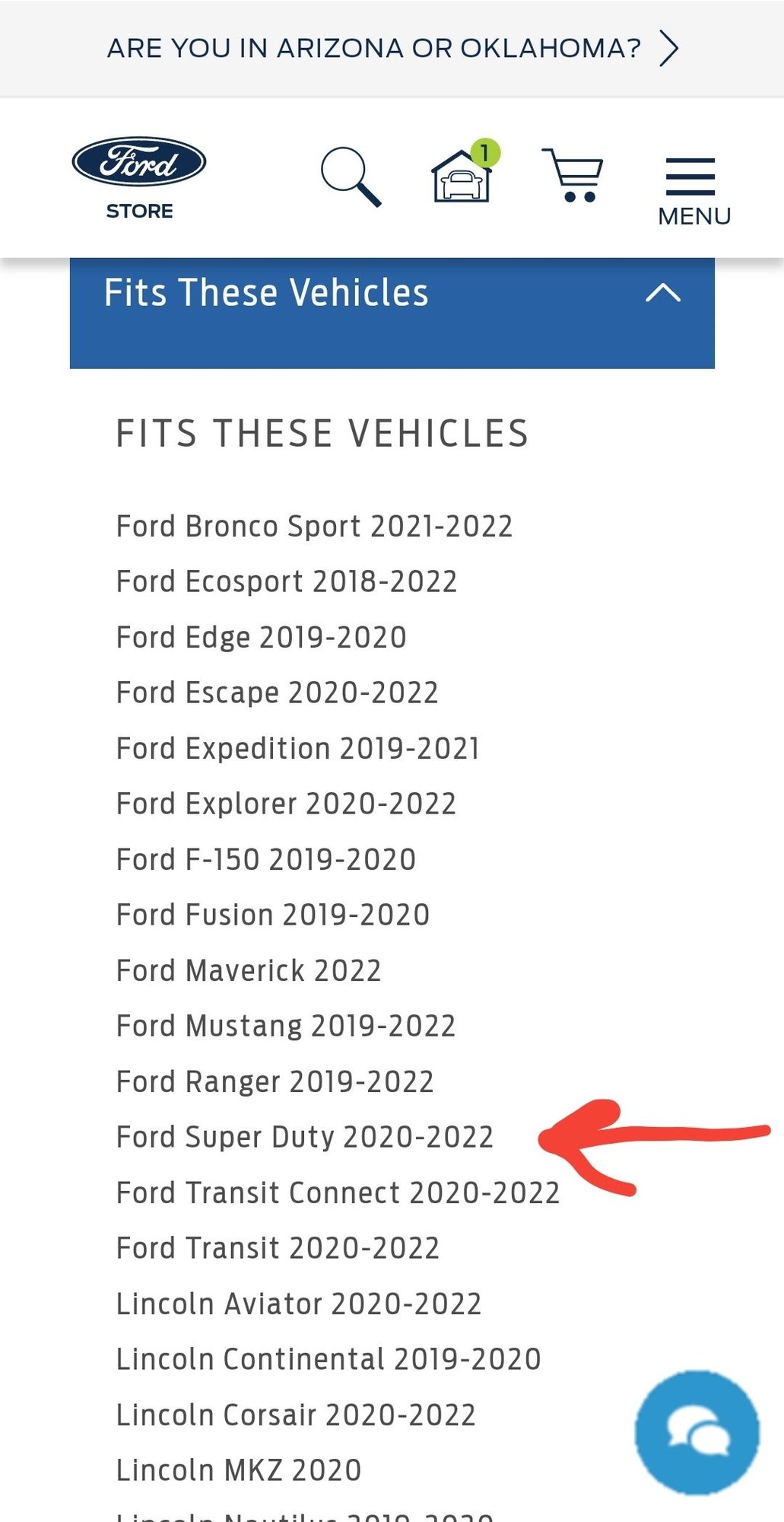

Old Jun 1, 2022 | 04:13 PM
4wd6.7L's Avatar
4wd6.7L
Joined: Dec 2020
Posts: 8,640
Likes: 2,433
Originally Posted by smikesF350
Thanks for this info. Been googling around on it and so far it does not seem to be available for Super Duty trucks.
You might want to search around on these forums. There are owners that have used it on their Super Duty's. Here is one thread discussing it- https://www.ford-trucks.com/forums/1...l#post20300029
The part I linked to......
