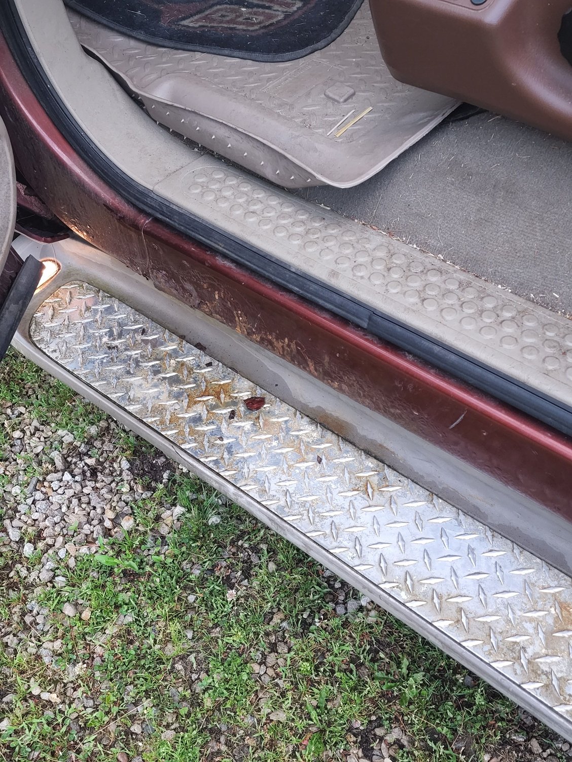

Behind passenger rear door.

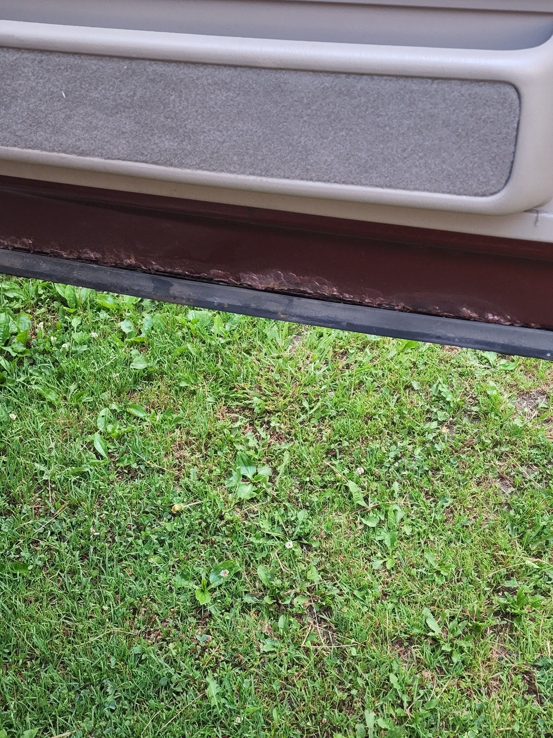

Under the rear passenger side sest.

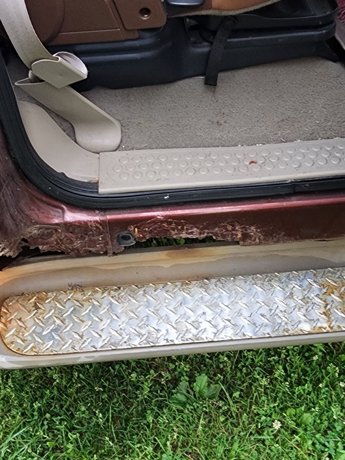

Bottom of rear passenger side door.

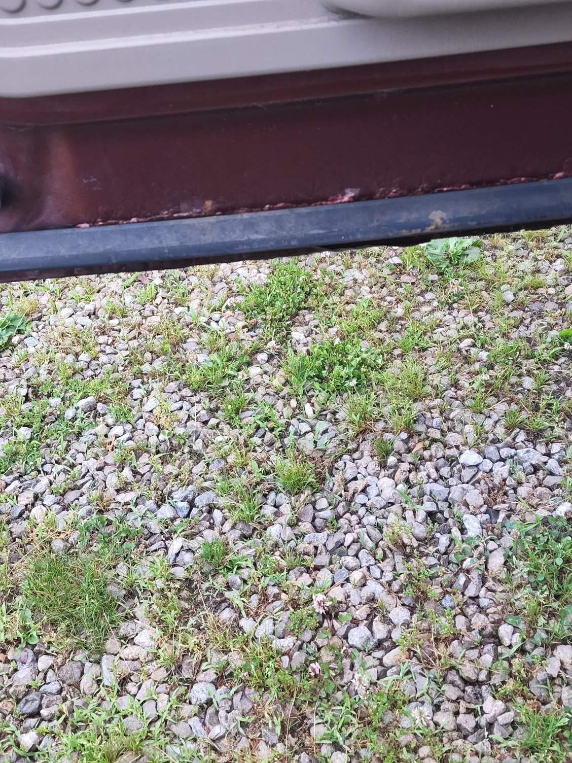

Passenger side door.

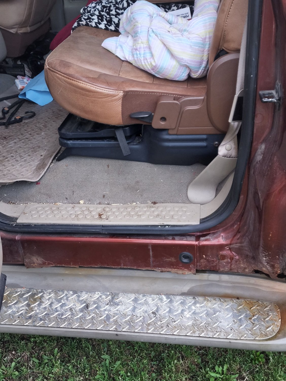

Under rear driver side door.

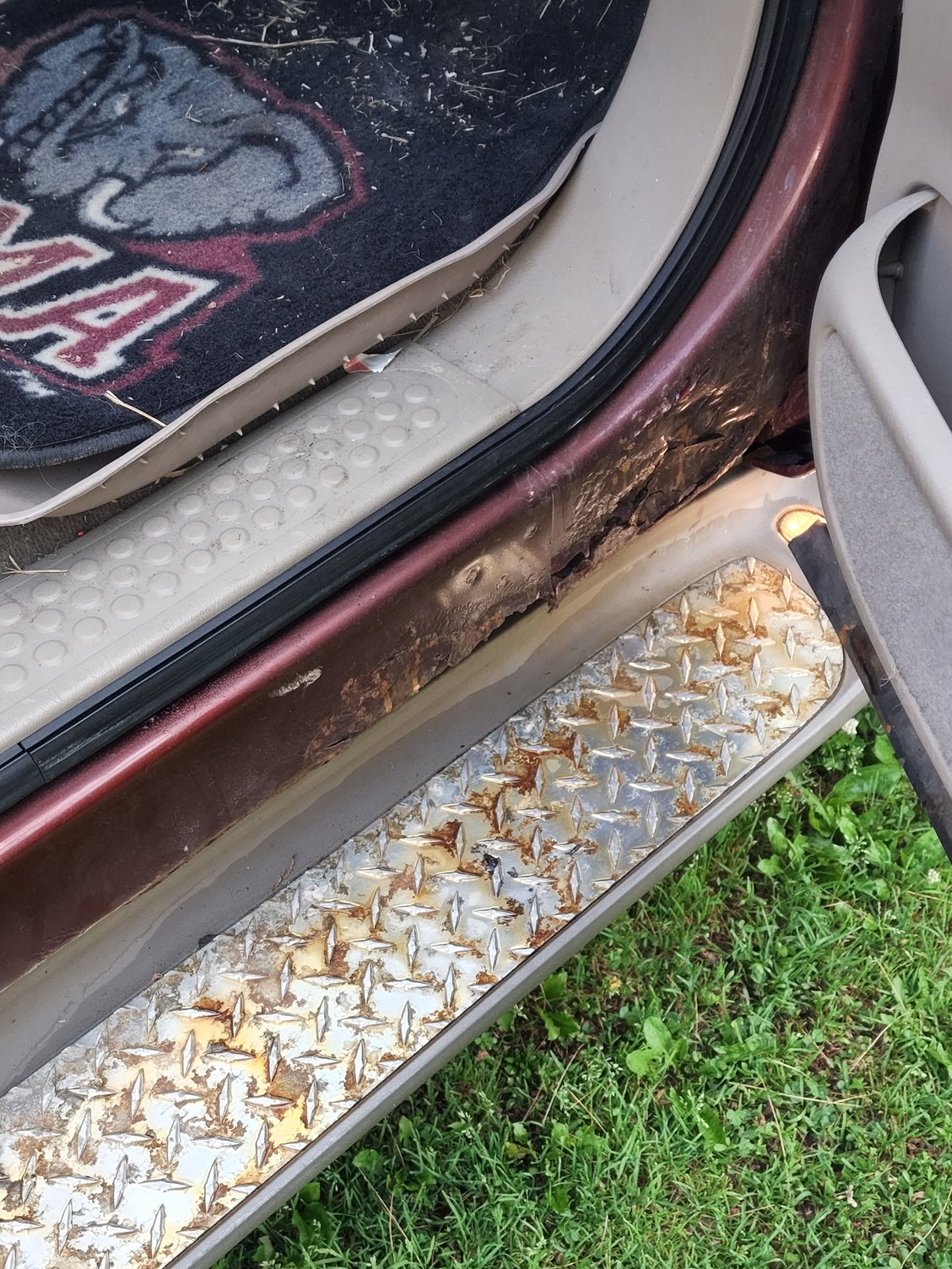

Side of rear driver side door.

I removed my runnin boards and removed all loose material. Then a needle scaler and/or die grinder brush (good dust mask, safety glasses etc.) to clean rust area and a few inches beyond. Did inside and outside (everywhere I could) Coated everywhere with EvapoRust and let dry overnight, primed metal everwhere with Rustoleum Professional Rusty Metal Primer after it dried overnight. Next day I used fiberglass mat and resin to start repairs. Get 1 inch disposable brushes and place resin on metal first and press dry mat into it. Keep adding resin until full saturated and you can fold together or whatever to make what you need (lip for running board bolt clips, etc). On the cab corners or any holes u will have to just resin the edges of the "holes" and attach the edges of a dry mat strip, let em dry then add resin to center, let that dry and u have a foundation to work from. Work the strips different ways to the corners shape. Sometimes u will have to just add a strip, let dry, then build on that. You will have to dab alot to fully saturate the mat and it will flatten/mold out nicely for u. Make sure u use the mat, not the cloth. Practice in a hidden area or on a piece of scrap and make sure u "build" from good metal inward. When I was done I painted area with another coat of rusty metal primer and two coats of protective enamel.

Most body shops should be willing to cut the rockers and cab corners out and replace them. Depending on the rates around your area, I'd say you're looking between $2500 and $3500 in rocker and cab corner replacement. My 2003 F350 SC is worse than yours and I was quoted $$2500, from a guy in Wisconsin, which was cheaper than the Chicago area, but one thing they all had in common was that they didn't want to mess with the doors. They say it'll be cheaper to find doors with no rust and have them painted than to try to repair them.

Fiberglass is a temporary, hack, repair and might last a few years before it starts to separate from the base metal. I'd only do it to something i was trying to get a couple more years out of before i had to junk it.
I suggest you do some digging and look inside the doors and inside the door pillars on the cab. You might have to drill some access holes to do this. The way that rust is forming it looks like it started rusting on the inside and worked it's way out. If that's the case, 1i'd say that cab isn't worth saving, probably be better to do a cab swap. If you could find a good cab, you could probably find a shop that would swap it for you easier than doing the rust repair.
