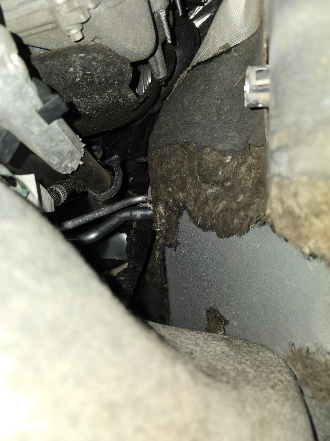

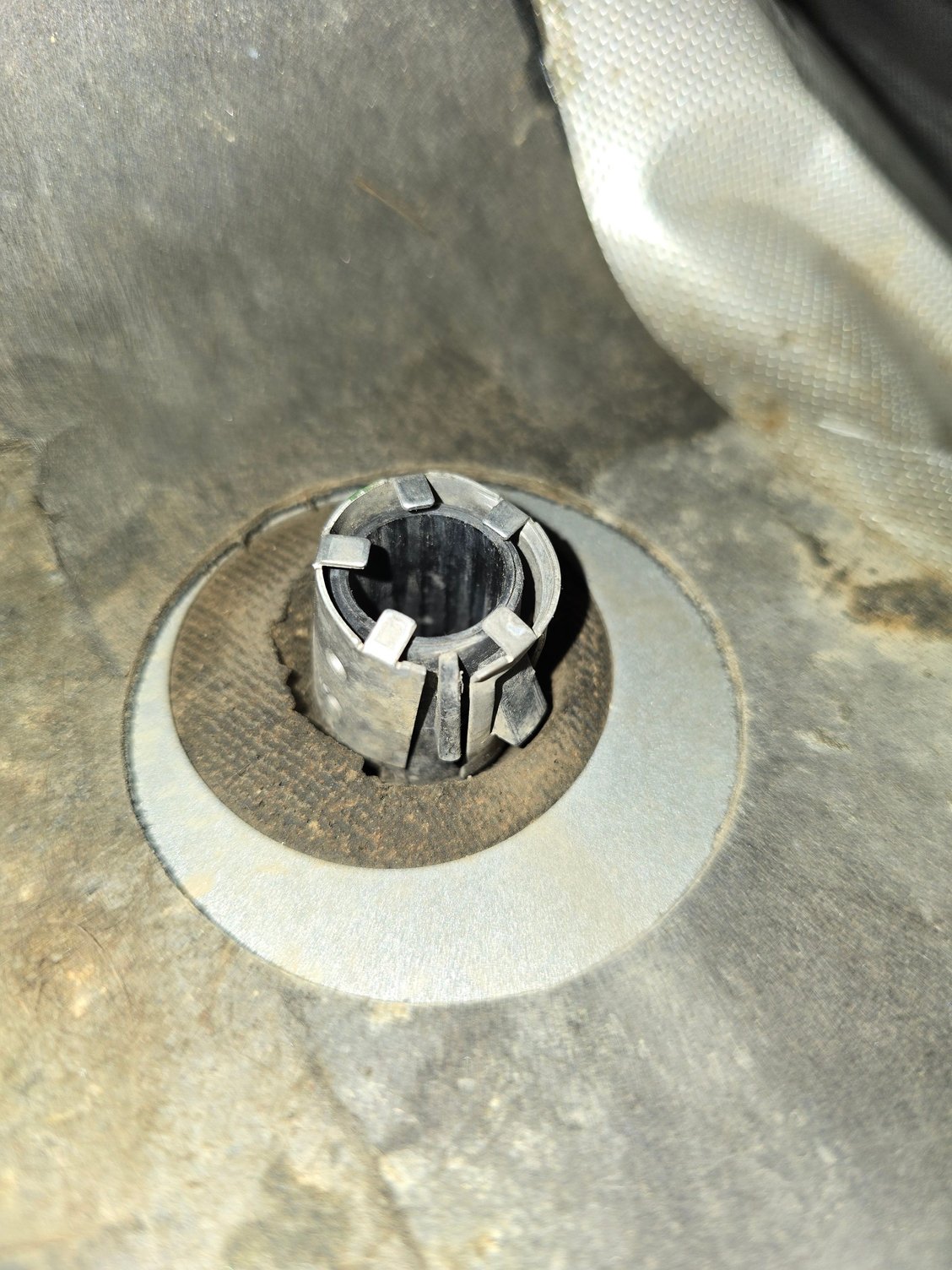

Find the evaporator drain port
Purchase a evap cleaning kit
Insert tube into port & release can contents
Wait 15 minutes & let drain
Turn on truck ac fan on low for 5 minutes
That should help clean the coil
