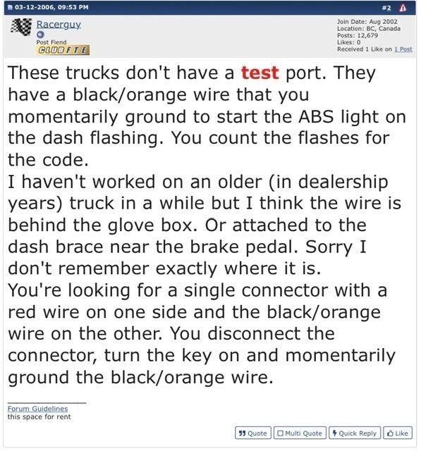

The ABS is not tied into the engine computer. Did you try to pull the codes from the ECM/PCM connector or the RABS connector?
Yes, you can bypass the system. I don’t know how or why the brakes were engaged while you are pushing another truck so I’m not sure how deleting the system would make a difference.

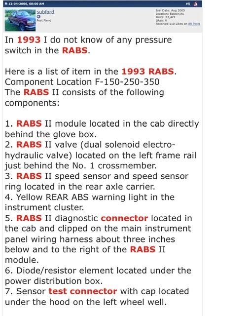

No. The Hydraulic Control Unit is on the frame rail. I was saying I didn’t know where the test connector is located so I did a thread search

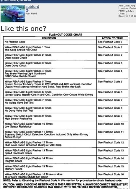

After more searching on here…
Wow thank you so much!! That would have taken me forever to find! You have been a big help. If I understand what you said earlier (if I decide to do so). I can delete the rabs system but must leave the sensor in the rear end? So I could delete the part in the frame and the module and as long as the sensor in the rear end is there, won't have any adverse affects on the transmission/speedo and just throw the abs light on? Thanks again for the time you have taken!
