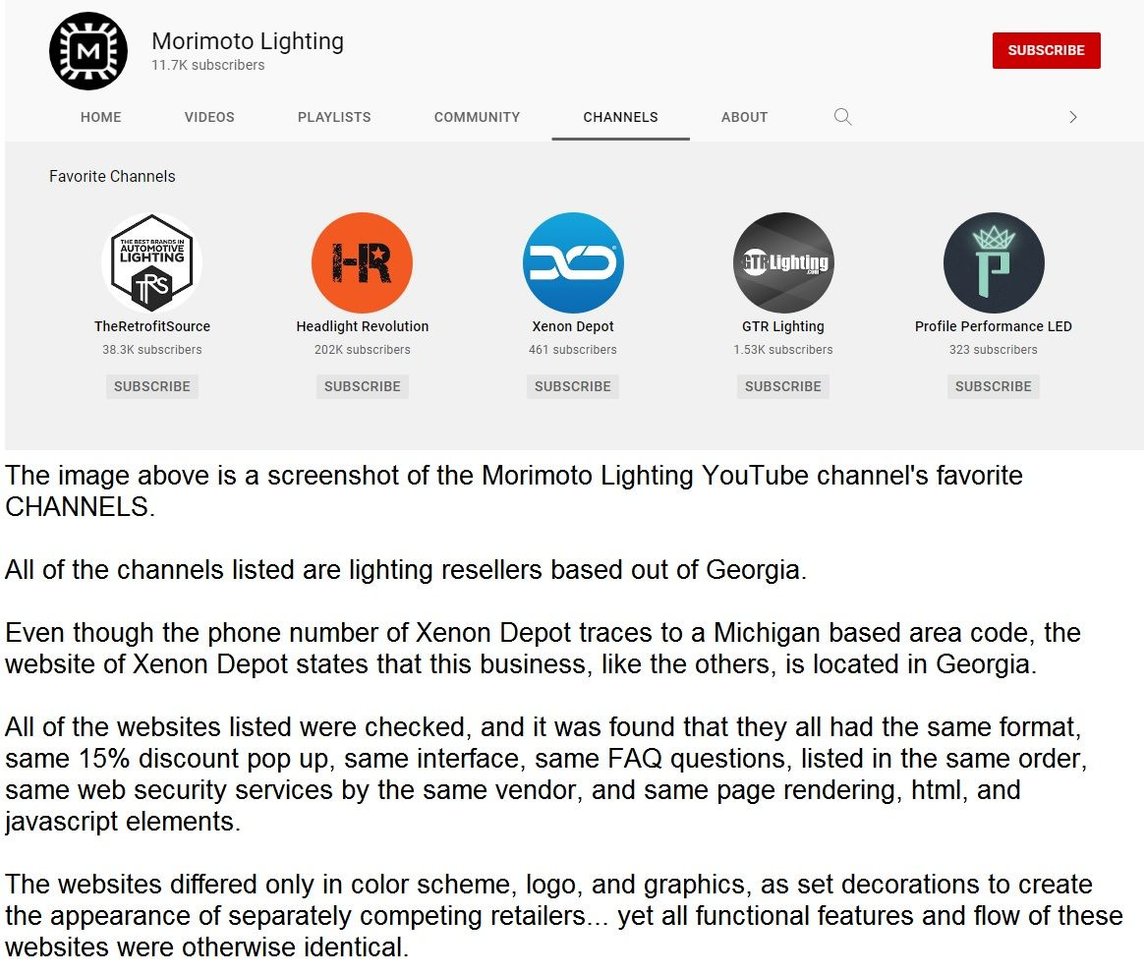

Originally Posted by KHNewman
DO NOT expect any help from Morimoto or Headlight Revolution. I purchased the headlights from Headlight Revolution and based on the customer service phone tree menu
Morimoto and Headlight Revolution appear to be the same company.
ALL of the following aftermarket automotive headlight vendors identified by the brands and icons shown in the screen shot below... are the same company.
