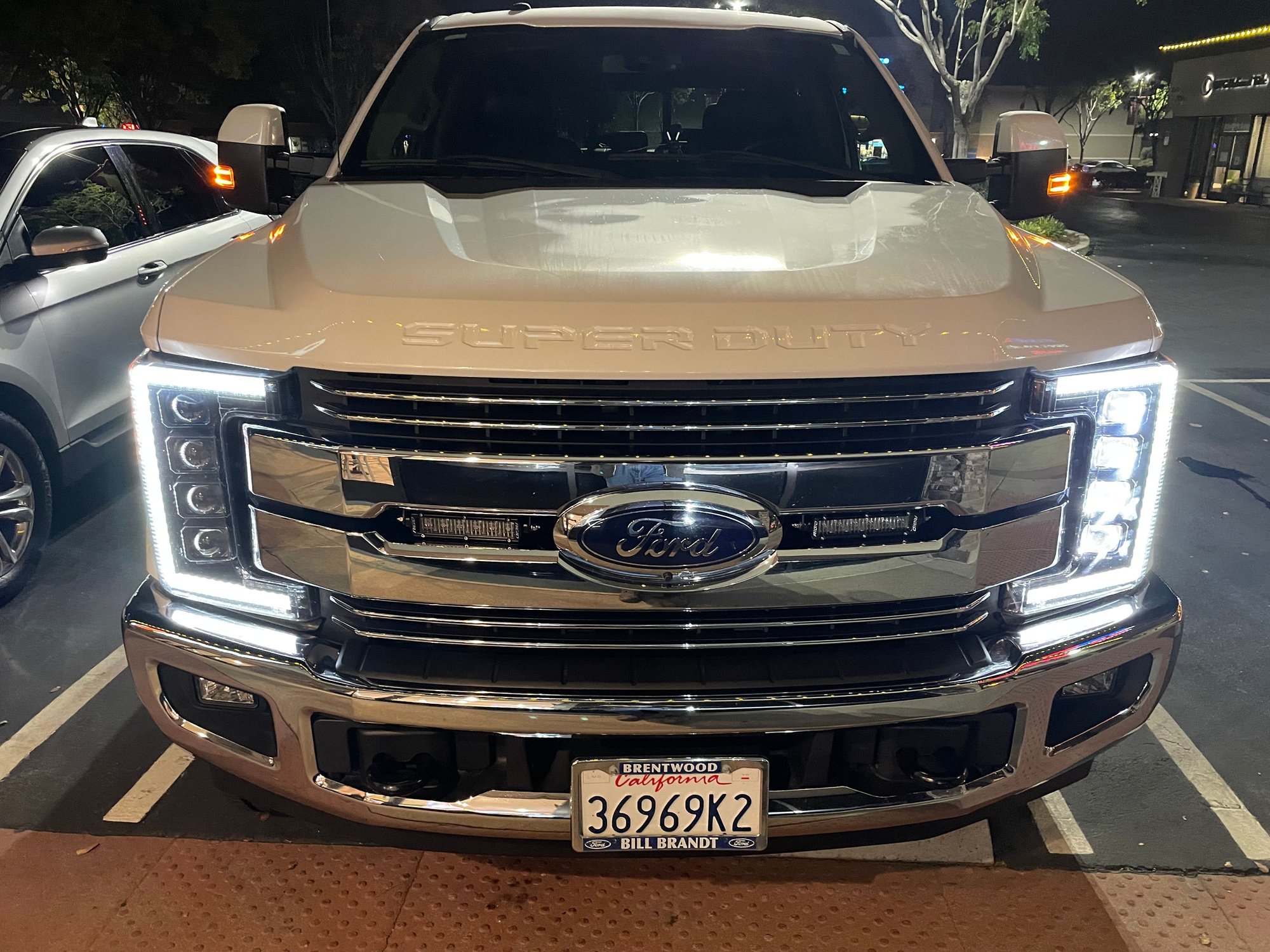

I installed the Morimoto's about a year ago. 2 months ago the right side did the same as yours.
Headlight Revolution sent me a new harness. This worked for a month and thenthe right light started going intermittently on and off. Also the lens housing started to vibrate.

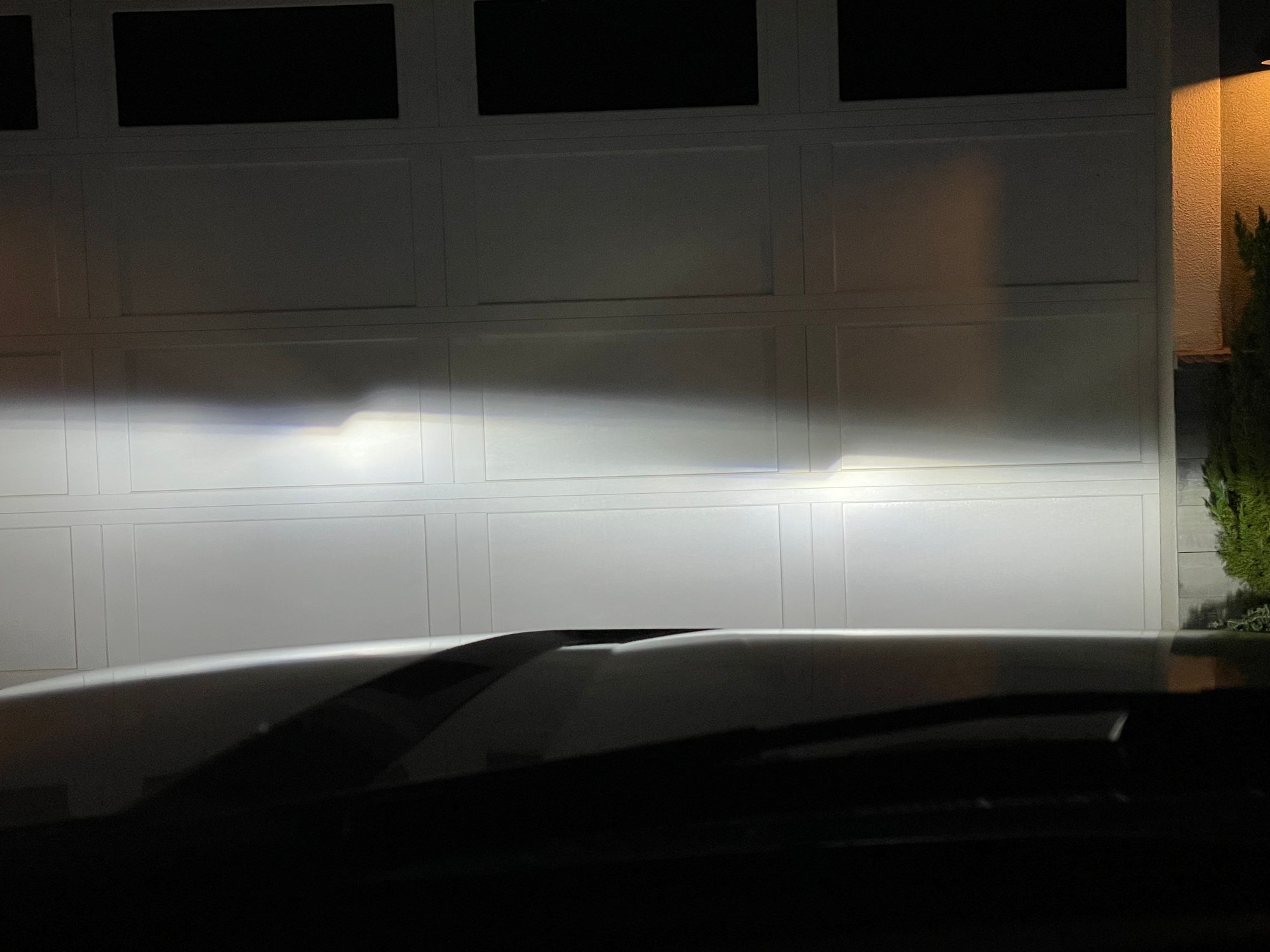

Sent videos to HR. They had me pay a deposit and sent me out a replacement set. I installed them today.
They are worse then the originals. Alignment is terrible. The first set were spot on right out of the box. Also left light correctly cycles thru the cycle sequence, the right one does not.

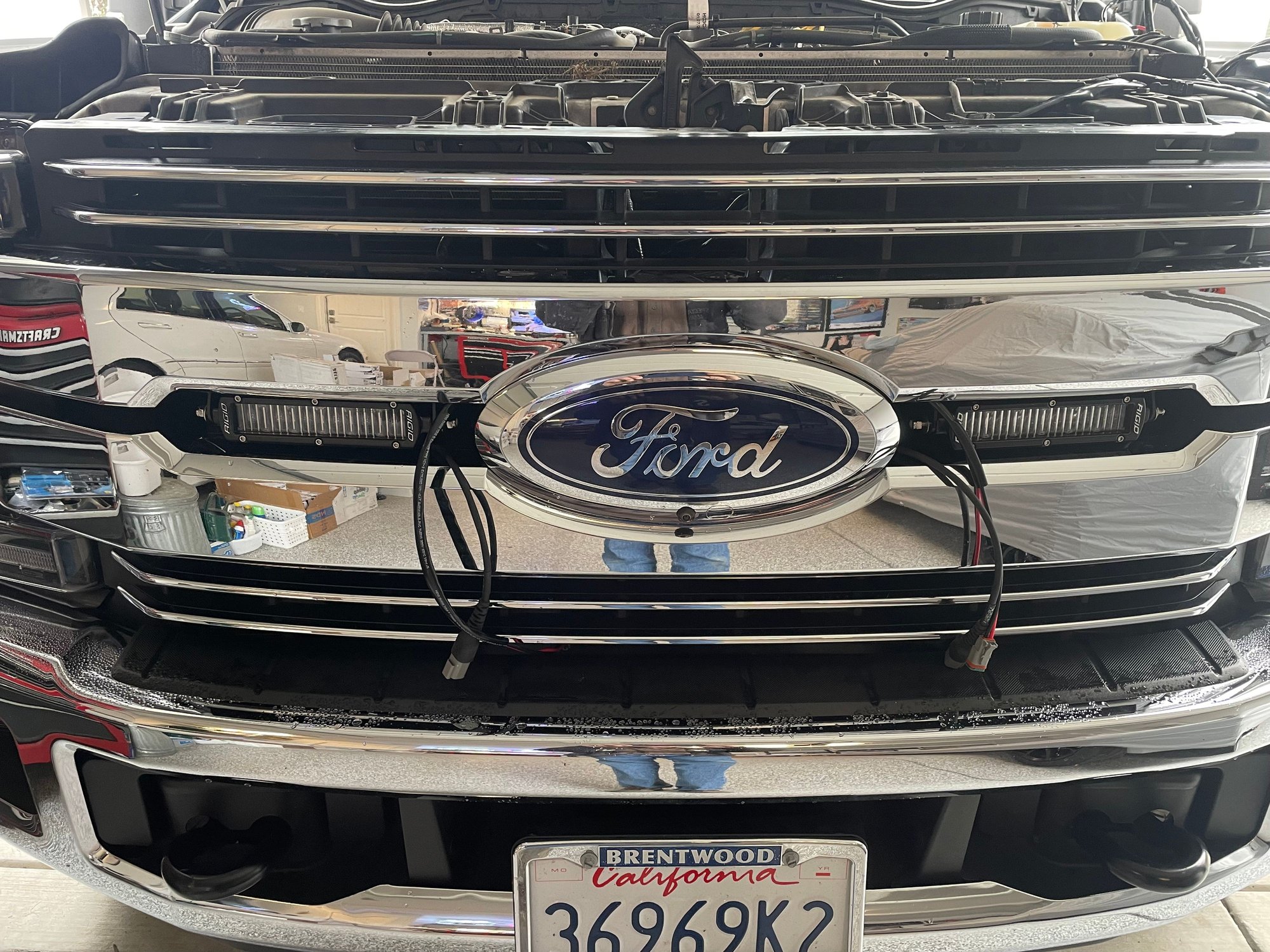

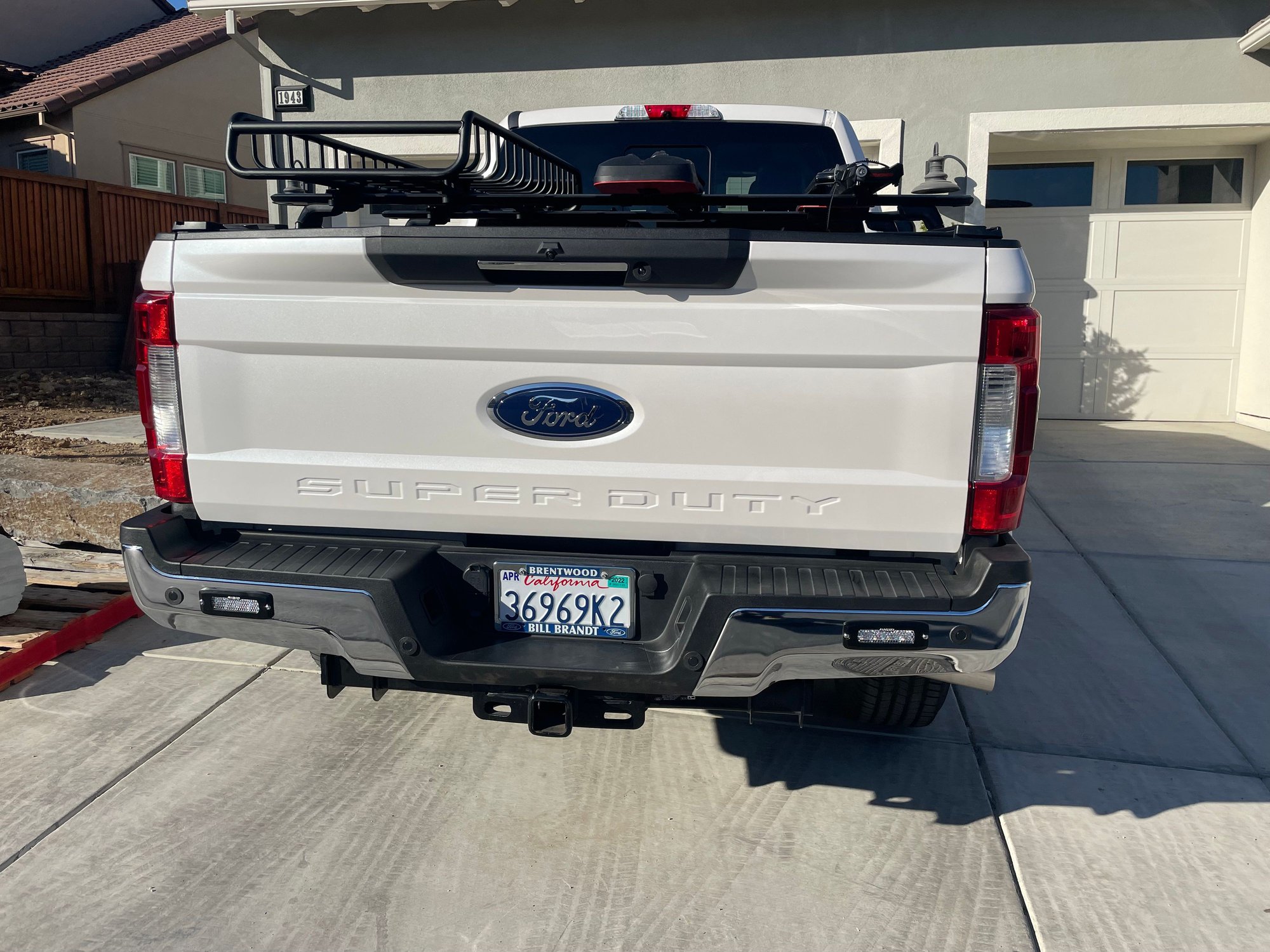

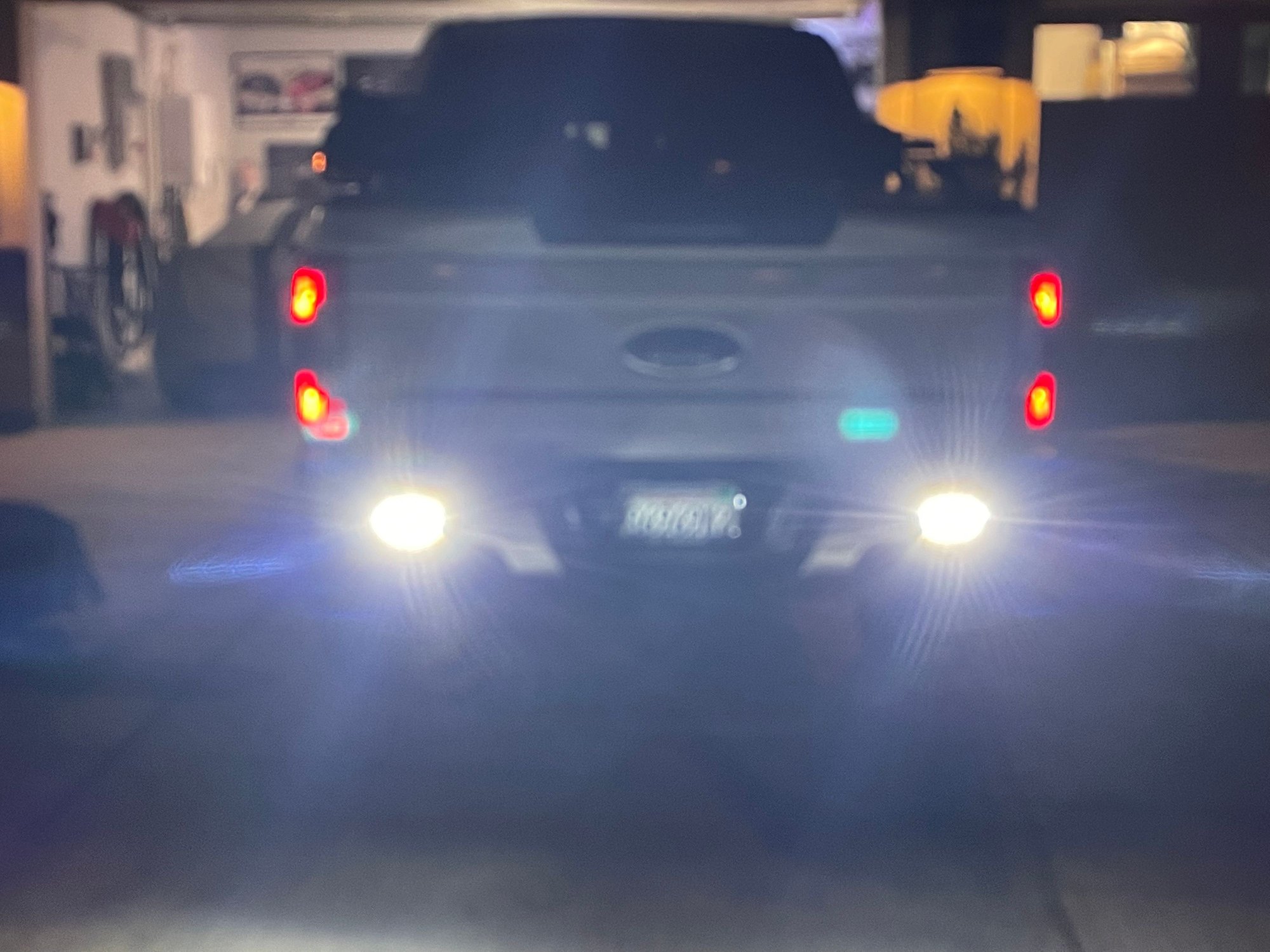

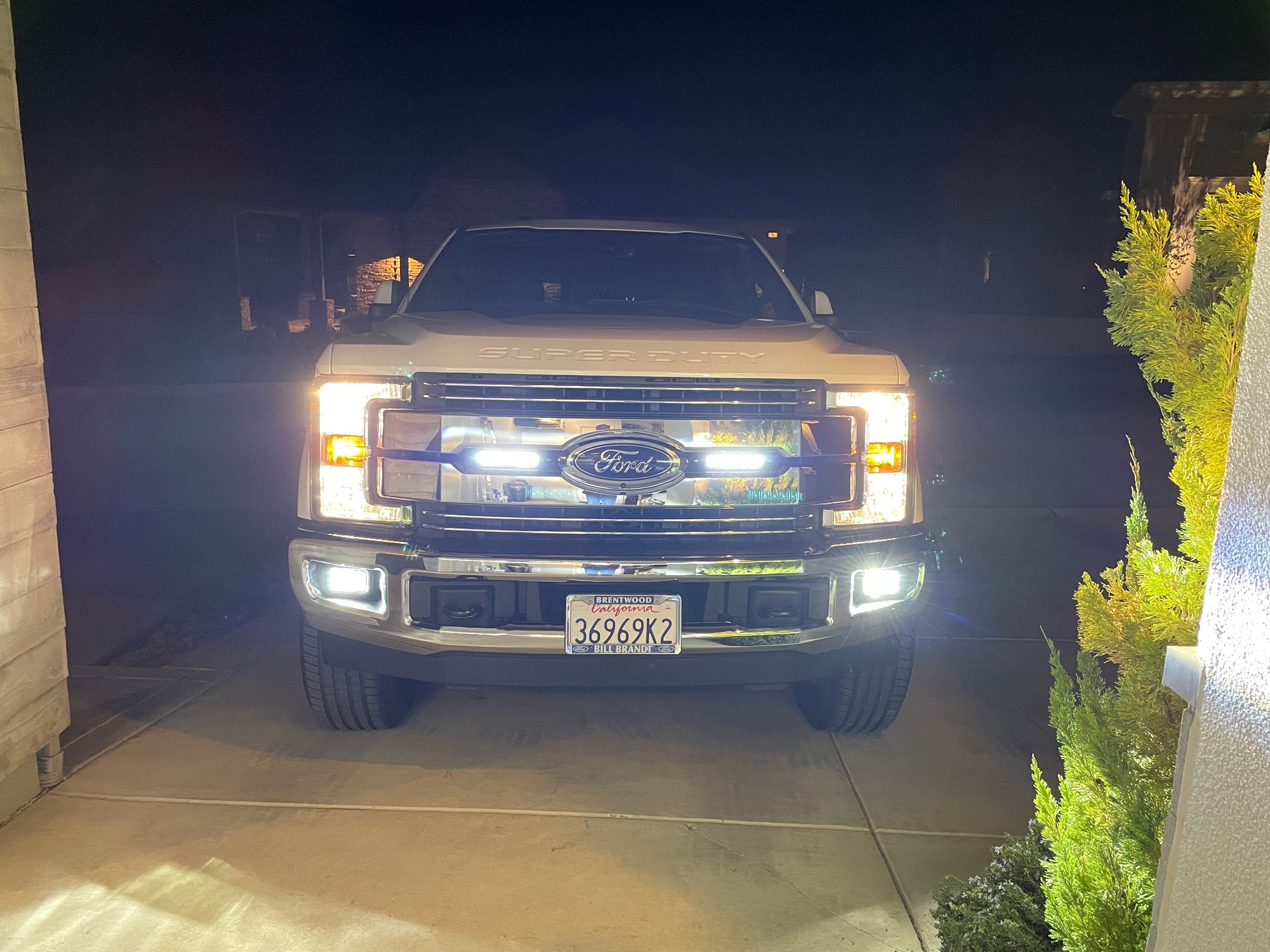

I did install Rigid Grill Mounted lights which can fill in, in a pinch. Also installed Rigid rear lights for increased light to the rear.

Failed right light
Replacement lights - alignment is way off out of the box.
Rigid grill fog kit
Rigid flush mount rear light kit
Rigid rears at night

The Rigid lights in the center grille and the LED fogs give me plenty of light. Sylvania Ultras installed in the factory headlights.
