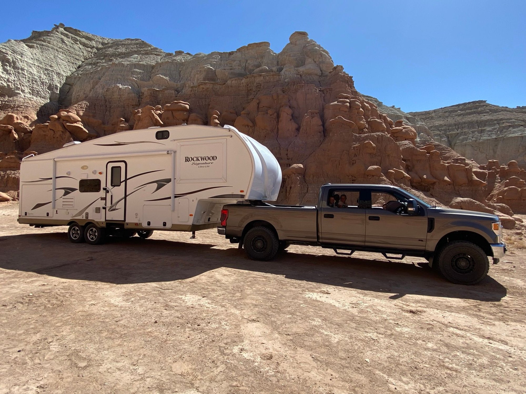

MAX4utah's Avatar
MAX4utah
Joined: Jul 2021
Posts: 424
Likes: 201
I put airbags to stabilize the rear. I did the Carli level kit, and just the shocks in the back. It tows my 5th wheel great. If you were to add their rear leaf packs or full leaf spring lift, the towing quality will suffer for sure. The Carli leveling kit will tow just fine.
