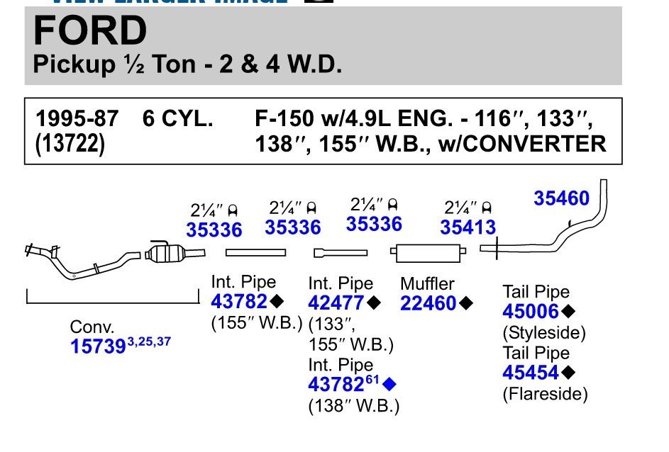

Was looking at this exhaust from Walker for 133" WB.
if you get that it may need the air.. but if you dont need a cat or you dont have testing, get a universal if it will fit so you dont gotta bother

^^^ what AuroraGirl said. The above pictured catalytic converter is for an air injection system. If you delete air injection, get a universal converter. On my build I went with a universal magna flow, was about $100.
If you are dead set on rebuilding the thermactor/air injection system to stock, then you would need this converter.
