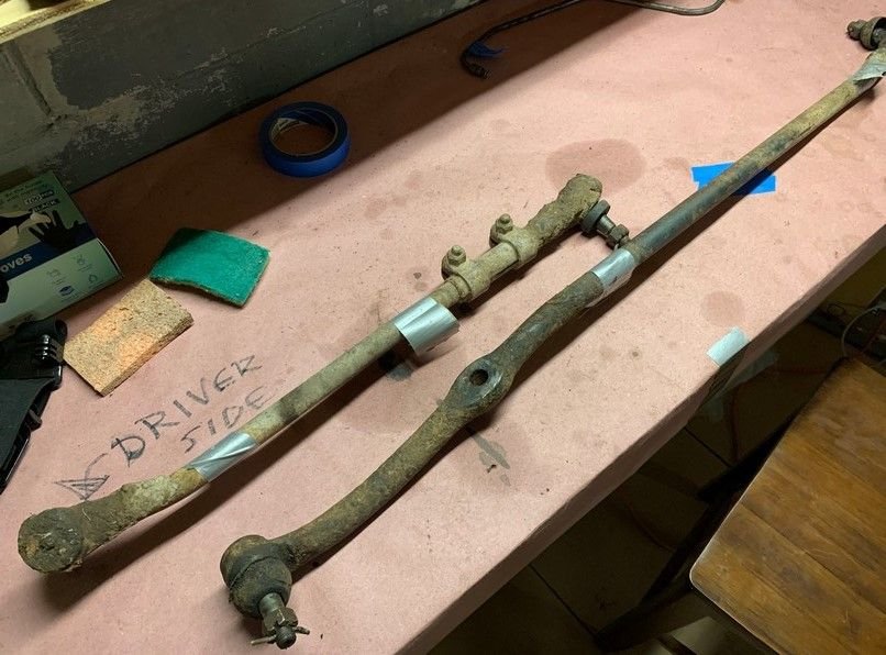

Thank you, thank you...for all the detail. Yes, it is my 73 250 with factory power steering. It seems to match what you were describing. Pic below.

On a RWD with twin I beam front.
The "right side DRAG LINK" serves two functions.
1, the drag link as it connects the pitman arm to the tie rod ...
2, part of the tie rod assembly as it controls the right front steering knuckle ...
The left side steering knuckle is controlled by the "left side TIE ROD" and is called such as that is all it does.
It only serves to tie the two sides together. It does not connect to the pitman arm, it connects to the drag link.
This was done as twin I-beams swing through long arcs as they travel.

On the 4wd trucks where the tie-rod was in front of the drive axle, specifically the F250 and 350 and Super Cab F150 with leaf springs and short draglink on driver's side only, yes the tie-rod is a long rod with no hole for the draglink. It is not one-piece however because you need to be able to adjust the toe-in with the tie-rod. Very few, if any tie-rods do not have that adjustability built into it somehow.
So in effect, even the long tie-rod is a 3-piece affair. A "long side" a "short side" (basically just a tie-rod end) and the adjusting sleeve and clamps.
I'm not as familiar with the different 2-wheel drive versions that Ford might have had over the years. Maybe they were all the same as yours?
