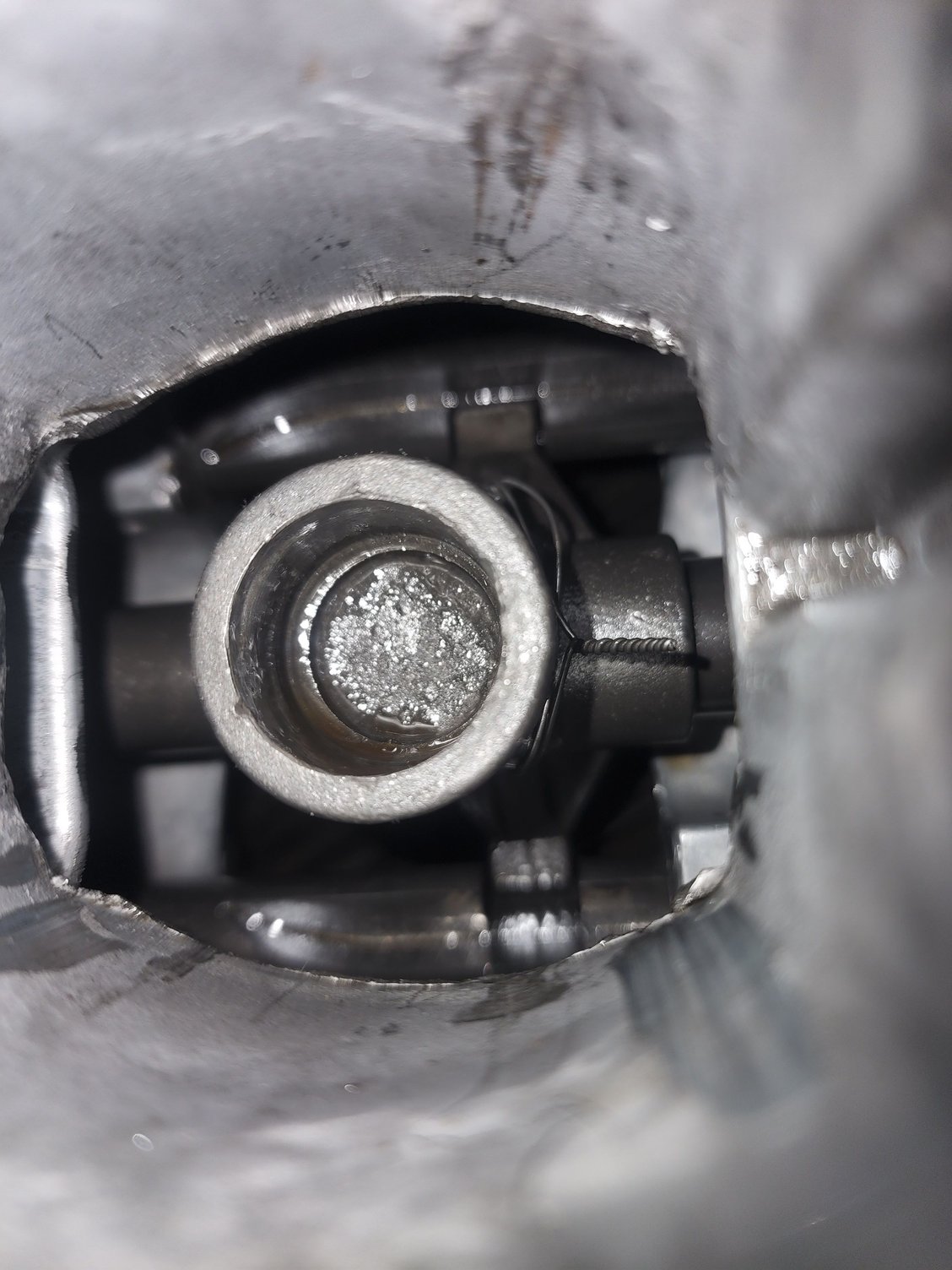

Sounds like the roll pin that is in the top of the tabs under the shifter tower. Holds the little cup deal that shift ball sits down into. I had mine almost fall out onetime and shifter would just flop around. I took shift tower off trans and was able to use a pry bar and get roll pin stuck back in. I then put a couple round of safety wire around it and tightened it up with some safety wire pliers and never had a problem out of it since.
Sound like same issue your having.
