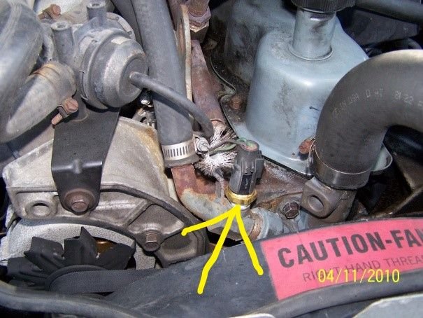

Try unplugging this temp sensor and see if it will run without surging. A surging 6 cylinder is hard to get straightened out completely.
That made no difference.

Mine will stop the surge if I unplug the water temp sensor, but then I'm stuck in default mode.
Over the years, I've checked every sensor, pressure, followed the post by Broken Wire about fixing the surge, with only a decent improvement. I've learned to live with it. It's only obtrusively present and annoying on a really cold day.
