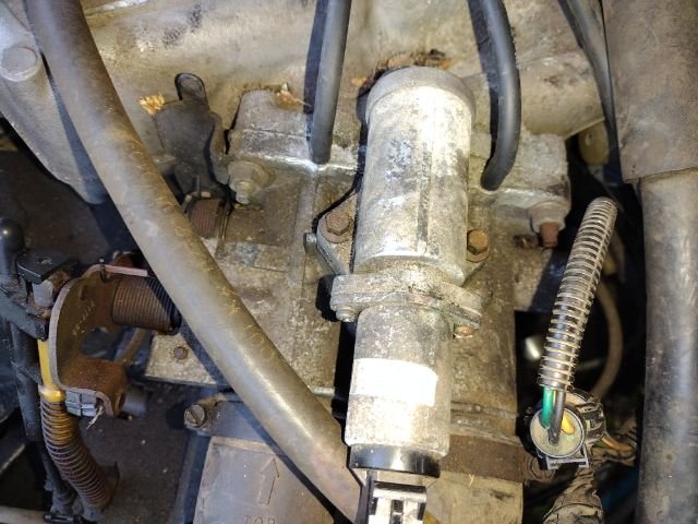

I ask about the IAC because there are a few different styles and they are not all interchangeable. Can you post a picture of what you have?

Here is the IAC

Looks like the right style to me. How are you checking its function?

IAC:
KOEO I got 12.02v to it. Reading the resistance across it I have 10ohms. Bench tested it with 12v and ground it does open and close and is clean.
