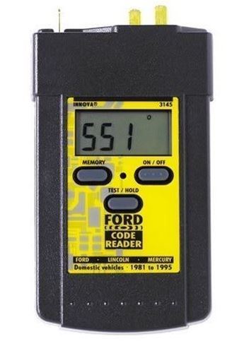

The vast majority of parts you'll need in the future if available for a F350, will work on your E350.
This is probably the best investment (30 bucks or so) you can make if you're depending on a shop or parts store to get your codes:
