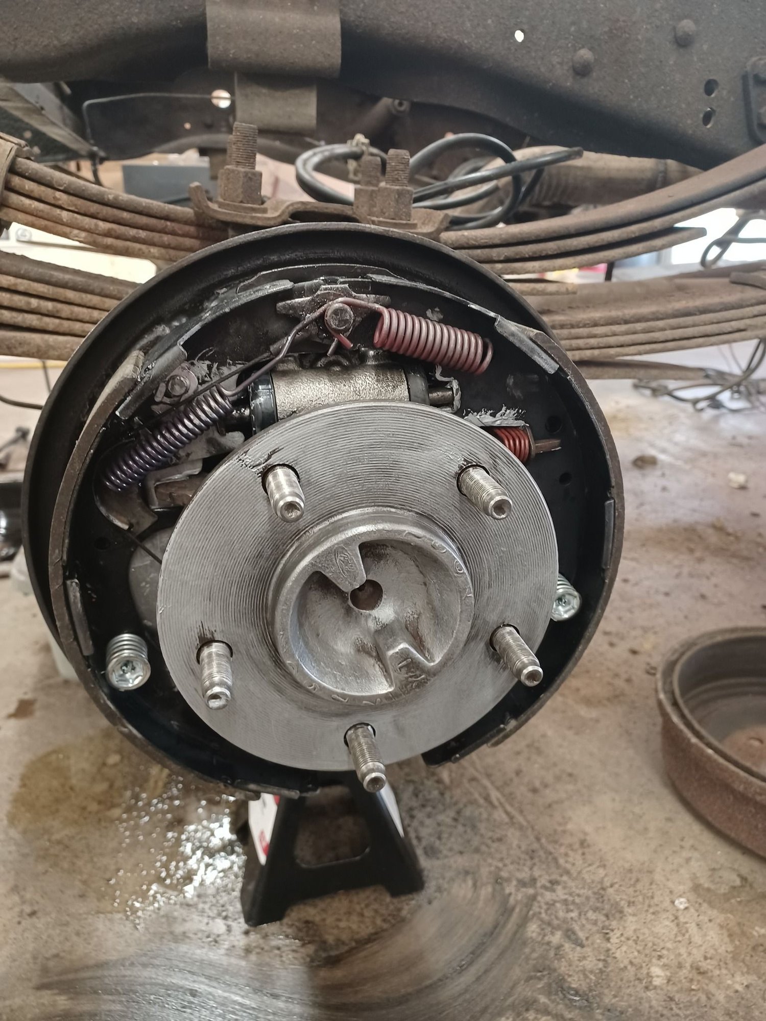

New brakes, bearing, calipers, lines, shocks, and I found wheel wells that were in way better shape at the upull. Rattle can where I could reach the frame with wire wheel and spray can. I also rewrapped the wire harness while it was exposed. New ball joints as well!

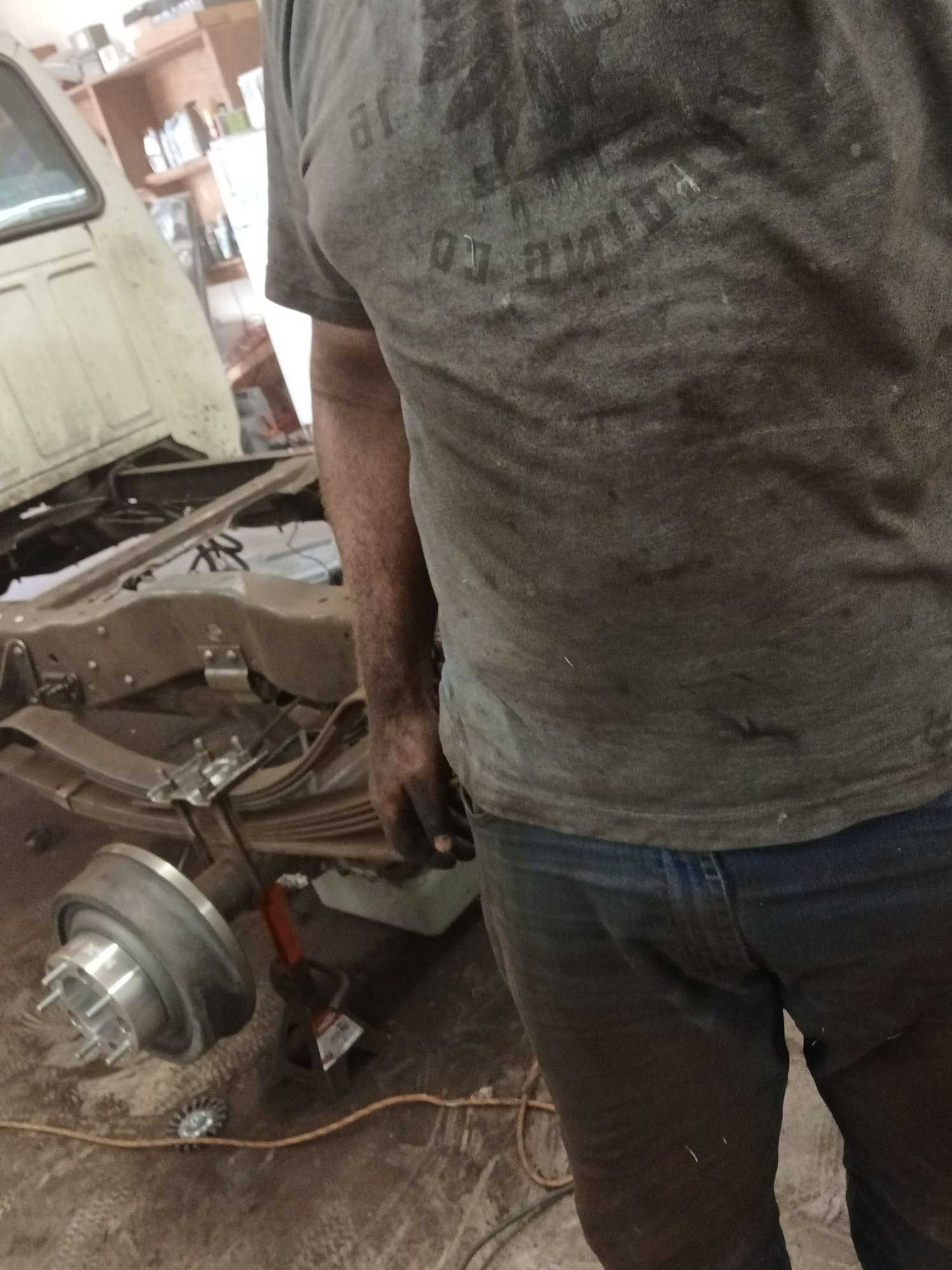

New rear ere'ting.

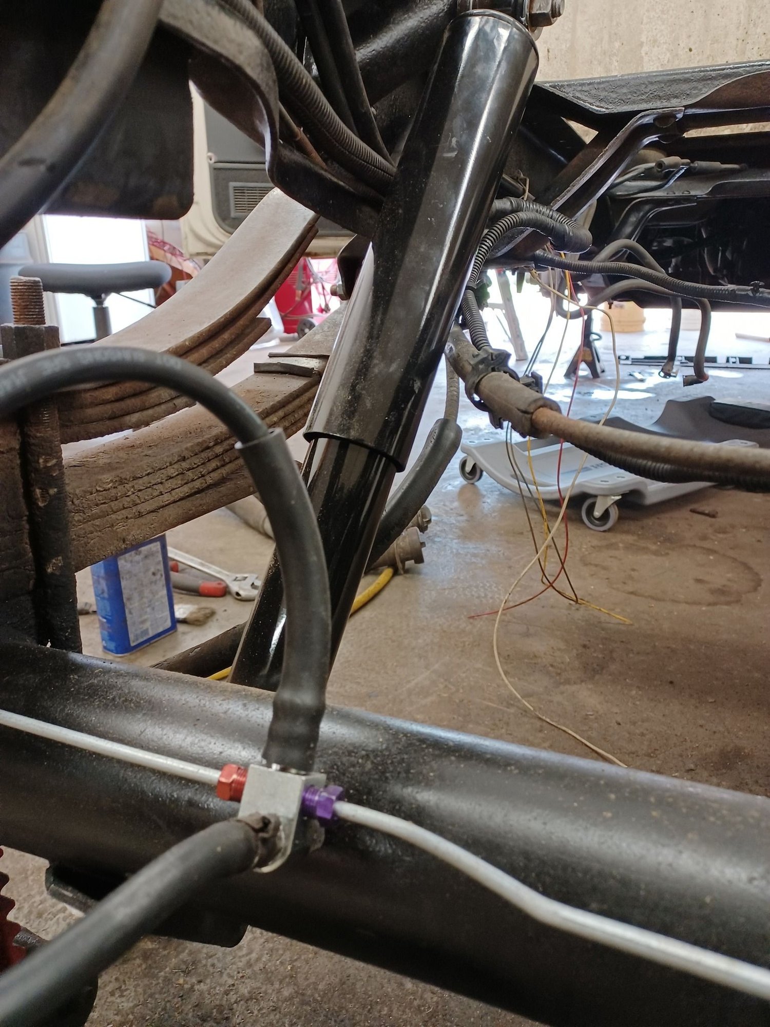

Had no choice on the stuck rear brakelines breaking, so I replaced those. In hindsight I should have done all of the brake lines at once, but here we are in the future. I changed the diff fluid, and put on new shocks.
Effing rust removal. I WILL go with the sandblaster next time I do this.
Yes, those are 2" spacers on the rear.

Went ahead and painted the gas tanks red while they were out and clean (because why not). I found this awesome reflective insulation stuff to use in the tank strapping. Two new fuel pumps with sending units. Had to rewire the rear, as the replacement came with a different connector. Cleaned the fillers. Don't talk to me yet about the exhaust...holy hell why do people do this. Straps will always be better than the popcorn your cousin leaves all over the exhaust with his awesome skills.

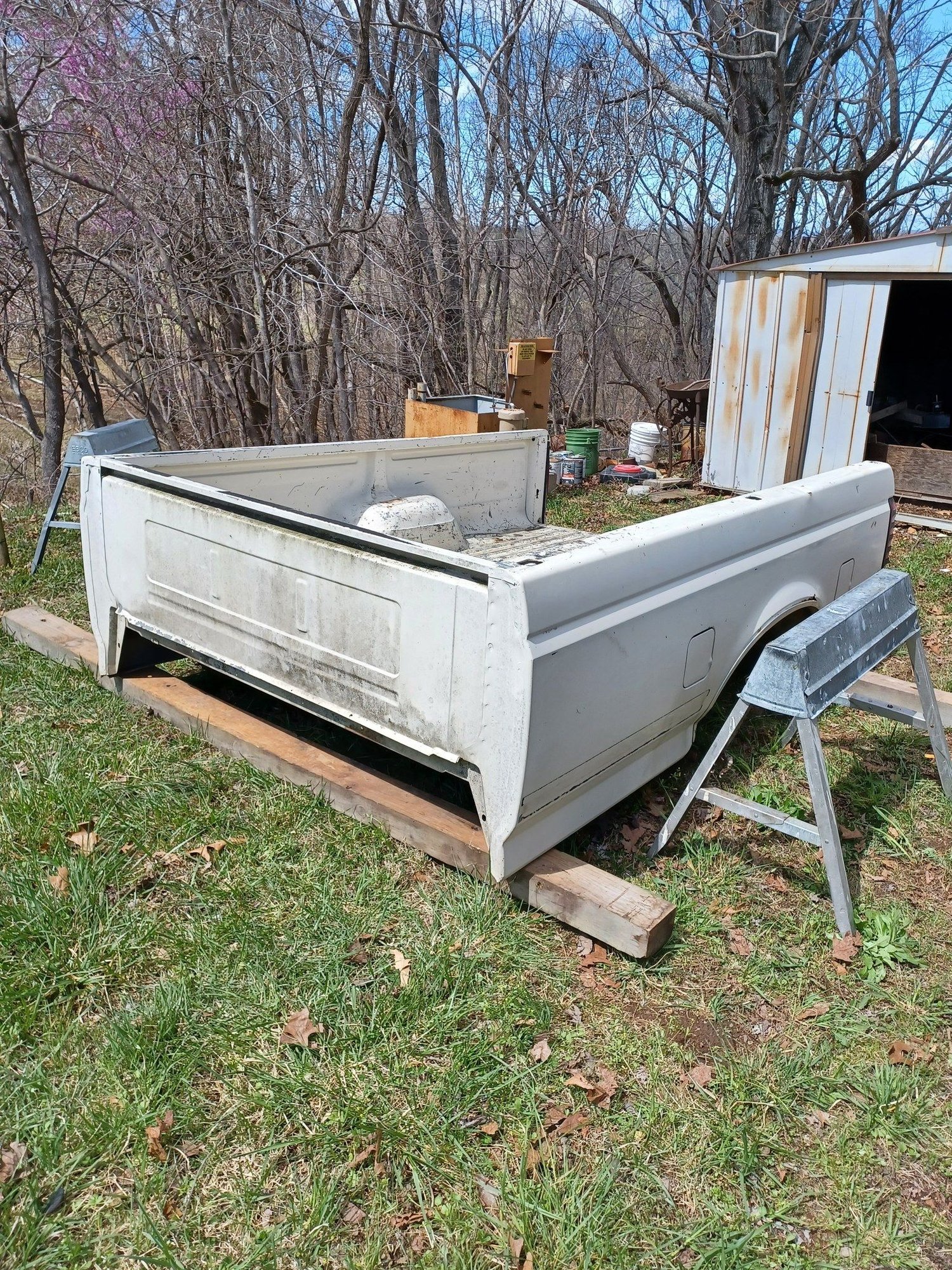

Okay, back at it with the white truck. The rain here in the south has kept things busy.

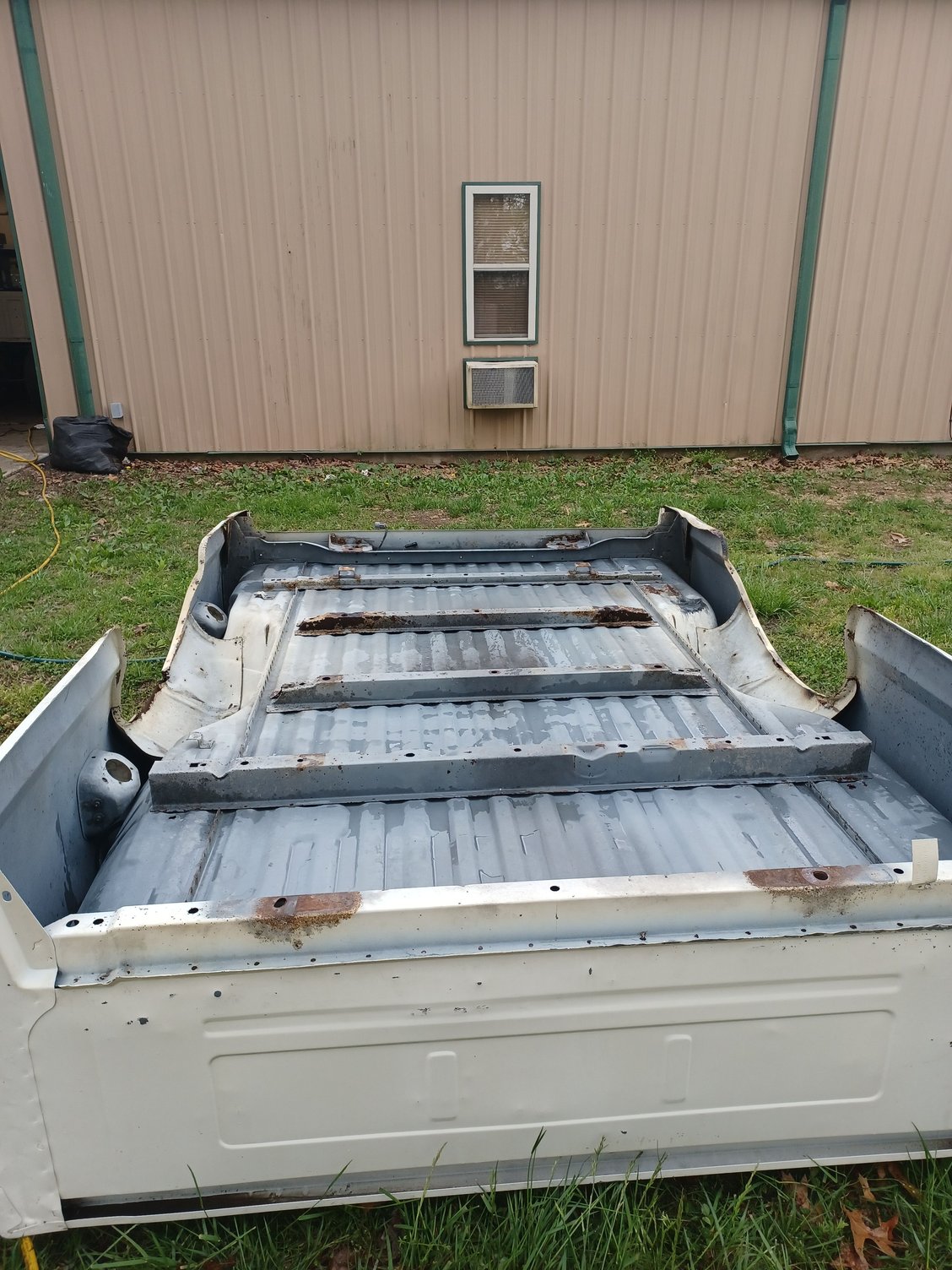

I have some decisions to make regarding paint and body, that I don't want to bother with until I take a stab at the powertrain first. This has all been to make the truck safe and usable again, and a stopgap for future decisions. Hence the following choice to just scrape some rust off the bottom of the bed, rattlecan some spots with rust primer, and reattach. I did put plenty of anti-seize and used stainless carriage bolts.

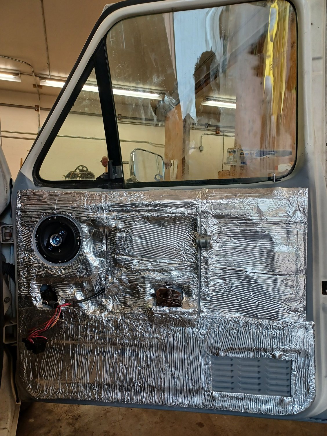

I put in new power window motors, lined the doors with insulation, and reattached the panels including a donor from the u-pull (it is the darker blue, but it has all its parts).
