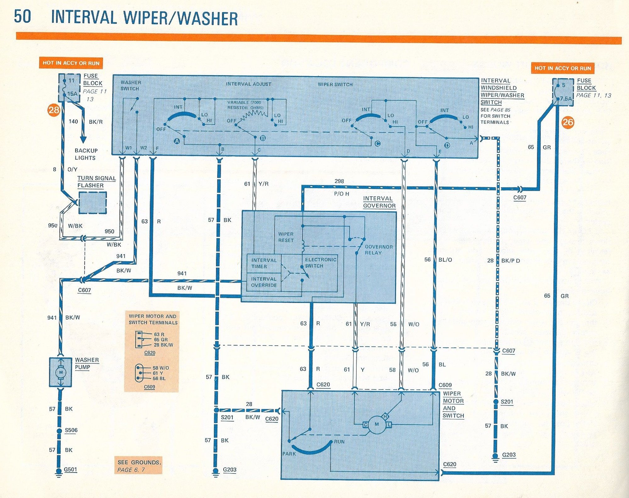

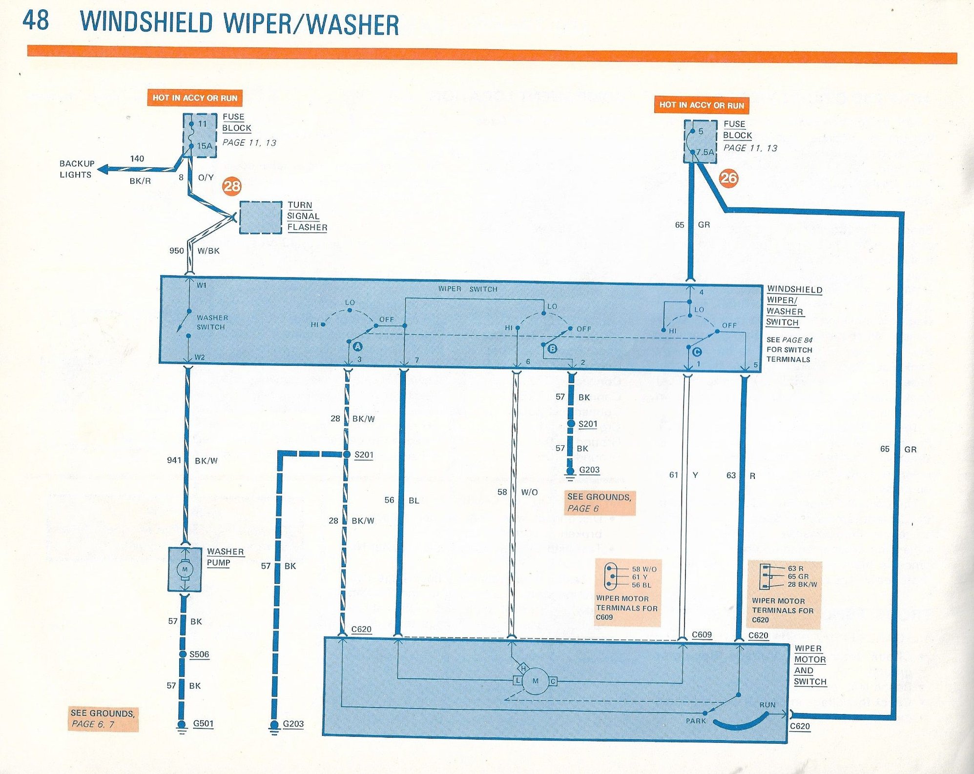

I'm working on our Big Girl, an 82 Econoline 4.9 I6 C4 transThe wipers have up and quit. I've checked the harness, and replaced the switch with an NOS part. The motor checks out as good. I'm suspecting the park switch. I REALLY need a wiring diagram for the wipers so I can troubleshoot the switch before pulling the wiper motor out.
If anyone can spare a moment to post one up, I'd be very appreciative

Do you have the intermittent wiper function or not? it is a different diagram for each

Well I found these in my files for a 1981 Econoline. I would bet that the 1982 is the same.
