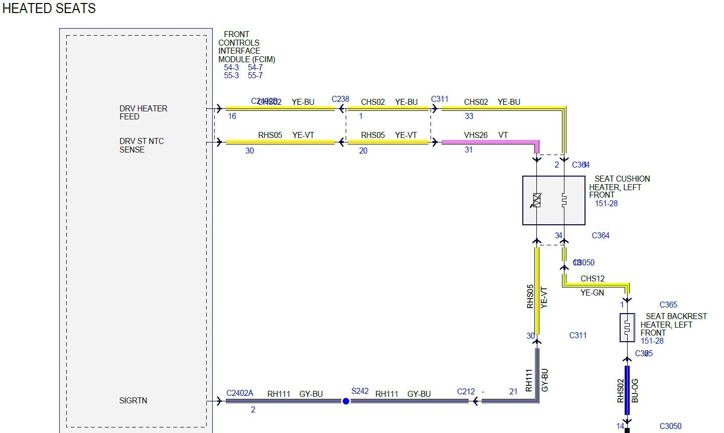

I am not sure if there is a thermostat or thermistor in the circuit. The switch is a three position push button type and it is basically defaulted to High when turned on. Push the button to select Med or Low or back to High. I did find this wire diagram, but I am not good at symbols. I think one is a rheostat and the other is the heating coil. But its just a guess.

blue wire to point 14 make me think it not included??? but i cant seem to find a separate sensor in the parts fiche? and JL3Z14D696A is unclear if it has the sensor built in???
ugh. really wanted to use the 'correct' oem heating element...

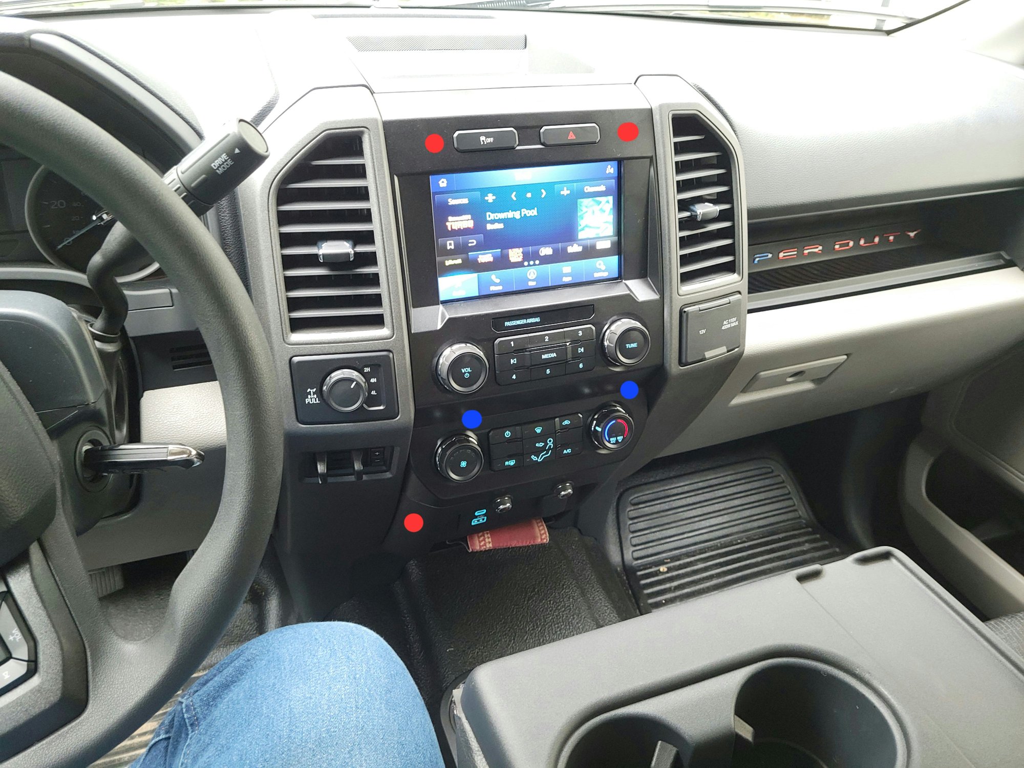

Here you go @mewaschuk . I got the ***** installed this weekend. I still need to tap the fuse panel to get key on power, but else is done. The surface they are mounted on is angled downward slightly but I felt this was the best location. I wanted to mount them between the radio and climate control ***** but there's no room bedind the panel. I'm pleased with how it came out. The only other places the ***** could be mounted are outboard of where I mounted them where they would be angled toward the seats they control or way up top just outboard of the hazard/traction control buttons.
If anyone has any suggestions for fuse taps or already figured out what slot to tap for key on power I'd appreciate it.
The red dots are other potential mounting locations and the blue dots are where I wanted to mount them but couldn't due to panel construction.

looks good! i debated on those switches and ended up getting a 3 position low profile version form leatherseats.com. in part because it has a 3yr warranty and i never thought to put the switches on the dash like that. i was planning to use the rear seat heat fuse in the passenger footwell panel, if it has keyed power....
