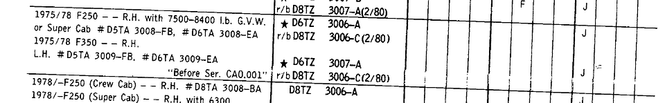

This page wasn't scanned straight by whoever did it years ago so I had to grab some above and below the entry for yours but this is what I was referencing. 1973-1979 Truck Parts Catalog. The casting drops the 300 portion of the number.

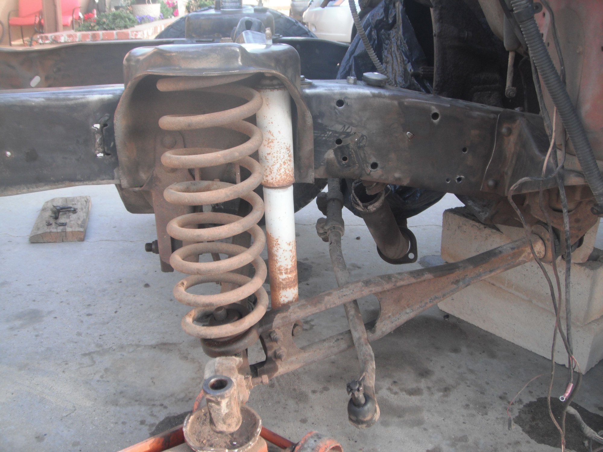

This is interesting ...
Suspension fully extended, "on the hook", and the shock is already 3/4" short. Wrong shocks? Could be .... Who knows?
The other thing is with the hook off the shock only drops another 1/4" before the dried up and rotten bushings on the radius rod get in the way. There's almost no tension on the spring at this point and I'm gonna quit worrying about this. I don't I need no stinkin' hook. As long as radius rod is still attached that spring ain't goin' no where. I just need an inch longer shock.

I gotta admit I've never seen radius arm bushings that far gone. I think those are outside of the useable specification! Mine were in much better shape when I got my truck and I've since replaced them with NOS bushings. By the way, there are two different part number suffixes for both bushings (insulators).
INSULATOR - FRONT RADIUS ARM - Outer - 1 3/16" long C5TZ-3B203-B/C5TZ-3B203-D 2
INSULATOR - FRONT RADIUS ARM - Inner - 2 3/8" long C5TZ-3B203-C/C5TZ-3B203-E 2
The B/C bushings that I've had in hand are a significantly harder rubber than the D/E bushings made by Harris, who was a common rubber parts manufacturer back in the day. I can tell by looking at them the B/C is a less grainy, smoother rubber and is harder durometer. Anyway, once installed the radius arm with new bushings won't want to drop nearly as much as with the older bushings and yours barely count as that...
