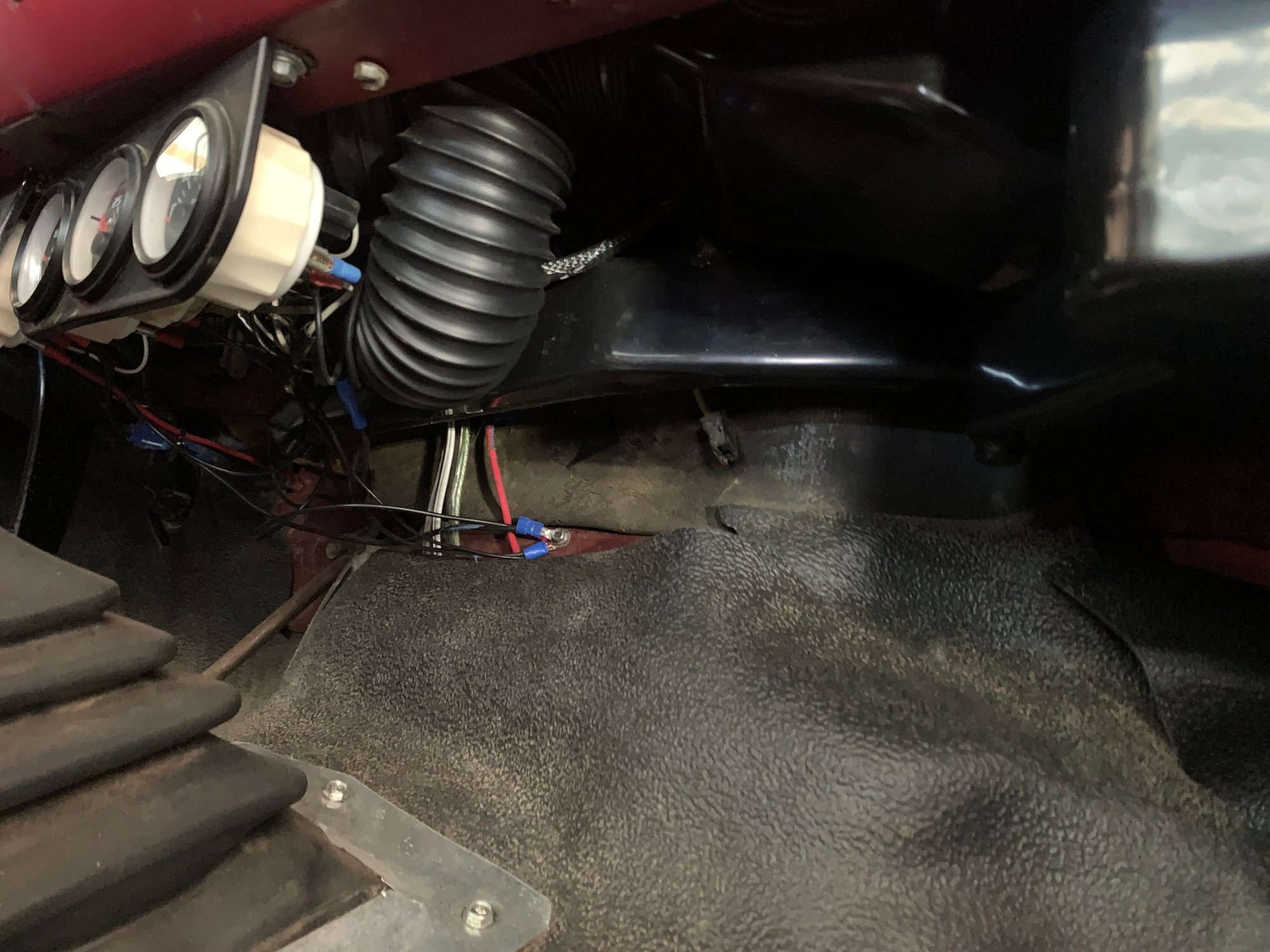

I installed a Classic Air system in my 79. It works good but it’s loud and the temperature blend function is kind of useless. It will blow cold or hot but not much in between. The evap box is pretty big but it doesn’t get in the way and no one complains so I’m ok with it. It uses flex duct to connect to the existing vent outlets. Other than the old vents everything else is replaced in the kit. The controls are not the best looking but they kind of fit in a 79 cab. Here’s some pics if it helps.
