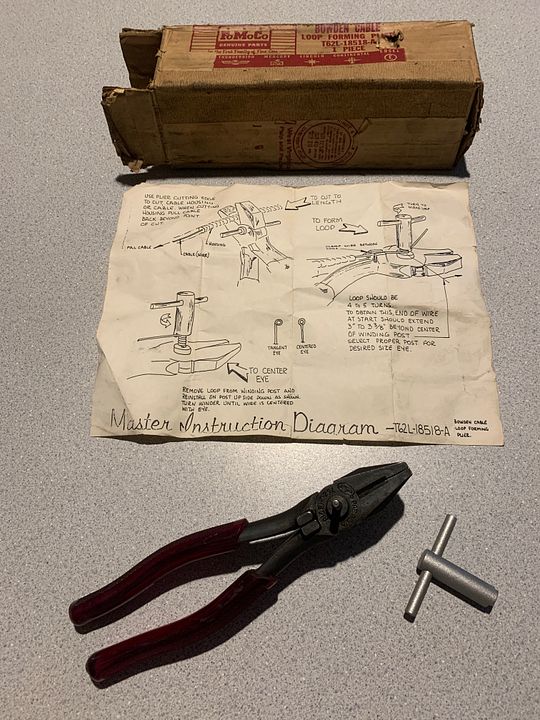

The original cable used in 1965/66 was no longer serviced
C5TA-18552-A - 23.50" long
the recommended supercede was
C5TZ-18552-B - 28.00" long
To make it the same length as the original it's possible to cut the replacement a bit shorter and then rewind the loop using the FoMoCo Bowden Cable Loop Forming Pliers - one of the specialty tools.
The C5TZ-18552-B was superceded by D1BZ-18518-A
One showing at Green Sales and one at NOS Parts Ltd. I can't say how long or any details about the D1BZ replacement.
D1BZ-18518-A in-stock now | Ford Parts Locator (rearcounter.com)
