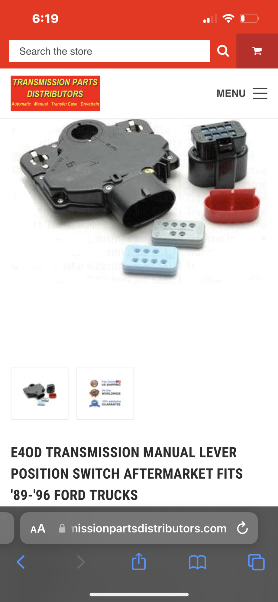

Sounds like MLPS or manual linkage misadjusted. Will it start in neutral?
I would disconnect lever/rod at MLPS. Keep truck off, e-brake set, wheels chocked, pop it into reverse and verify those two lights illuminate. If not, I would adjust the MLPS as needed.

like this?

Yes that was the thing I zip tied.

There is probably a seal behind the MLPS as it attaches to manual linkage inside the case, so it would need to be removed to R&R this seal as well as to clean the case during a reman. I still bet that is misadjusted. If not, see if your shifter bushings are junk.
The 4R100 in my Expedition would sometimes not start in P, always did in N. Push up on the shift lever, would start. Installed fresh bushings, no problems since.
