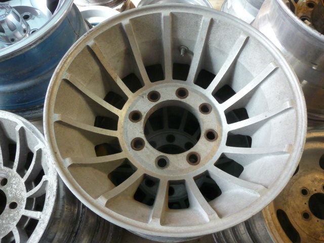

I'm trying to figure out what I'm finding and what I'm looking for. I've decided I want a set of this style wheels and the more I learn the more questions I come up with.
I need a set of 8 lug, which at that time were all the same so that helps. I'm assuming they were all 9.75 " wide ? and they're all 16.5" I assume ? that sucks.
There are 15 spoke, 18 spoke and 31 spoke I think. I'm not sure what's what on that, different style or brand maybe. I like them all but is one more desirable than the other and is there any reason to avoid any particular one ?
The spokes seem to be polished, the pockets just bead blasted ? were they coated or painted with anything ?
Are center caps available to fit them still ?
As popular as these wheels were at the time there's surprisingly little information on them. that I can find anyway.

Yes all the old school ones were 16.5 and either 8.75 or 9.75. and yes 8 on 61/2 lug pattern. I have seen and have owned both widths. Also correct in the spoke count, the only difference I have ever seen in the spoke count is one pair I got a long time ago that the Po said had came off a Chevy, fit a Ford truck just fine though.
Even though historically a Chevy rim will not fit a ford due to the center hole of the rim (for the hub) is smaller on a "Chevy rim". Yes all I have seen are rough feeling on the most of the recessed part of the rim and then have a polished raised part.

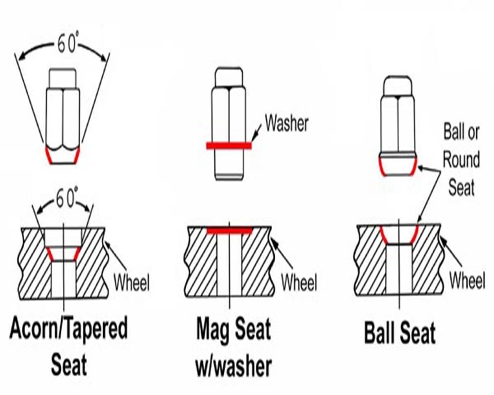

As far as lug nuts you need the Mag seat with washer, also called a shank style with a washer. So the aluminum rim face is thicker than steel rims. And when you set the rim on there your lug nuts are not going to stick out WAY past the rim face like normal. That is why you use the Mag seat style lug nut.
As far as center caps that fit, that can be hit and miss. I have bought the with them and without and always had to take the rim to a old tire and rim shop and just test fit a few dozen options to finally find one to fit.

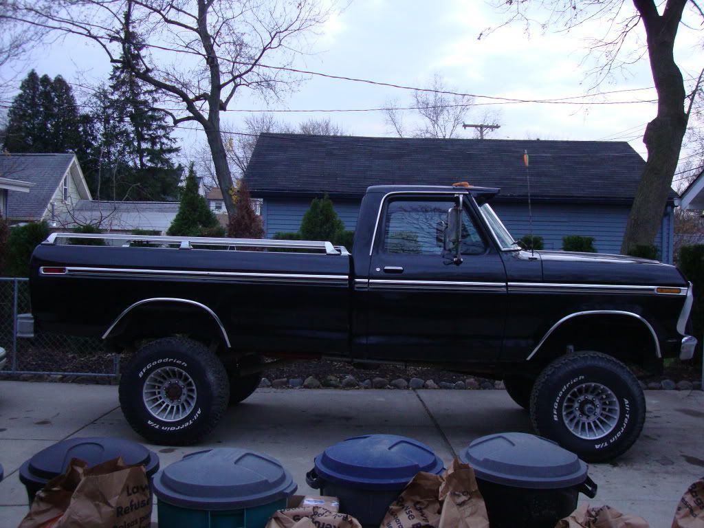

Also be aware that when putting these rims on a Highboy (possibly) there can be a clearance issues between the tie rod end and the rim. Caused by a backspace or offset difference?? I seem to remember the guy had drum brakes on the front though. Fit the rear just fine, but NOGO on the front.
Fordguy2100 is the guy that had the front clearance issue on his highboy, ask him for the exact application issue description.
https://www.ford-trucks.com/forums/1...-wheels-6.html
Also make sure you to check if you are getting a hub centric or lug centric rims (I think you can get them either way???) and use the correct matching lug nuts.

Notice there is more center on this rim? Detailed pic below.
And not on this one.
2nd truck pic.
1st truck pic.

Lug nut info. Slotted (mags) or turbine/slots aluminum wheel lug nut info. Gorilla Automotive 75187 - Gorilla Lug Nuts
Summit racing • $10.99 Lug Nuts, Shank with Washer, 1/2 in. x 20 RH, Closed End, Chrome Plated Steel, Set of 4
Brand: Gorilla Automotive
Manufacturer's Part Number 75187
Part Type Lug Nuts
Product Line: Gorilla Lug Nuts
Summit Racing Part Number GOR-75187
Lug Nut Thread Size 1/2-20 RH in.
Lug Nut Seat Style Shank
Lug Nut Head Style Standard
Open End Design No
Lug Nut Shank Length (in) 1.000 in.
Lug Nut Shank Diameter (in) 0.740 in.
Washer Included Yes
Washer Shape Centered round
Washer Outside Diameter (in) 1.125 in.
Lug Nut Material Steel
Lug Nut Overall Length (in) 2.000 in.
Wrench Size Required (in) 7/8 in.
Lug Nut Finish Chrome
Quantity Sold as a set of 4.
The Gorilla #75187 lug nuts are the correct fit for your aluminum slotted mags.
They have the correct 1.000" shank length and .740" shank diameter to properly fit your wheel.
Be certain to buy the correct part number, Gorilla also makes the same lug nut in a .750" shank length and .685" shank diameter #73187, while these will "work"..
the wheel will not be properly centered.
Correct: Gorilla 75187 Chrome Duplex Mag Lug Nuts 1 2 in x 20 RH | eBay
incorrect: Gorilla 73187 Chrome Std MAG Lug Nuts 1 2 in x 20 RH | eBay
You can also buy these locally at most parts stores.
