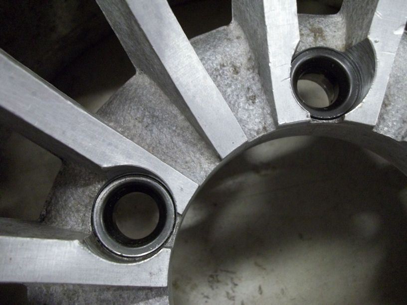

I have quite a few of the washers stuck in the lug holes. they're pretty much flush I could just install the new ones over them. but I'd like to remove them if I could, but they are in there solid I suspect someone used too large of washer and it became part of the wheel now. .
anyone ever find a way to remove them without damaging the wheel ?

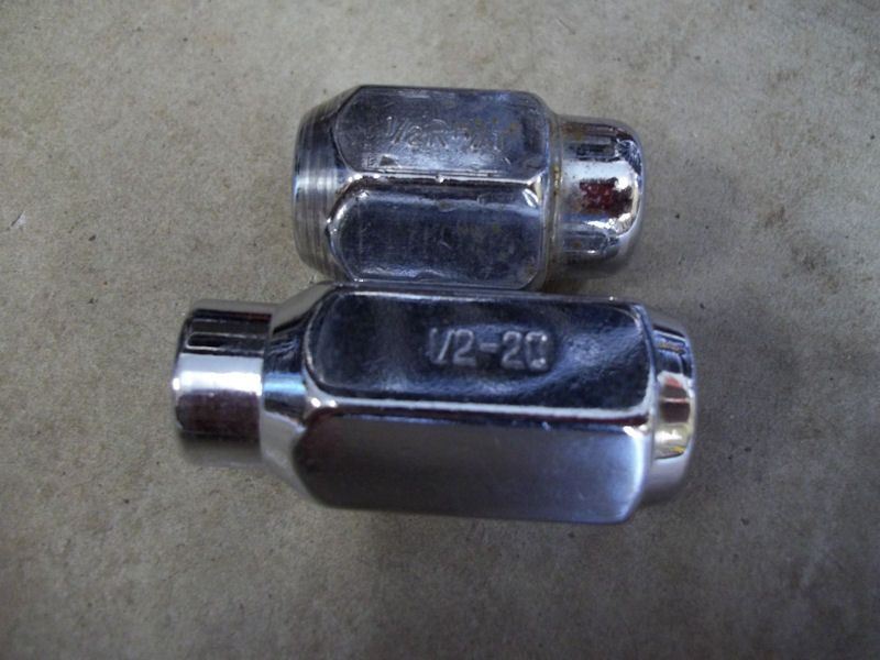

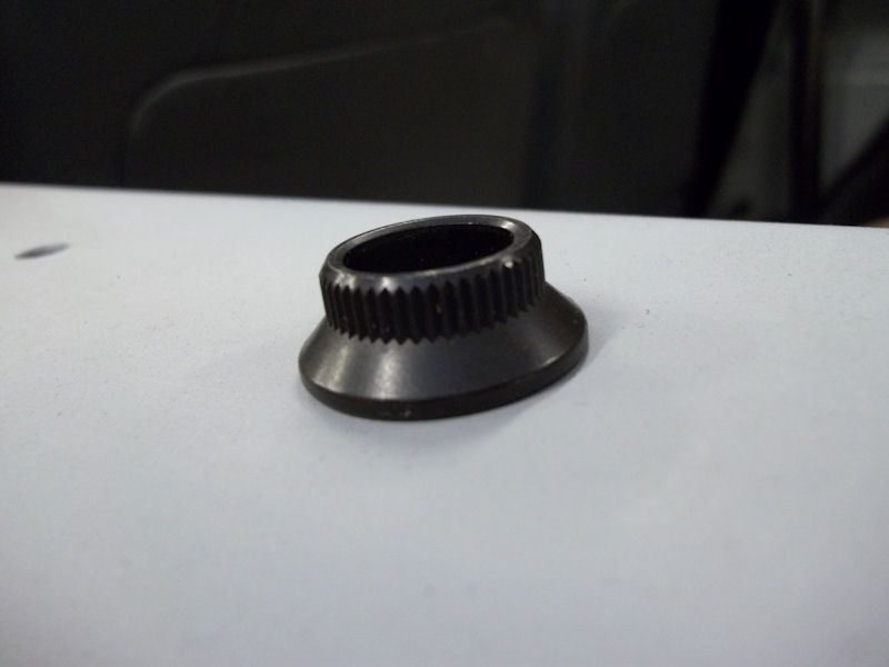

I recently refurbished my 15x10 Keystone Turbo III's. with the 5x5.5 bolt pattern
First thing I did was convert the PITA mag lug nuts over to the modern conical style.
I also used the stainless steel center caps sold on Amazon. Fits perfectly
and because the aluminum hub of the wheel is so thick and early vehicles often had shorter lugs, I went with an extended lug nut that partially submerges into the wheel without bottoming out.
Professionals recommend that 1/2" lugs have at least 1/2" of thread engagement (10 turns on a 20 TPI stud).

I have quite a few of the washers stuck in the lug holes. they're pretty much flush I could just install the new ones over them. but I'd like to remove them if I could, but they are in there solid I suspect someone used too large of washer and it became part of the wheel now. anyone ever find a way to remove them without damaging the wheel ?
See if you can use a long shaft pin punch and go in from the back side of the rim and see if you can catch the edge of the washer and tap it out.

If I had seen those conversion washers before I bought new lugs I'd have probably done that.
I tried catching them from the back and there's not enough to hook. I thought about using a 7/8" tap to get a hold on them and pull them out but that didn't seem like it was going to work either. I may just have to leave them.

They're steel washers, right? Tack weld something over the hole and punch them out from the back. A few good tack welds should hold well enough and won't generate enough heat to damage the wheel but it might be enough to loosen them up.
