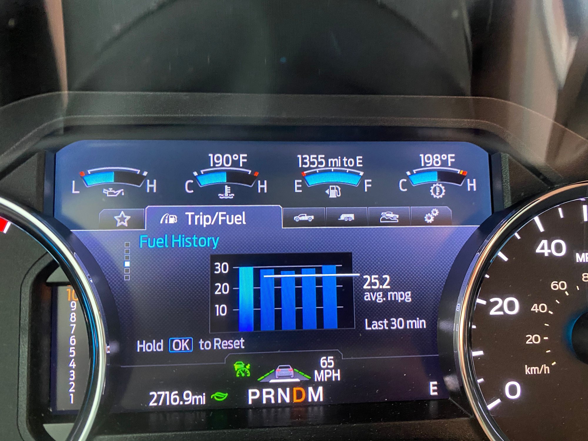

my problem is that i cant drive 65 . speed limit is 75 or 70 so most traffic is moving at least 75
truck loves 77. 23 mpg
i may have to have wife drive 65 and see how high it goes
