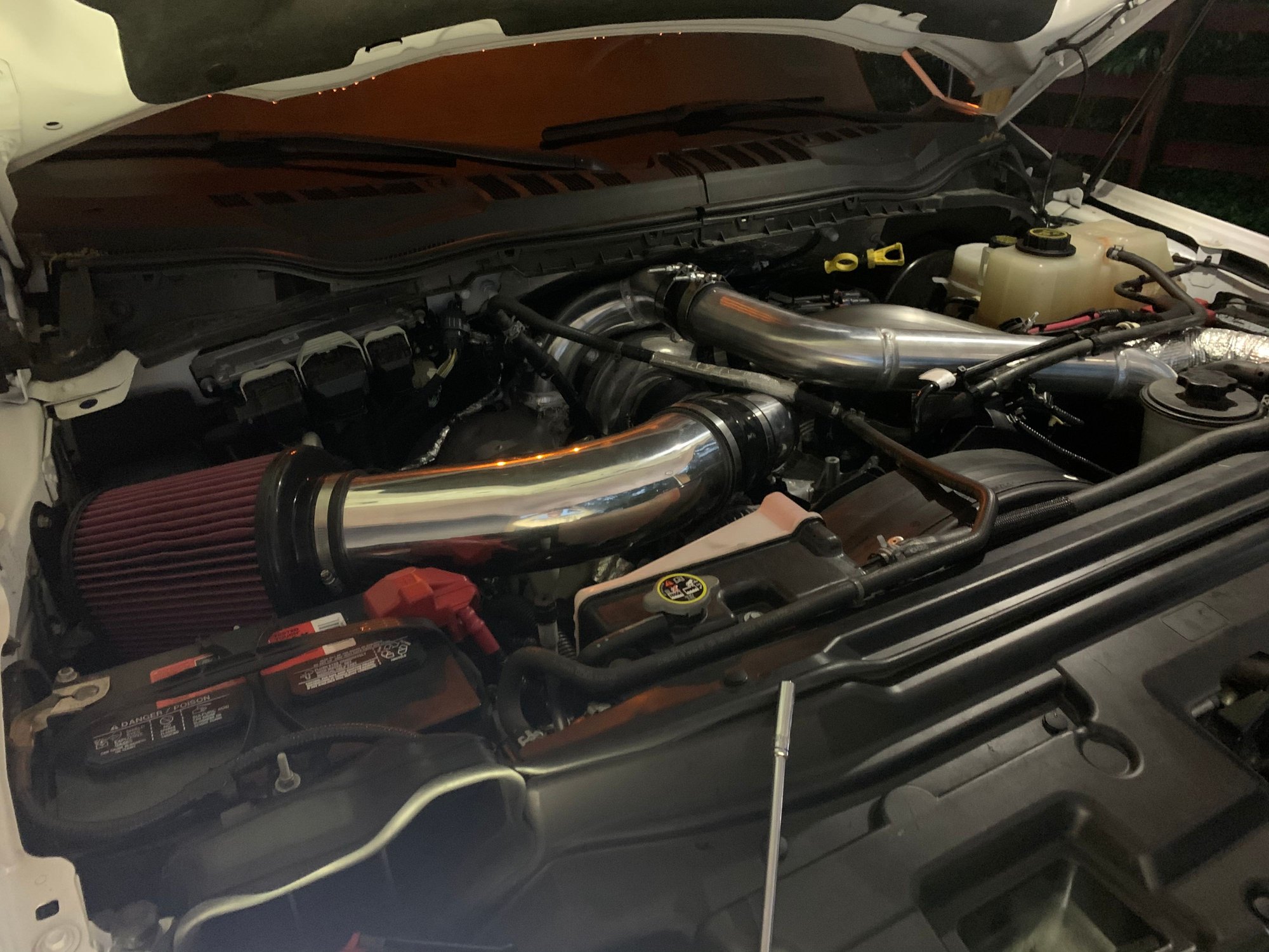

You asking about a full piping kit?
H&S on my truck.

Looks pretty. Less power than stock.

Running a 0HP tune with the H&S setup vs factory plumbing, i saw a bump of 21HP and 59FT/LB. 402HP to 423HP with the only difference being the piping kit.
Also, increased throttle response, lower EGT’s and a couple PSI on the top end picked up.

Only difference? So you measured after deleting the EGR and DPF and before installing the piping kit? Have you measured while pulling a heavy trailer on a hot day where the intake is sucking 150 degree air from under the hood?

I think some people see this as "ghetto bling" and is simply bolted on and left that way............ (they just don't get it lol) Nice set up btw.

some people just hate seeing other people happy. Thats gotta be what it comes down to. lol
