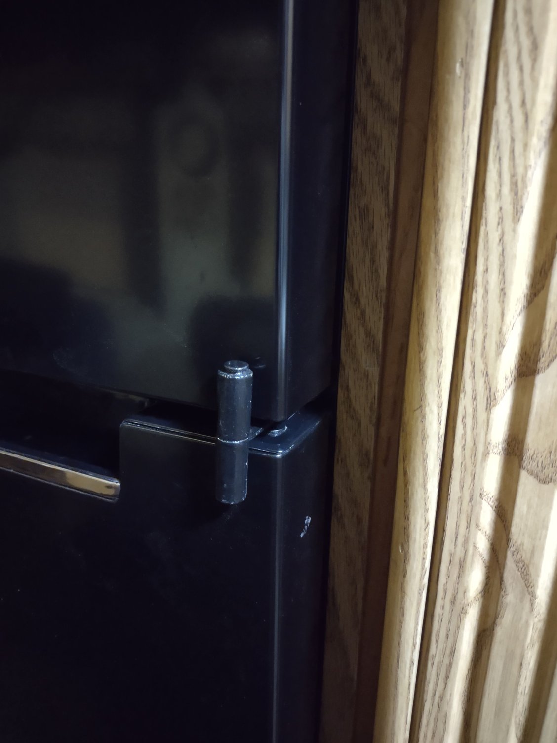

It's in there and running the blue tape is there to hold styrofoam that's filling the gaps, it will be covered with the trim later. The fan will also be finished later and some L brackets added at the top when I get them. This is as far as it goes for now, I want to get the trailer cleaned up and out of my shop driveway so I can get my boat out and ready to go. I will have the rest of the summer to finish it up and figure out what I'm using for a inverter. It looks good but not as nice as out old frig with wood door inserts that match the cabinets.

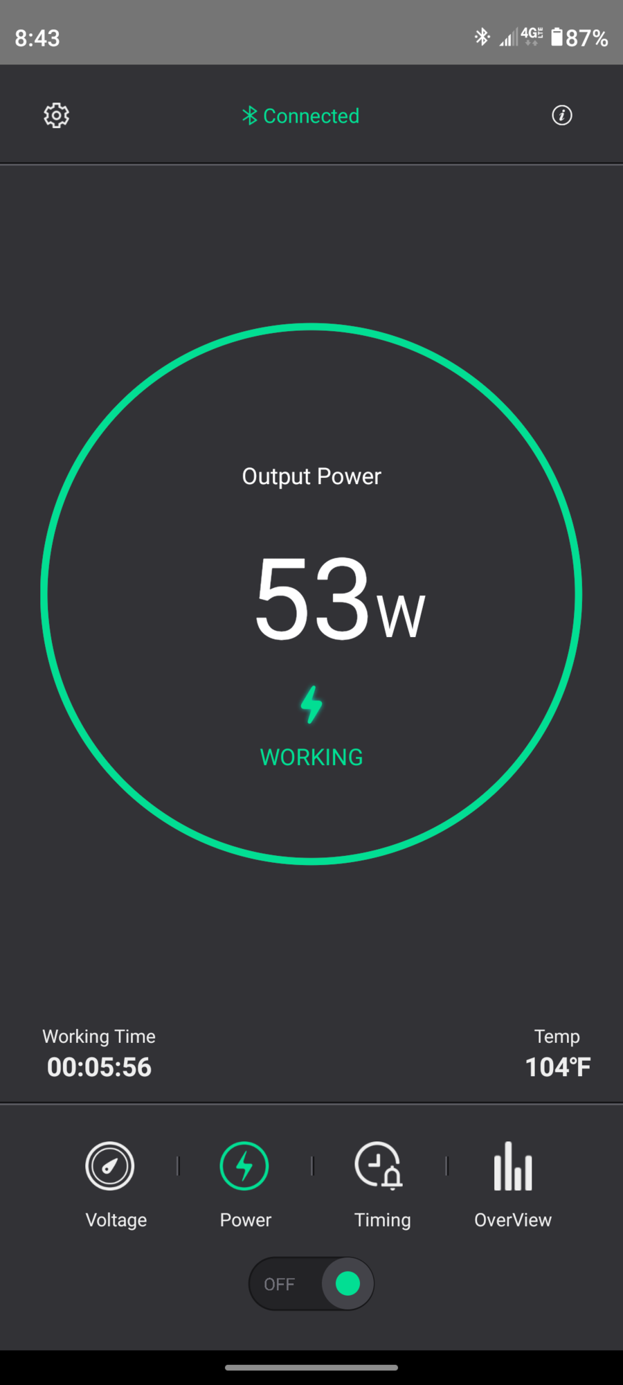

Everything is complete and ready for the fall . I installed a 2000 watt Protect pure sine wave inverter with bluetooth and a/c pass through (transfer switch). The frig draws 53 watts when running and balanced out and I have no need for the exhaust fan on warm days.
I made a device to keep the door closed when traveling and I just need so 1/2 shrink tubing to finish it off.
