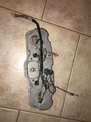

I’m installing the AAW classic update kit in my 65 F100 Custom Cab. When disassembling I didn’t get pictures of what was connected to the two post I circled in the image. What connects to these posts? Anything?

Someone with more certainty is bound to respond, but I suspect those are for ground wires.

I see what I think of as the one ground wire (black) that the 1965/66 plastic Custom Cab bezel used just above the CVR. The metal Standard Cab bezel grounded through the bezel itself.

Those two spots hold the hooks that support the wire harness as it passes behind the cluster.

I suspect TA455HO is right. Mine has nothing connected to those spots.

As others mentioned, believe those two studs are only for the wiring brackets, no grounds. I just took the dash out of my very original '66 F100 4x4 CustomCab, and there was no wires on those studs, only the metal brackets. Additionally, the '66 wiring diagram doesn't show those studs being used for grounding.

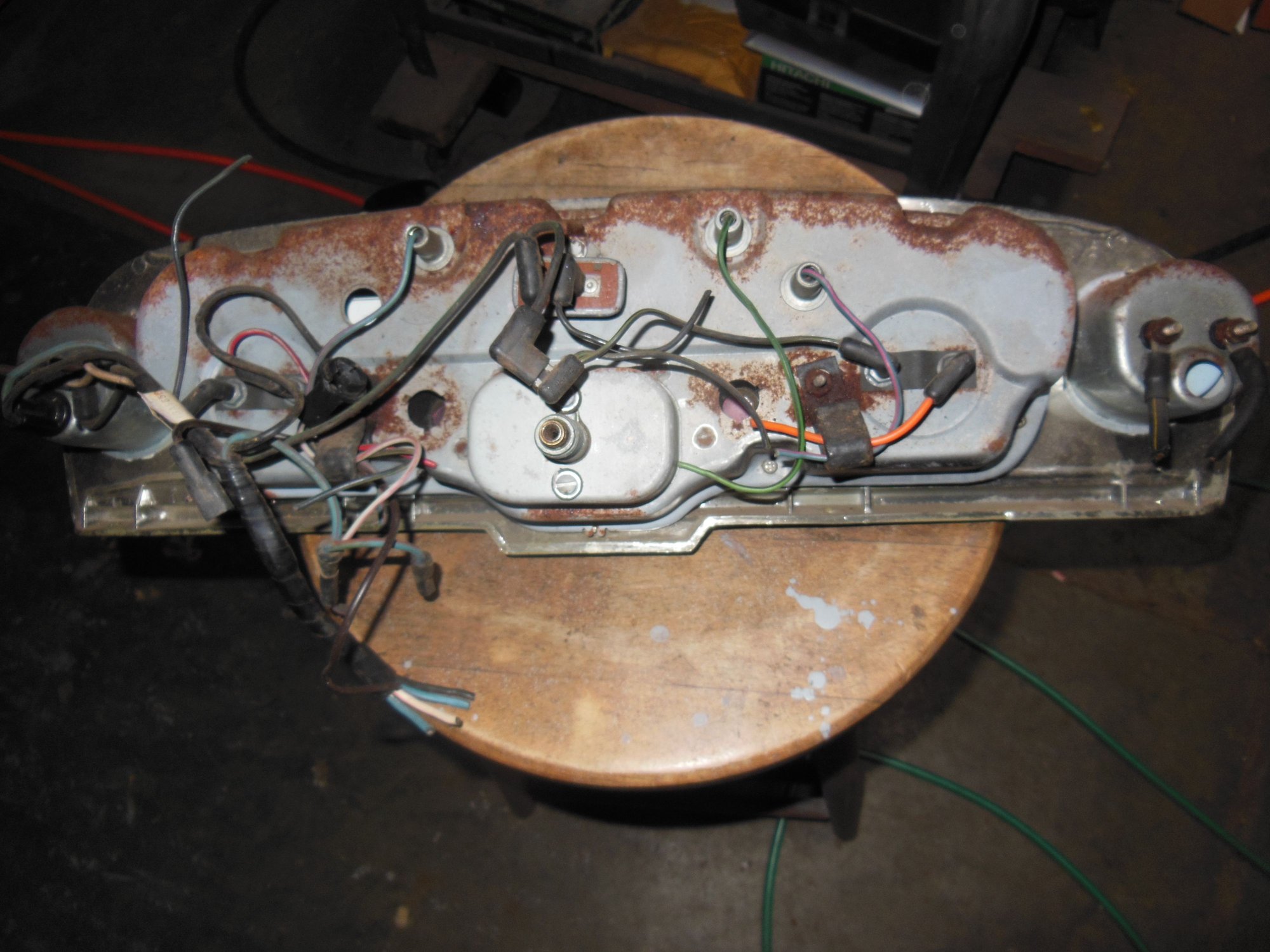

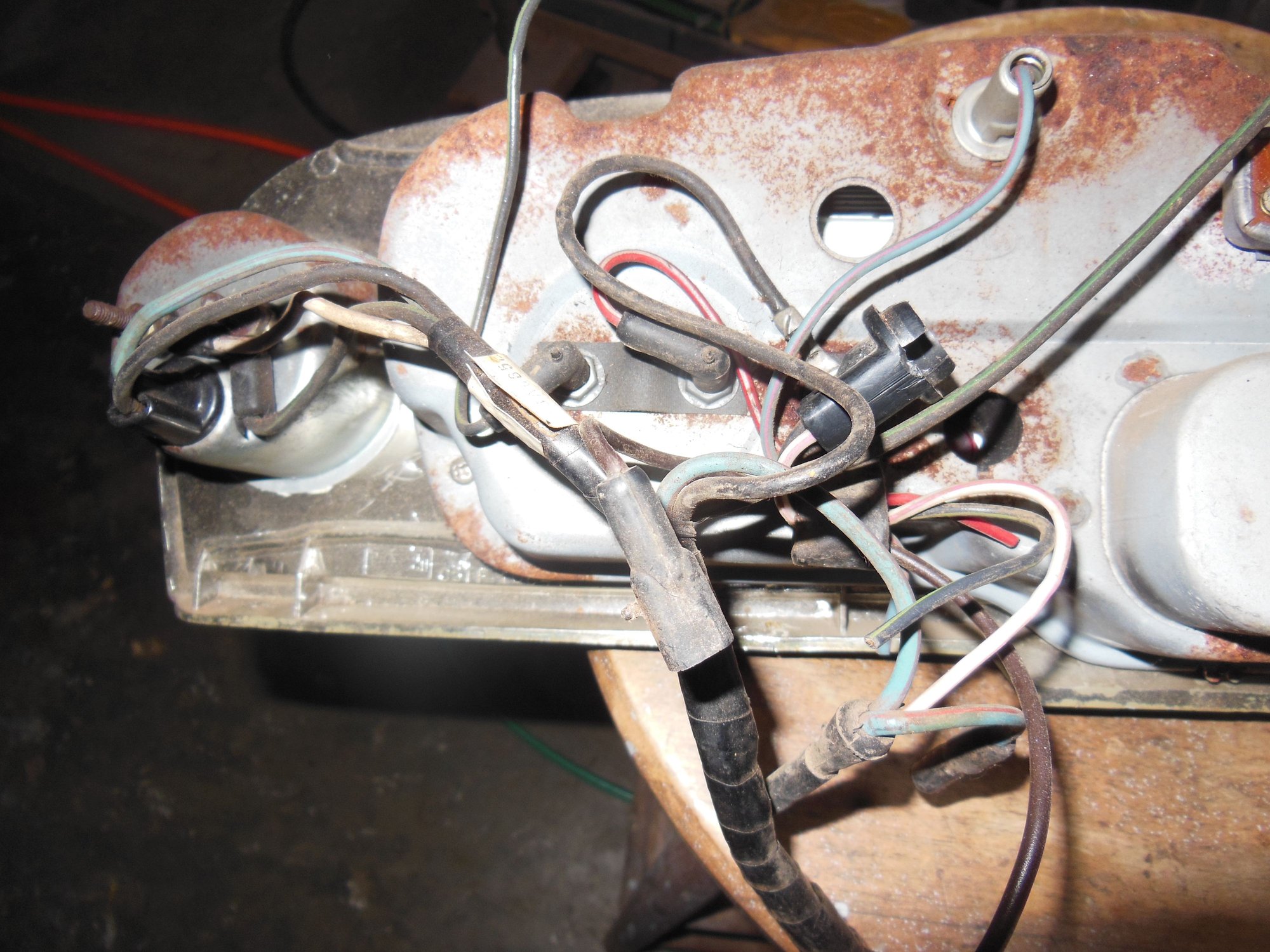

Here are some pictures of an instrument panel I got of eBay for 1966. Hope it helps.
