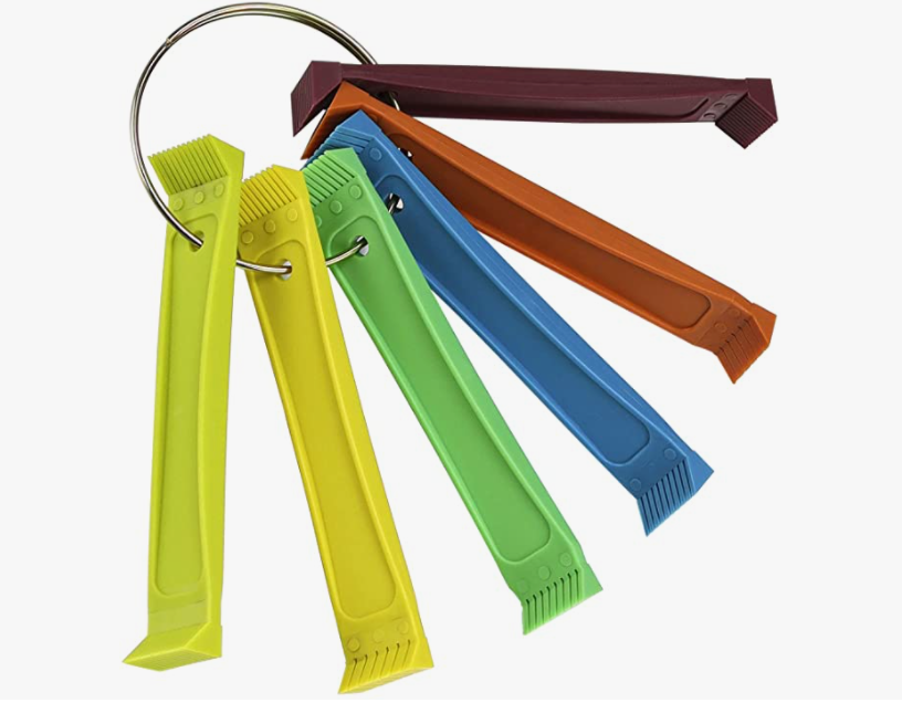

Wes444 brings up a good point!
I followed his lead a couple of years ago and bought a set of combs that look like the image below. I spent a good deal of time cleaning the radiator many times before using the comb, and the debris that came out with the comb was quite a bit. I used foaming coil cleaner, degreasers, high pressure sprayer and low pressure hose and the comb was a great idea.
As he said, rocks, bugs, debris and straightening the fins of the A/C condenser was a good idea.
