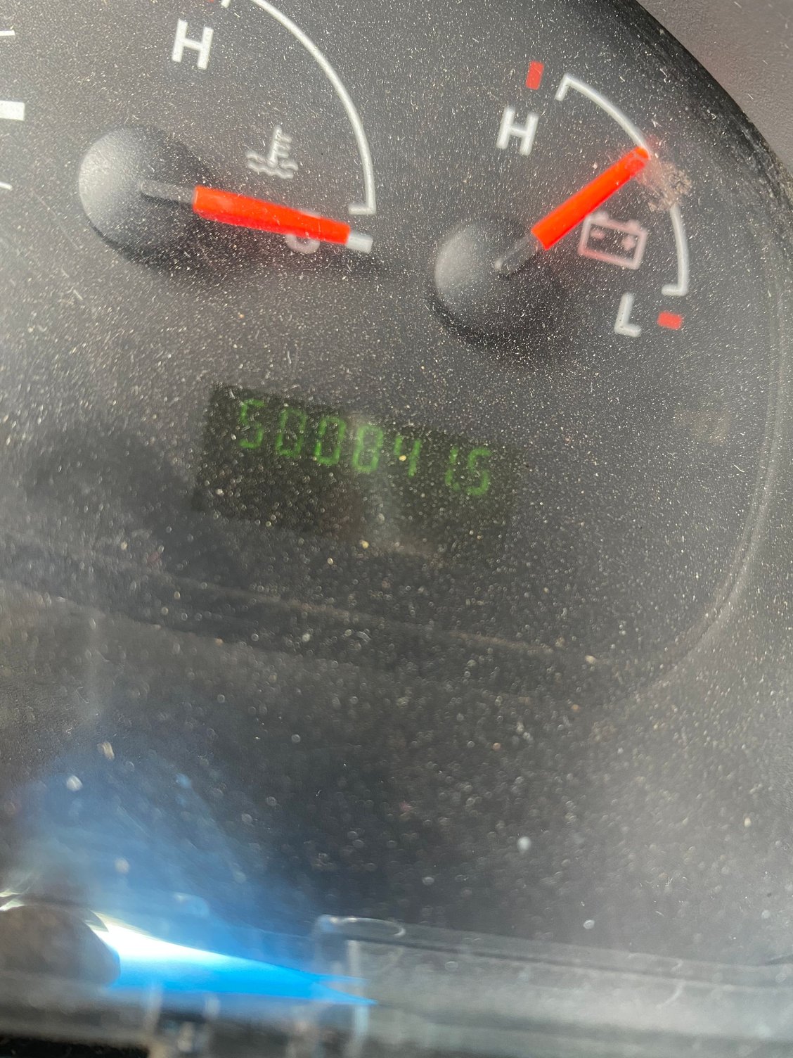

What now
2006 e350 5.4
500840 mi
runs pretty dang smooth
I don’t know if I should put an oil pump and timing component set on a motor that has that many miles.
i know it needs it’s the OE stuff still in there trans and motor
sure could use some opinions on this one guys

Obviously 500K miles, if it's all OE, there's no telling what the next failure may be, but if you plan on keeping it then I guess if it were me, 1st thing I'd do if a compression test. If compression is good, it might be worth but then you have to think about all the other components or even the transmission.

I really do like the van it’s motor and trans I’m sure are hurting it has a decent power band and shifts smooth for the most part. I did tow a trailer with 13k lbs on it a couple of weeks ago. So it makes money, but man is she a gold digger. I swear on my mothers grave those are the oe Chains ect, the PO was my uncle (my dads brother) who is in the flooring business he bought the van from diffuse ford with one PO beforehand. No major overhaul had been preformed at that time nor was ever preform. Aside from 1 set of spark plugs and on rare occasions a trans flush. That’s it…..

It would be worth the tear down and inspection cost (about 400) just to see if the OEM parts will go 580k miles
I can get a chains, tensioners and guides kit all ford parts quite cheap as a kit online (ebay) 450 or so
Add to that 8 Motorcraft spark plugs and 8 Motorcraft coils. Wrap it up for about 700 in parts + labor
I charge about 1900 total

I can do everything myself the full timing job. But I’m running into to many @while I’m in there things. Like lifters roller rockers/follower and at that point I might as well pull the heads and lap the valves and re seal everything, you see where I’m going with this

If you have the time why don't you just pull the engine and trans, tear them down and go through them, freshen everything up and you'll be good for another couple of hundred thousand.

The reason it hasn’t been done yet is that I’m using the van as my daily driver for the time being. More than likely Ill just drive it till the engine or trans goes. Then just go ahead and replace them both. That’s a lot of revolutions on those parts. I’d like to keep it alive and see just how far she’ll go before I feel that it has done enough
