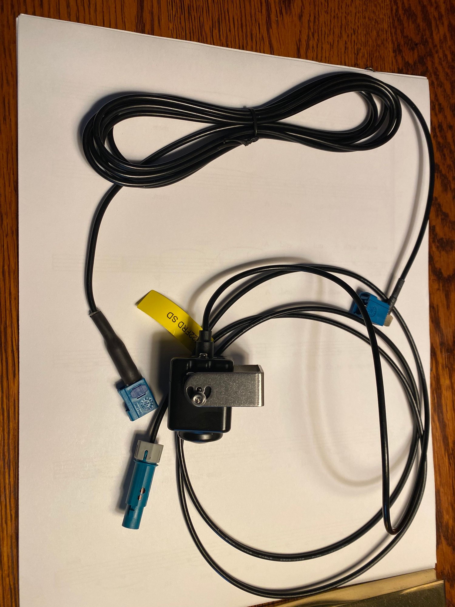

I just bought the camera_source replacement camera and cable kit for a 2017-2022 SD with 360 view and 8 inch screen
CS-FRSD360-MN-1722
plug and play mini cam kit with a stainless steel squared off "U" bracket for attaching anywhere you want.
It has a 4 foot cable built into the camera and a fakra connector for the other end. same as the factory connector.
I bought the optional 8 foot extension cable to give me more placement options. $275 plus tax and 8 foot cable.
The directions are very sparce: Place camera. plug into fakra connector.
My questions are: which way is up on the camera, or does it self adjust no matter what position it's in?
There is nothing on the bezel to indicate where is up.
Below find a pic.
The bracket will not tilt fully to face to the rear if seated directly on the rear wall of the camper.
Otherwise, it's pretty straight forward.
Lemee noh if you have ideas or info.

If there are no obvious markings, then there would probably not be any markings that we could describe that would tell you which way is up. I'd say plug it in to find out . . . or worst case install the whole thing and if it ends up upside down then you can flip it.
