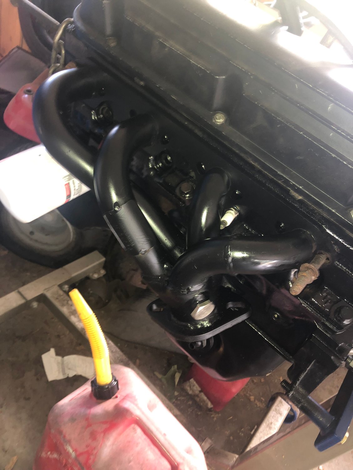

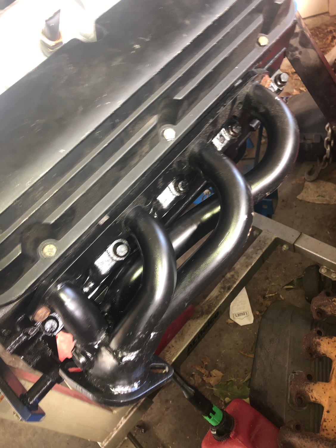

So I ordered some headers from summit. SUM-G9035 is the item number. They fit the truck perfect and work with the gt40p heads. #7 does touch but I’m gonna dent it just a bit to clear the boot. It won’t take much and for less than $200 I was happy with this result. Hope this helps someone in the future.
Driver side
Passenger side.
