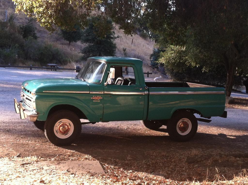

Not sure if the place Chad listed has more than that one wheel, or the price, but what you are looking for is likely going to be hard to find. By the time you got to outie hub caps very few trucks had 16" wheels and most of those where probably replaced with 15" in the last 50 years and the 16" wheels thrown out. What your after will likely look good if you can find it. This truck has 31x10.50r15's on it.

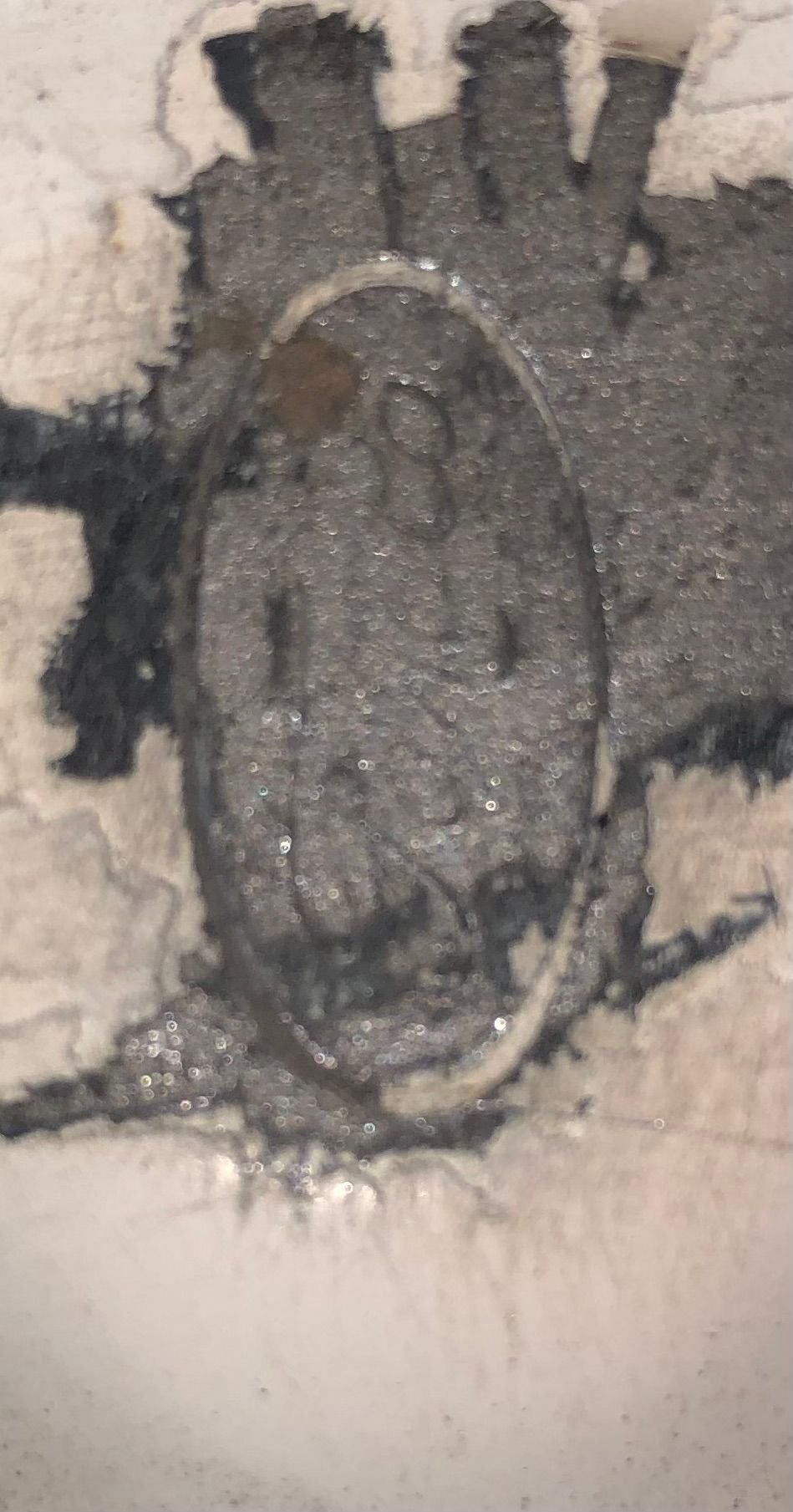

I think I have some. Mine have a thick coat of spray paint obscuring any factory markings. Where on the wheel are the numbers?

It varied a lot. Some have a FoMoCo, Ford or KH (Kelsey-Hayes) stamp on the outside visible surface.
You might also find some stampings on the back side of the wheel. Here's a Firestone 16 x 5.50 FRHP with a 9th of May 1966 date. This is the 16" 8-lug two-piece locking ring innie wheel.
Some only had a paper label in the valley of the wheel - where the tire obscures it. Here's a KH-43552 which is the 16" 8-lug one piece innie wheel. Many of these paper labels wouldn't have stood the test of time.

I found 16x5-K stamped on the "tire side" of the wheel. Probably more numbers under the thick paint.
I believe this wheel was used until '79 or so, but it's not common.

Photos of my wheel.
