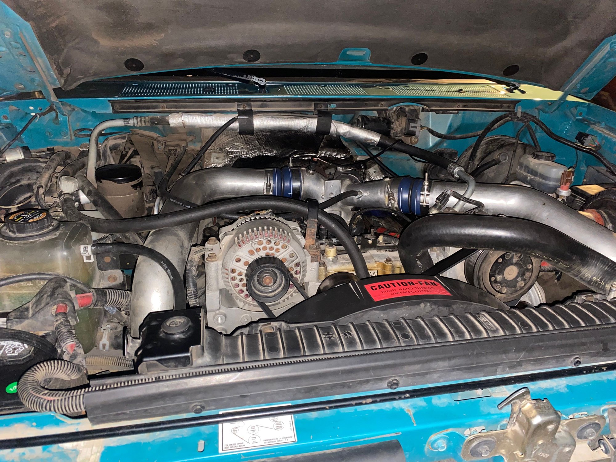

My 97 was horrible to drive empty with rosewood 200/30s, barder diy d66 kit in the turbo, and Tony wild man tunes when I first put it together years ago. It was intercooled. I unhooked my intercooler just to see what it was like and it was much worse to drive.
It is a completely different experience with jelibuilt tunes and a kc s300 style turbine wheel in the barder modded stock turbo.
With your gearing your pickup will be a great tow rig once your get your issues sorted. I don’t know how many degrees you’ll lose with an intercooler but you most definitely need one. You’ll have to decide if you want to drop the $$$ for a t4 kit or not. The general consensus is that the borg sxe turbos are worth the cost of admission. That 364.5 would be a great size for what you have done already. Where you don’t have an intercooler in yet and you need up pipes if there was ever a time to drop $3,000 on the irate kit this would be the time. Kc has fantastic drop in turbos available for us. You will save some money with the drop in, how much depending on what you do for the intake Y and pipes if you go the drop I. Turbo route. I am putting a stage 2 in my 2001 right now.
You probably have up pipe leaks if they are original. Your exhaust manifolds could be getting really tired at that mileage also.
whose tunes are you using?
Another thing you’ll want to address at some point is pressure testing your intake and using soapy water to look for boost leaks. If your intake plenums are leaking very much it will make it that much easier to replace them.
~1250 to 1300 seems to be max sustained egts for these engines from what I’ve read over the years. One thing to remember is that sustained heat over miles and miles going up a grade towing is a lot different than hitting 1500-1600 degrees for a few seconds during a full throttle pull empty. Everything inside your engine is going to be hotter when you’ve been holding at 1200 degrees for X number of minutes.

You can intercool an obs on a budget if you’re willing to source parts from a few different places. I got my intercooler+boots+pipes for $100 at a junk yard. Paid $250 for e99 intake spider, built my own mounts for the intercooler. I ended up buying steel intercooler pipes made for an obs as the ones I got from the junkyard were aluminum and needed a bit more work than I had the skills to do to modify them to work. I can’t remember now what I paid for those pipes, they were built by bar none diesel back around 2014.
