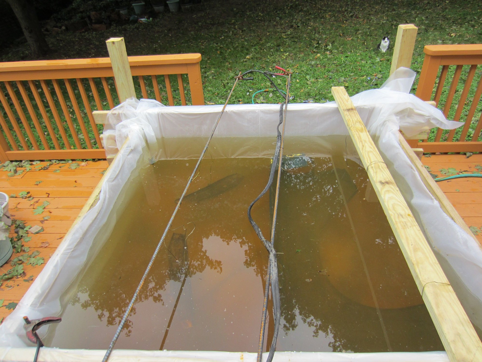

rust removal using electrolysis is line of sight so unless you can put rods in the cooling passages with out them touching the block and shorting out it will not work. I bet you were going to hang the block in a pool with the grid / rods below the block to get the rust out of the passages right?
As said line of sight so the part of the block to the grid / rods would get
rust removed using electrolysis but anywhere else it will not touch.
Now are the holes also rusted or jut the cooling passages?
If the holes are rusted also when you hone them to remove the rust it will change the size so new rings and maybe a bore and new pistons?
And yes I know how it works.

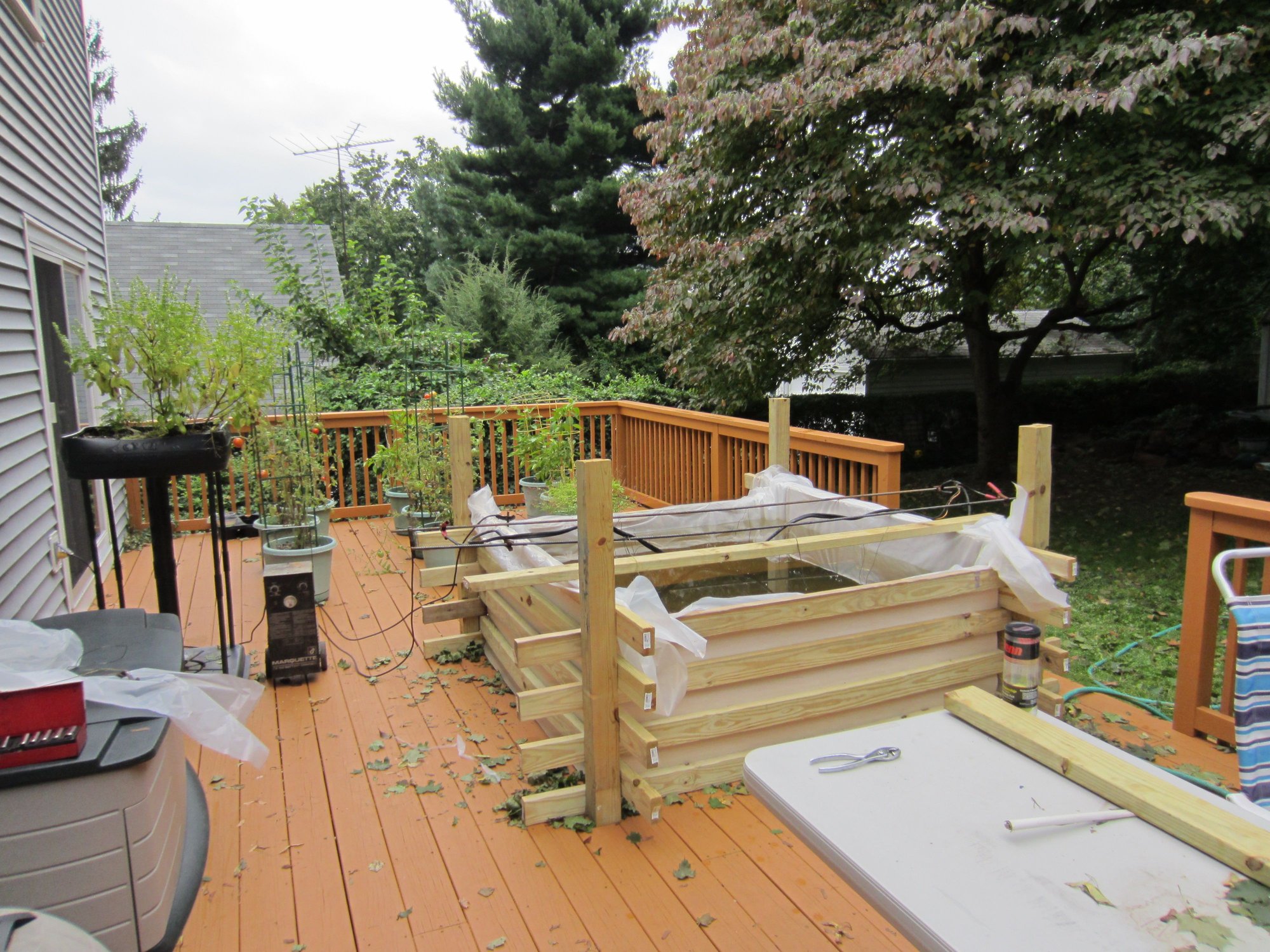

1 Fender of 3 I did and 2 bumper brackets in the pool. I also did 2 hoods skins removed from the frames to get all the rust.
The grid covers the whole bottom of the pool and you can see the battery charger lead on the re-bar in the corner.
If the piston holes are not rusted you can try this but I dont know how well it will work as I have never tried it.
Plug off all the cooling passages but 1 at the vary top then fill it with something like Evap A Rust up to the vary top and let it sit.
After a week or more drain it, save it as it can be reused, flush it out and see what it looks like.
My gut says to take it apart and take it to a machine shop and let them hot tank it or what ever they use now to clean blocks & heads.
Dave ----
