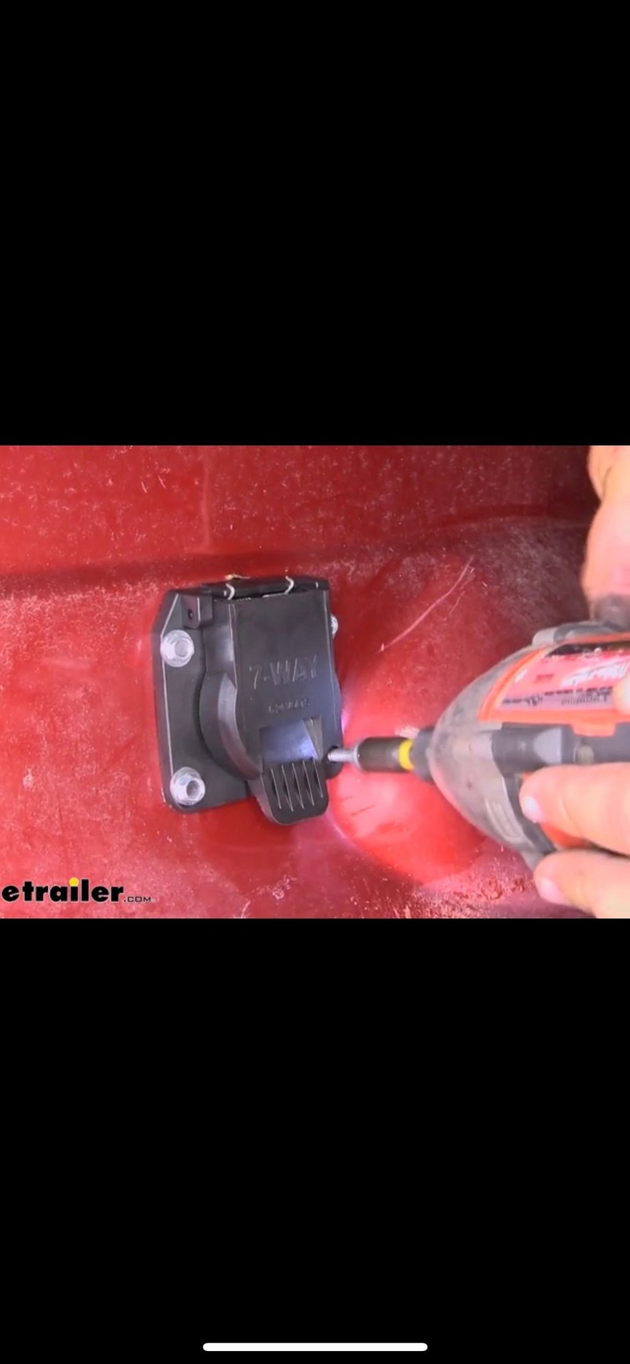

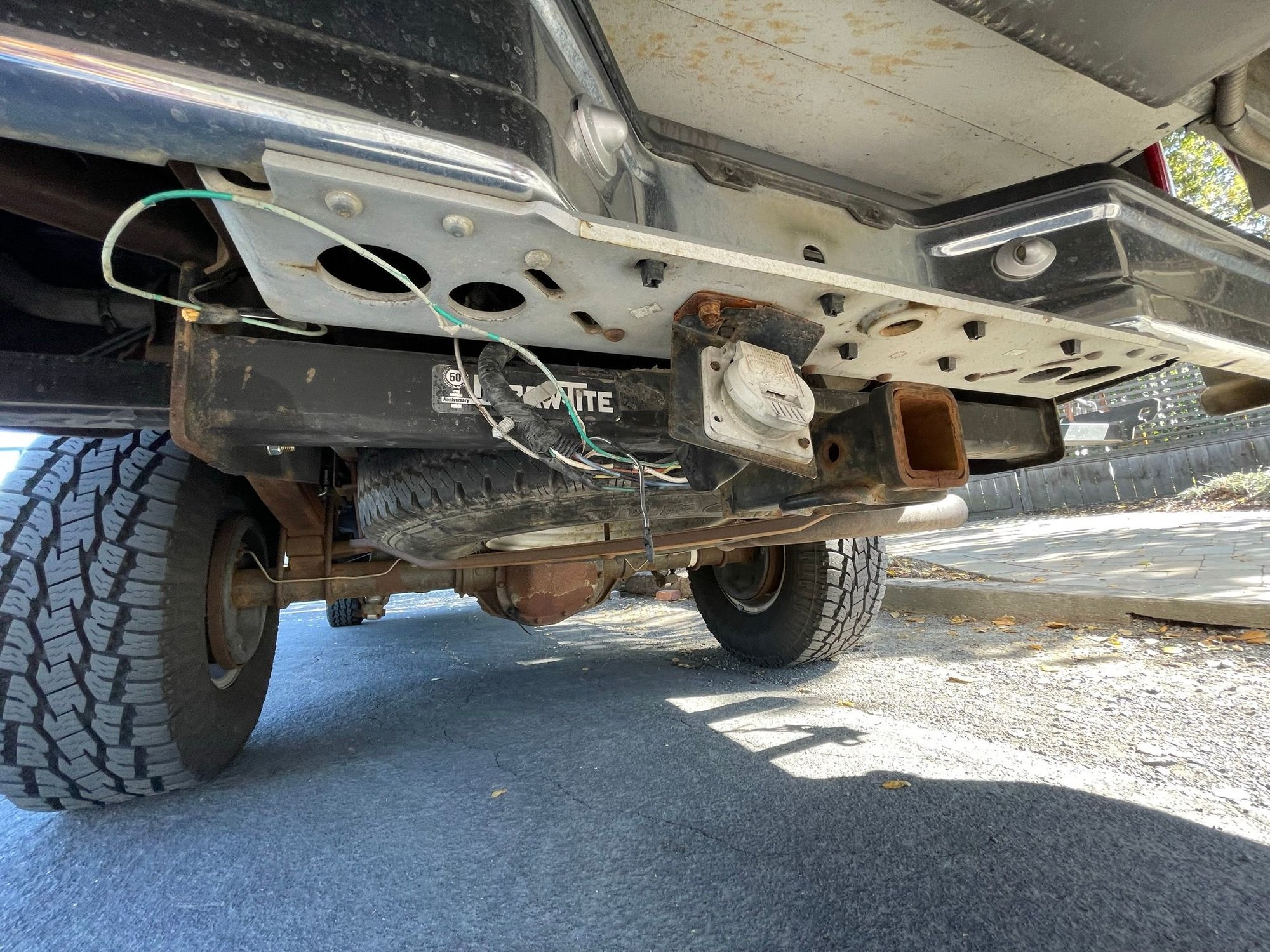

Newbie here…..I recently got a 2003 Lance 961 and I’m looking to find the best solution to upgrade my 7pin connection to the camper. I have the stock 7pin on the rear by the bumper and want to add another connection in the sidewall bed on my truck.
Also the pigtail from the Lance is a 7pin round and approx 24inches.
Should I extend the pigtail and buy a adapter from 7pin round to 7pin flat?
or
Extend the pigtail and remove the 7pin round and convert it to 7pin flat?
Then have everything 7pin flat on the truck?
I attached pics of the lance connection my stock 7pin and what I want to add to the sidewall of the bed.
TIA

If you put the bed sidewall connector in the front half of the left side of the bed, you can plug it in after you're loaded by opening the cargo door from the inside of the camper.
Just add a hook for it to hang on so it doesn't get accidentally crushed under the camper while loading.
Some folks convert the camper to the Pollak style 7-pin connector. I would recommend it as it always feels more sturdy plugging in and staying in the socket (compared to the style that you currently have), and the socket feels more sturdy after a few years of cooking out in the elements..

Your camper has the Lance OE plug. If you want to wire another female plug to match in the side of the bed with the included longer harness try this Lance female and wire harness. If you look at the camper standoff bumper thread we had some discussion about this.
You will see how I ran my wires to the bumper with the Lance female and cord and a 7 pin I wired to the end of the harness plugged into the bumper and I am still not sure about this. It has come unplugged at the Lance connectors once.
Lance wants a heavy 12V feed wire to the camper for 12v operation of the fridge is why they did their plug and long harness.
Some trucks had a connector in the OE harness along the left frame rail at the rear of the cab for a trailer hookup. I don't think they do this anymore but you might take a look under your truck, then it will be easy other than to run the 12 V to to a 12v source up under the hood.
Or switch the camper plug over to a standard trailer 7pin male. Then get a cord with a female and a male to run the the rear bumper.
Or put a 7 pin female in the front left corner of the bed as your thinking then if you ever get a 5th wheel your good to go.

Man that is a rats nest for a 7pin, good grief someone hacked that all up. Someone already posted what you need. I wanted to mention the real world weights of that 961 since I see your driving an older ford SRW, quoted from owners of that model.

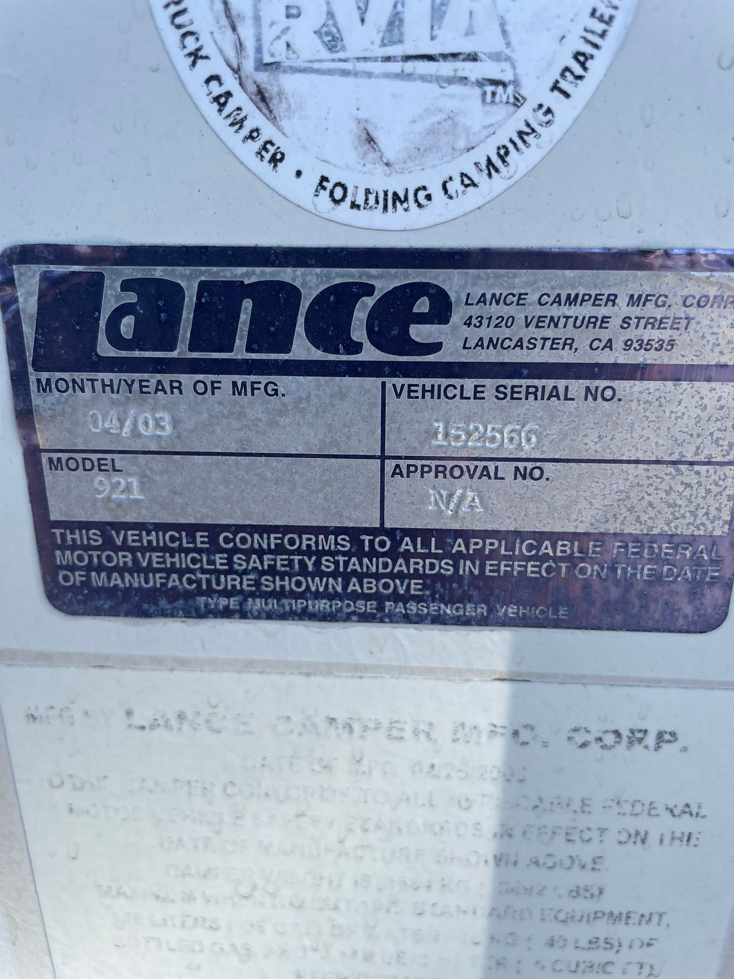

Are you sure its a 2003 961? I don't see that listed in lances brochure for that year: https://www.lancecamper.com/docs/2003-brochure.pdf
or the 2002 model year: https://www.lancecamper.com/docs/2002-brochure.pdf
I found it in 2001: https://www.lancecamper.com/docs/2001-brochure.pdf

Thanks for all the info guys. I will let you know how it looks when I get done with it.
I posted a picture of the tag on the camper.

Its a 921.
