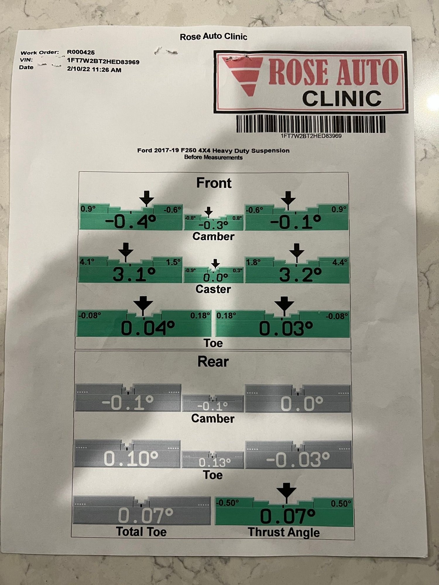

I installed a BDS Leveling kit with Fox shocks, new wheels and tires and new adjustable track bar. Since installation, the truck pulls to the right when I llet go of the steering wheel. Two different shops have confirmed the truck is aligned. I’ve tried moving the tires around but the problem still exists. I install a fox steering stabilizer with no change. When I hold the steering wheel center, the truck drives perfectly straight. When I let go of the steering wheel, the wheel immediately moves about a quarter turn to the right and the truck turns to the right. What can be causing this? I do notice that when I turn left there feels like more tension in the wheel. When I turn right, the wheel feels loose until about the quarter turn and then the tension feels similar to the other side. Please help.

Post your alignment printout
