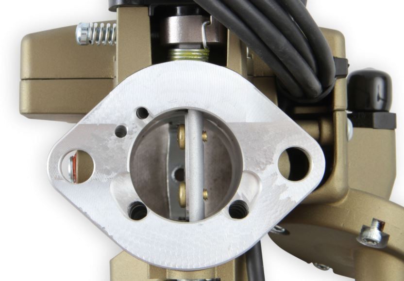

Team, I have a 1965 F100 w/a 240cid engine, (almost) all original. I'm considering replacing the single barrel carburetor with a Sniper EFI single barrel. I had several tabs break on the intake manifold a couple of years ago so I've replaced it with one that has slightly wider spacing for the carb mounting studs (I think this was true on all intakes after 1967ish). It's not a huge difference, maybe 3.0" v/s 2.75" or something like that. I was able to elongate the mounting slots on my Autolite 1100 so it fits but am not sure that I could do that on the Sniper to fit the wider stud spacing. Does anyone have experience or thoughts on this? Picture attached showing the Sniper base plate. It doesn't look like there's much room to elongate the holes. Thanks for any tips or thoughts!

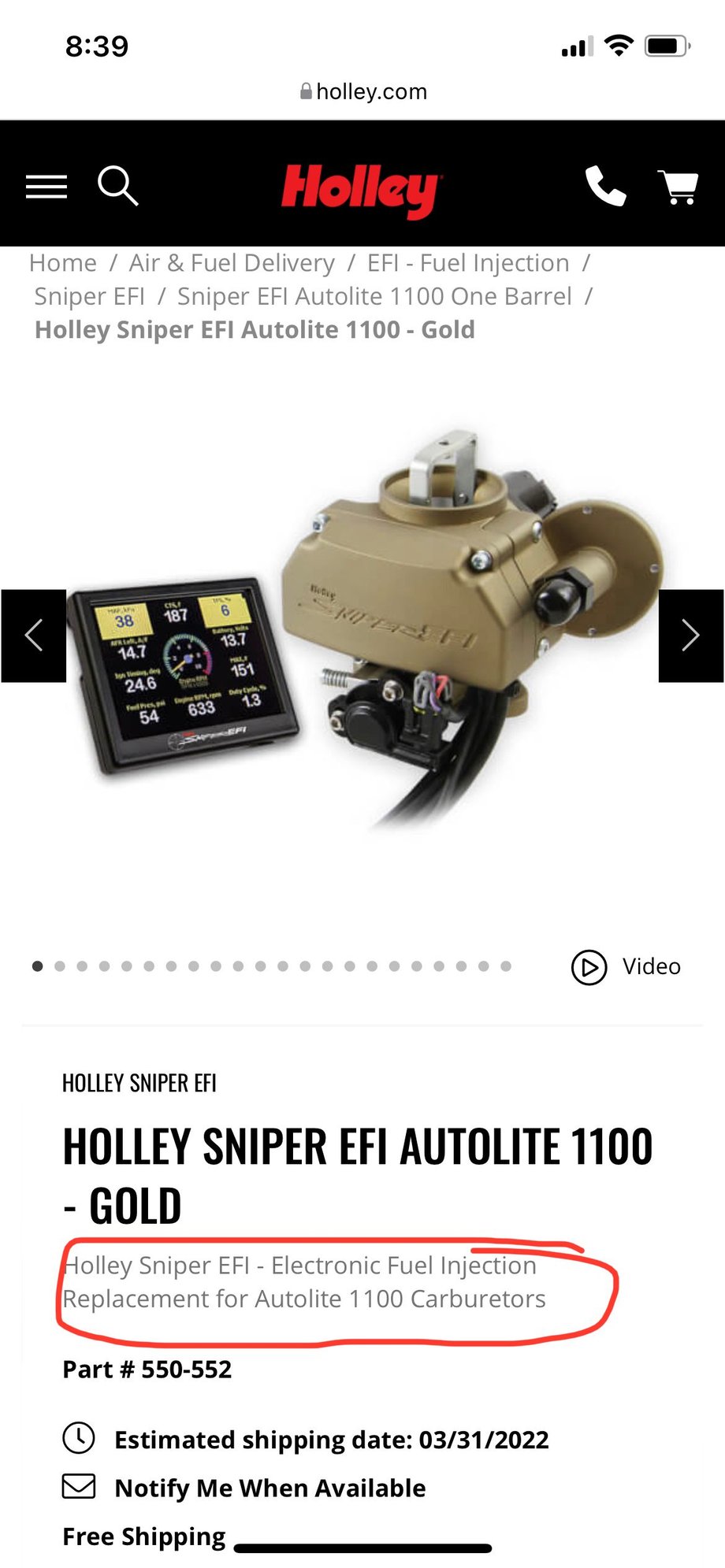

If that is just a picture then you will need to know just what the spacing is on the TB and then measure the studs.

It has the 2.75” spacing. Same as the Autolite 1100.

They only sell the one for the Autolite 1100 spacing.
It seems like it would be a VERY easy marketing thing to make one with the 3" spacing for the YFA carb and capture an entirely second market, but alas.
I've seen it posted on their Facebook group where someone had this same question and Holley simply told them "It's for a 2.75" Autolite 1100 spacing".
Meaning, if you want to modify it to fit the YFA spacing, that's on you.
I don't think it'd be too difficult. Even if you took the holes all the way out and made them slots, it's not going anywhere once you get it torqued down.

AB, you beat me to it. I finally got someone from Holley on the phone and they confirmed what you said. It comes with the more narrow hole spacing, fitting only 1963-1967. I agree - I don't think it would be a huge deal to elongate the holes. I've done it twice on carbs without issue. Thanks for confirming.

I did a quick mockup and measured where 3.00" vs. 2.75" would put the holes. You should still have some meat on the end.
Seriously though, it seems a really big oversight on Holley's end. They should have just made the baseplate a tiny bit wider and put slotted holes. Done. Now it also fits Ford 240/300 I6 engines from 1967 - 1986.
