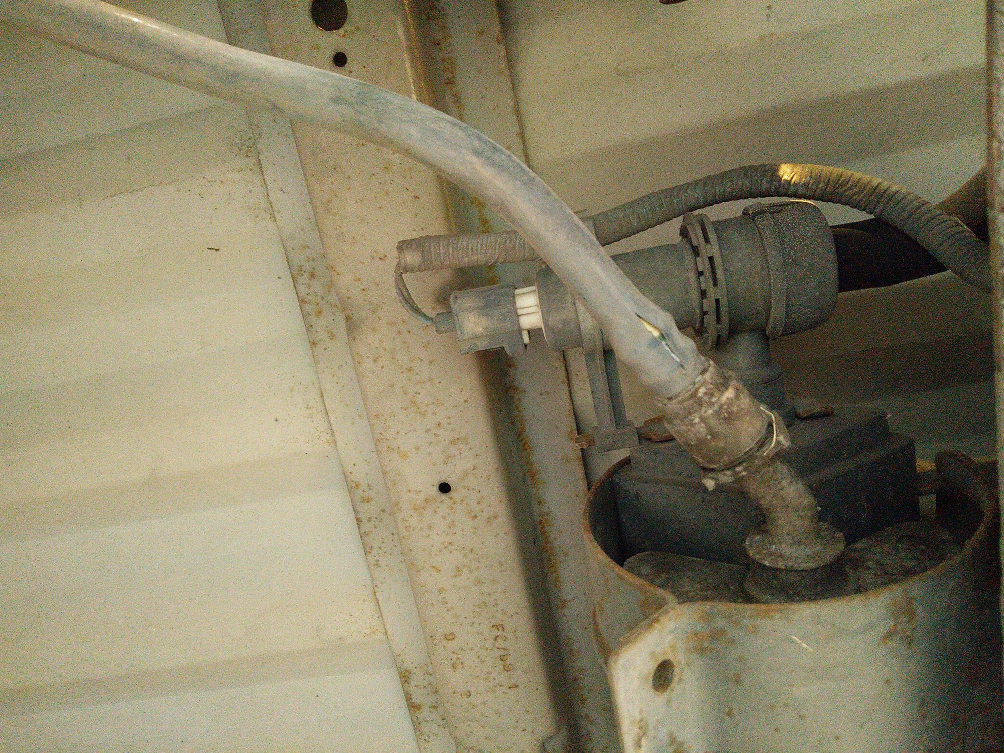

Need to change Evap Solenoid Valve. Found the Evap System on 00 Mazda Ford B2500 under the truck after removing the spare. Here is what I found so far:
Evap Valve Solenoid
Please, What is that cracked tubing piece or line? Do I need special tool to disconnect & service that tubing. Looks like I have to remove the bed to check & service the rest of this system. Thank you

Creeped under the truck switched out the Evap Valve Solenoid with WVE 2M1154 Vent Valve fairly priced my truck ran much smoother. I'm researching replacing the cracked line. Would be helpful to know what the name of cracked line? I'll update as I go along. This forum is a great source of support to those who just love their old trucks or vehicles with little to no interest in the newest tech that forces you to be dependent on titled techs who may or may not be so savey on the latest most expensive shinny plastic vehicles
