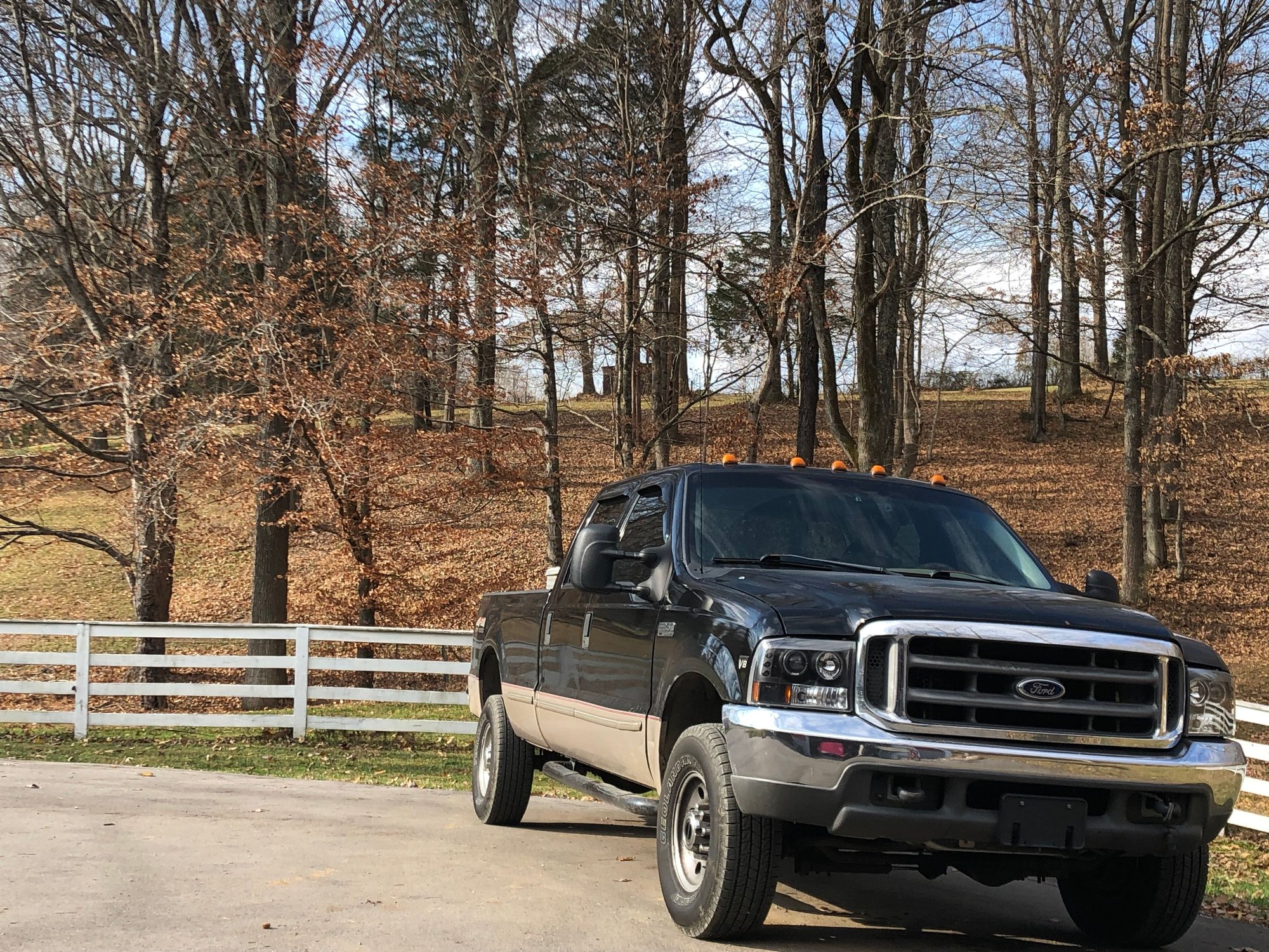

As the title suggests, I need some guidance. I tried searching but I couldn't find the information I was looking for. Here are the upgrades I was looking to do, let me know y'alls thoughts.
1999 Ford F-350 with the 7.3. 355k miles.
  • aFe Intake: aFe POWER Magnum FORCE Stage-2 Pro DRY S Cold Air Intake System from https://www.riffraffdiesel.com/afe-p...intake-system/
  • Increased exhaust from the turbo back (4 inch or 5 inch). Is there a preference or something I should look for when searching for a manufacturer? (MBRP, Borla, Diamond Eye...etc.?)
  • Tires and Wheels. I know the bolt pattern is 8x170. If I go larger, I'll lose turning radius as the tires will hit the leaf springs. I've heard that I can use a -44 offset but what would that look like?
  • I have a tan section at the bottom of the truck on the driver and passenger side but one of the body side moldings was recently torn off (No, I didn't do it). Now I have bare metal showing. Would a good option be to remove all of the side moldings and use a bed liner type paint or line-x?
  • I'd love to go with a functioning hood scoop or dual scoop setup. I saw a newer F-350 with one and it looked awesome. Wondering if y'all know where I might get one that would fit this truck
Is there anything that I need to be concerned about with the above? Also, I know if I switch to a larger tire I'm aware that will affect the speedometer. Is there any way to recalibrate the speedometer to the tire size? Would there be something else to upgrade instead of the above? Or in addition?
Thanks in advance everyone.

Great looking truck, nice color combo.
I do not have much in the way of power upgrades (see my sig) so a Walker BTM on the exhaust is fine. A 4" system sounds way better and will flow plenty for near stock. 5" is more hassle for no gain imo.
That intake is too much dinero for a bit of glam. CAI makes virtually no difference in power on these. 6637 is economical and flows well, but you can really hear the intake. The sound got old (not me!) so I eventually dropped it for the AIS. S&B dry intake is another popular option.
Hood scoops can definitely look cool, but there's no way it will help functionally.
The turning radius on a crew cab is always huge, don't worry about making it worse.
