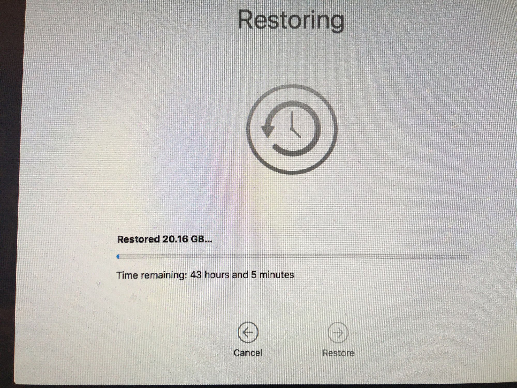

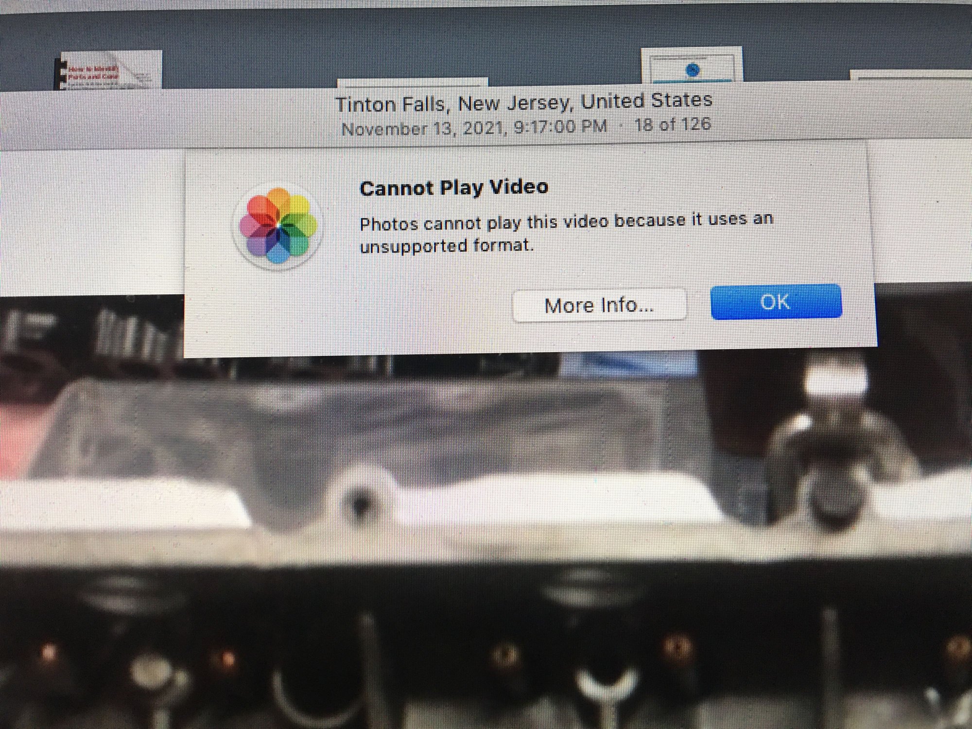

I don't post that many videos on FTE anymore. And, the engine build thing is not my thing. Plus, the engine sequence is screwed up because my one MAC got wonky, and I'm having issues getting photos, images, and iMovies going back to the beginning of November. I've got 1 TB of Powerstroke images and videos, which goes down to .6 TB once it starts fixing itself. So I lose mostly the recent stuff. Things on my other MAC, I can get.
I've found a way to get them. I can do a restore, but before opening photos or iMovie, I have to go in and manually move them out of the base directory into a remote hard drive. It takes a while.

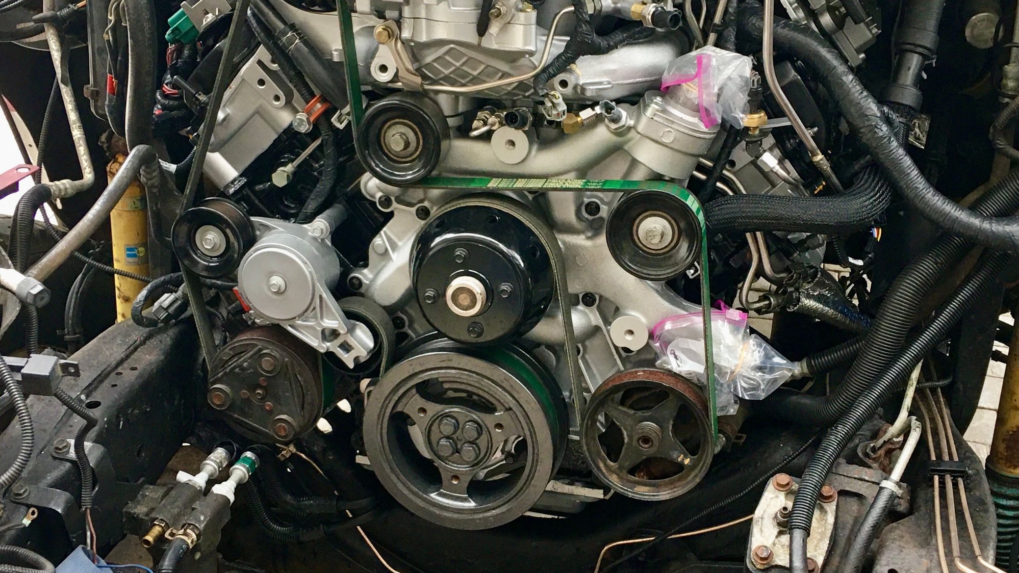

Engine.

I'm glad you got it running Jack. It's been a long time coming so.... CONGRATS!
Thanks for posting those pics, but I was thinking you should start a new thread about it. And maybe discuss the mods you did, like all that going on in front of the oil cooler.

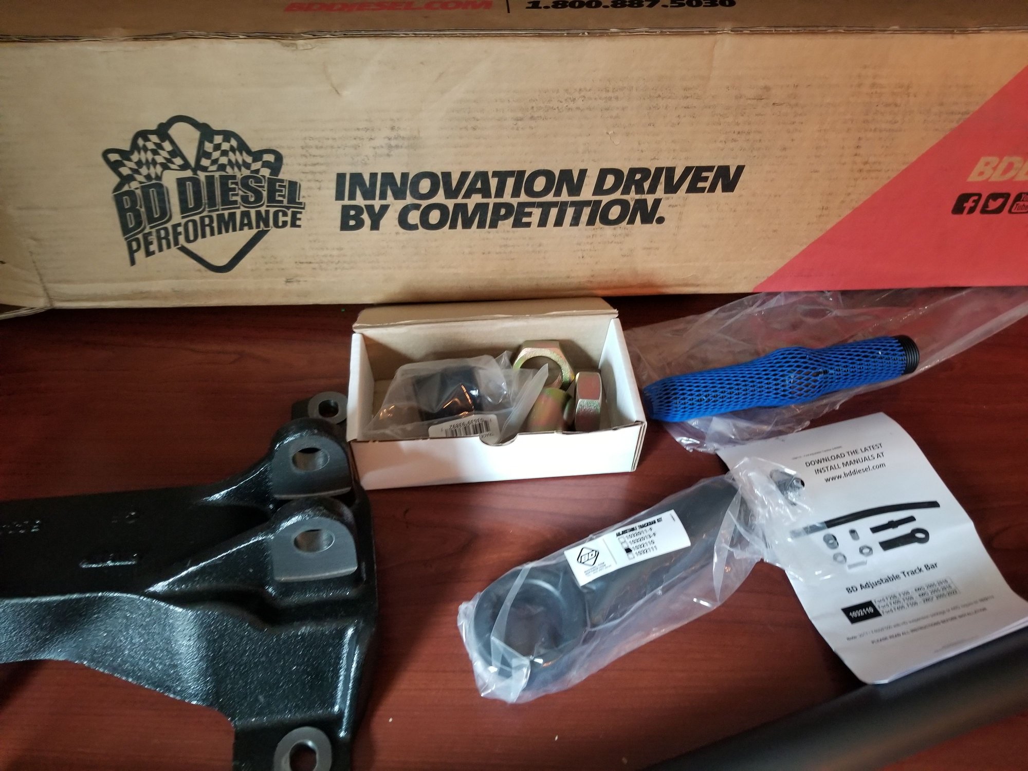

My truck has a rough country 4 inch lift kit installed by the previous owner. Cheapest lift they have. I bought the truck at the end of 2017 I believe. I'm going to install an adjustable track bar and get that rough country track bar bracket out of there. If the steering doesn't improve I'll install the drop arm.
Hopefully I won't have to mess with it.

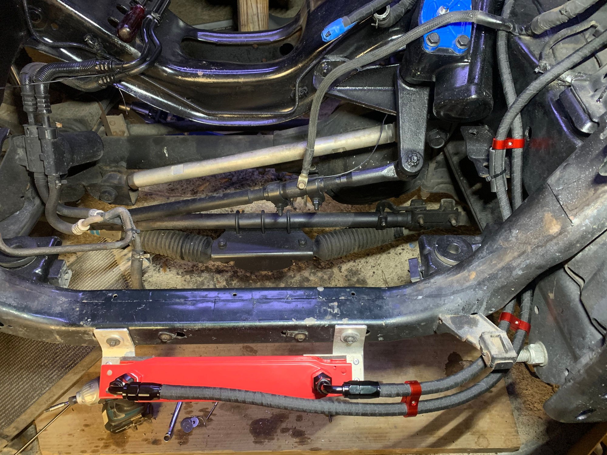

Good shot with engine out

Got the track bar on. Steering wheel is off by a little more than 45*. Just dropped it off at the shop for a alignment, rotate and balance the tires. I'll have to get out on the country roads to tell if there's any change. Couple of miles down the road at 35 mph ain't going to do it.
Any time I hit a certain dip in the road the truck would pull to one side. Really down want to pull the pitman
