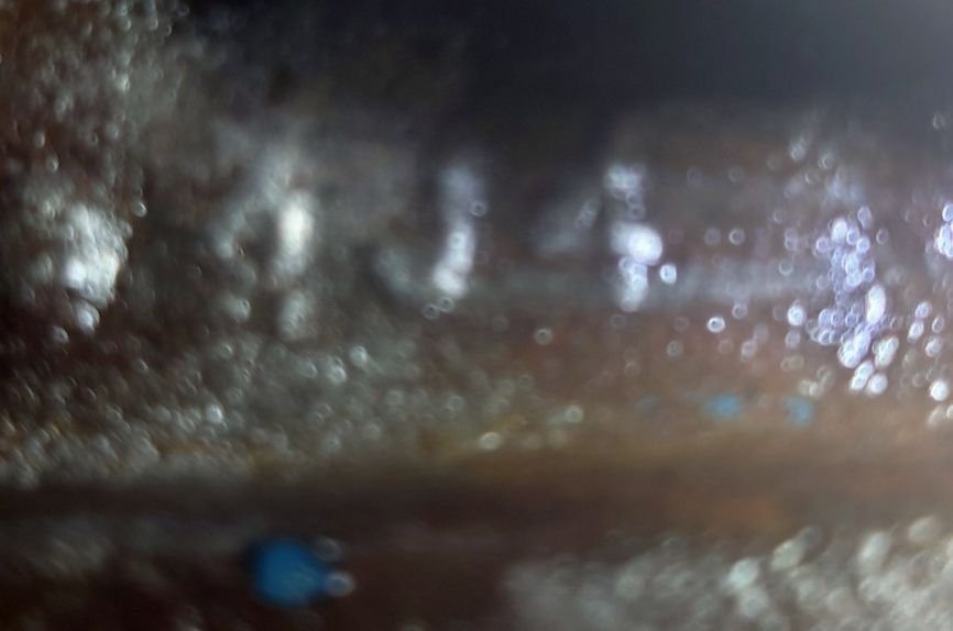

351M Cast Date Unreadable
I have 2- 351Ms I'm trying to decide on which one to start rebuilding. Both are MCC, 1 was from '78 that I know nothing about. And the other I can't read the date code on since it was rusted pretty bad. Anywhere else I can look? From my casting number starting with D7TE Here says it's a 77-82. The picture makes it look like a 9 but it's more ambiguous in person. It's definitely not a 7, so is there any reason to look further to make sure it's not in the bad dates for castings?

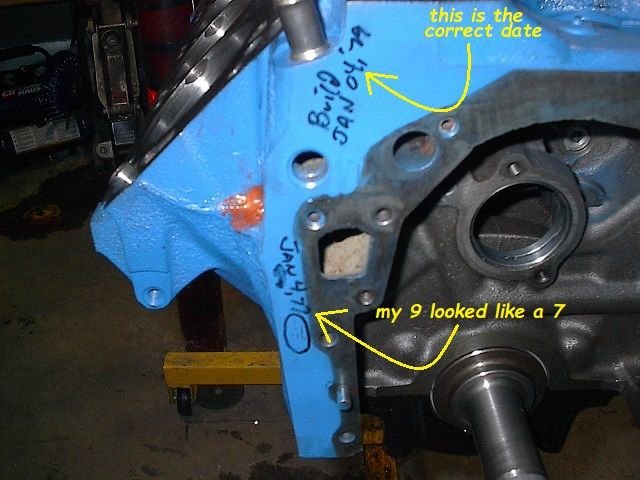

Looks to me like 6J4 which my thinking is "October 4, 1976".
J is the10th letter, 10th month is October.
I was not sure what the second picture was taken of.
Below is of my 400 from a '79 F-350 wrecker, casting code is December 20, 1978r, build date is January 4, 1979. I rewrote the build date as the 9 looked like a 7 when I wrote it first with my Sharpie, but it's a 9.
I could see that from the picture. That's a high 6 if it is, seems like the bottom of that number would be a bit higher than the others.
Could of swore it was a 3 when I was cleaning it off. But the more I cleaned it the more it changed to other numbers.
