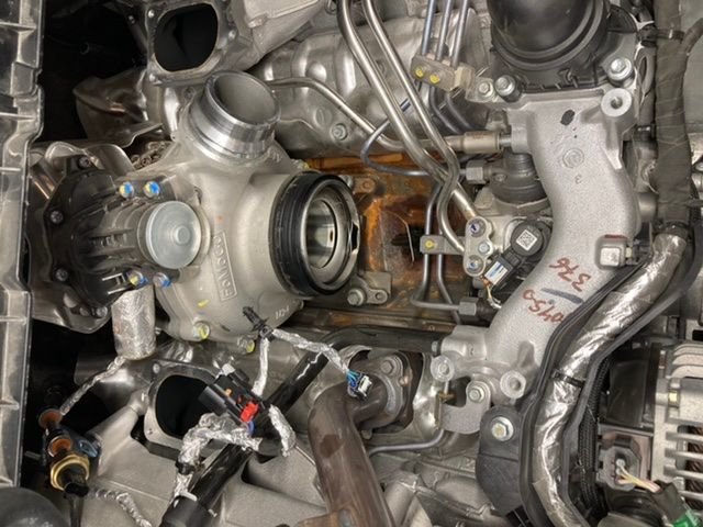

  • The toughest part of the job was the 2 rear bolts on the passenger side of the upper intake manifold. One bolt you cannot get a socket on due to the exhaust pressure sensor. Not sure if a wobble socket would work as I don't have one. Perhaps a flex head ratchet wrench would make it easier, though you still couldn't torque it.

  • To reinstall the lower intake, remove the rubber ring from the turbo that you see in my pictures and insert it in the lower intake, then the lower intake will slide right on the turbo. Tighten clamp after intakes are installed.
  • Upper and lower intakes need to be removed together and installed together.

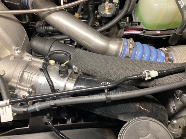

  • I may put some corrugated plastic over the spot where the fuel supply hose and return hose touch.
  • While I had it apart, I replaced the cold side pipe with one from H-S Motorsports

Pre DPK

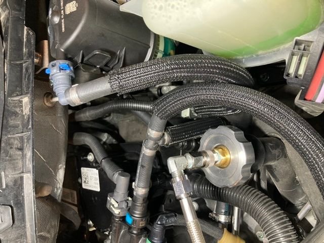

S&S DPK installed on CP4

I decided to add some protection to the hoses where potential rubbing might occur.

I finally worked my nerves up to ordering the DPK! I will install it during my next oil change, which will also be time for my first fuel filter change too, so I’ll knock it all out at once. I may have some more questions along the way… but for starters, is that just split loom you put on the hoses? If so, you remember what size?

Okay I measured the OD of the 3/8 inch ID fuel hoses with a micrometer, they all are 3/8 inch ID, the OD is approximately 16.25mm (loosely measured) which converts to 0.639 inches OD. I bet 5/8 inch (0.625") OD loom would work.
This is one of the reasons I don't care for the S&S kit. Too much potential to be damaged, or fatigue stress on the filter.
Where did you put the return filter? Thats the part of the kit I think makes it good.
